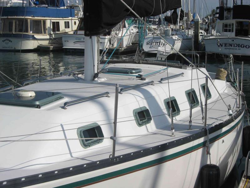

I've been vacillating about adding inside tracks to my 1980 H36 almost ever since I bought my boat 5 years ago. So I perked up reading your above sentence.
With my chainplates/shrouds located nearer the toe rail than the cabin, I've been confused about leading the jib sheets inside or outside the shrouds. Currently with toe rail sheeting, the sheet and/or the 135 clue area is only a few inches outside of the shrouds when close-hauled and sheeted firmly. Because of the shrouds and routing the sheets outside of them, it seems that I couldn't bring the clue much more towards the center line with an inside track than with toe rail sheeting? So maybe not that much improvement in pointing? And routing the sheets inside the shrouds would undesirable/inconvenient when sailing off the wind.
What am I missing / not understanding? How do you lead the sheets to your inside track on Midnight Sun? Looking at a pic or two of the Cherubini 37c side deck, the chain plates/shrouds distance from the toe rail appears not much different than with the 36. (Pic of my side deck attached for your view.)
Any insights will be appreciated. Better pointing would be a great improvement for me on SF Bay for every outing. Of course my jib and Genoa are well past their aerodynamic prime ... but that's another topic. My Hunter Cherubini 36 draws 4' 11".

The jib sheets run outside the shrouds. You couldn't run them inside under any condition because the spreaders would be in the way. You are olny pulling the trailing edge (leech) and clew of the sail inboard. Hard on the wind my genoas are still a couple of inches off the spreader tips, and mu spreader tips are three inches longer than original to accomodate the rod rigging.

Since when I toe rail sheet my 135 and the sail comes close to the shrouds (and also my sail is just off the spreaders as well), then the benefit of the inside track must be improved overall sail shape -- better better pointing rather than brute force sheeting tight from the toe rail.
So do you think I should make the mod? -- Non racer but very frequent boat user who enjoys tweaking for improvement.
