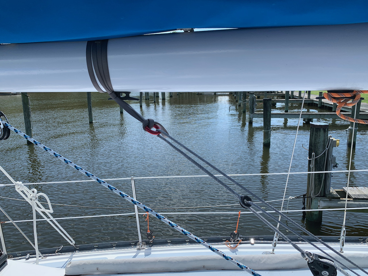

So last summer I "built" a soft boom vang for our '82 H36. I attached it to the boom temporarily with a strap to test functionality. Seems to work rather well, so I am now contemplating a more permanent attachment point. Rig Rite sells an internal boom bail for the Kenyon 3756 Boom...last year it was $79 and I thought that was pricey, now it's $140. So my cheap side is kicking in and am wondering if a standard boom bail (externally mounted similar to what is used for the main sheets) would be just as effective, strong, etc. Rig Rite wants $120 for those, but Defender has a similar sized version for about $43 - which seems rather reasonable. (Ronstan RF1048 - should fit this particular boom size). I realize the main sheet is attached to the boom using these external bails but there are three of them, so I presume that spreads the load accordingly. Any opinions on if a single external bail would be prudent for a boom vang? It's location is much closer to the mast, so the forces I think would be the much higher...but I'm no mechanical engineer. Thoughts?

Well, if you were to shift gears and go with a solid vang, I'd suggest that you contact Garhauer. Their vang kit comes with plates formed specifically for your mast and boom. Probably $450-$550. Nothing like a solid vang...

Thanks sailme88 - I think I'll stick with this setup for now, but I appreciate the Garhauer hint - I didn't think to check their site (and I have a lot of Garhuer gear...) - their similarly sized boom bail is only $18 - super bargain! But I'll also check out their other attachment options.

I used a bail like the Ronstan one pictured for a four-part vang on my H37C. Worked fine. I have a solid vang on my current boat. I like it better.

True, but you can still shape the main with a combination of a traditional purchase vang and the topping lift. I just find a solid vang more convenient. For one thing, it allows me to remove the topping lift while sailing so that I don't worry about adjusting it underway and there's no scramble to put it back on before lowering the main. But there are also times sailing off the wind when its great to have a traditional purchase vang that you can clip on the lee toe rail as a sort of vang/preventer.

Copy all - thanks, interesting information. I think I'l try it with the Garhauer Bale and see how it works out. Perhaps once my other projects are done and I really like the vang, I'll upgrade to a solid version. I presume I could remove my topic lift altogether if that were the case, correct? It's a fixed length so not much help once the sail is hoisted...

FYI - I’ve answered the question about vang location before - the short answer is to make it a 45-degree angle between boom, at its usual sailing elevation, and mast. That’s the only mechanically correct place for it.
I’ve also commented about the detriments to rigid vangs as well - the short answer is that they’re not for sailing better; they’re for convenience; and, if your mainsheet is less than 75% of the boom length from the mast, it’s probably not even necessary. An adjustable topping lift is the best answer for versatility and convenience.

Thank you for the reply. Yes, went to Rigrite because they are the only people that carry the stock spar parts, and as you reiterated, they are overpriced. I also went to other vendors before Garhauer, including Schaefer (who does not seem to offer a boom bail of the appropriate size) and Ronstan, etc. To be honest I was never impressed with the build quality of the Schaffer gear that is stock on this boat. I replaced a good bit of that with Garhauer products (many blocks, the traveler, etc) and have been pleased. A boom bale is a very simple item. Garhauer’s price seems very reasonable For what these are. So with the part in hand I’ll try it out. It is Slightly undersized compared to the Kenyon bales that are already on the boom, but at 1/5 the price I am sure they are not 1/5 the quality. However, thank you for the Dwyer recommendation, it it would seem they too don’t appear to offer boom products that match the size of a Kenyon 3756 spar. Bargains on EBay are few and far between in my experience of late; I’ve been burned a few times and frankly it would need to be a last resort thing for me. And for what it’s worth, I’ve been known as an over thinker in all things since 1970! The devil is in the details.
