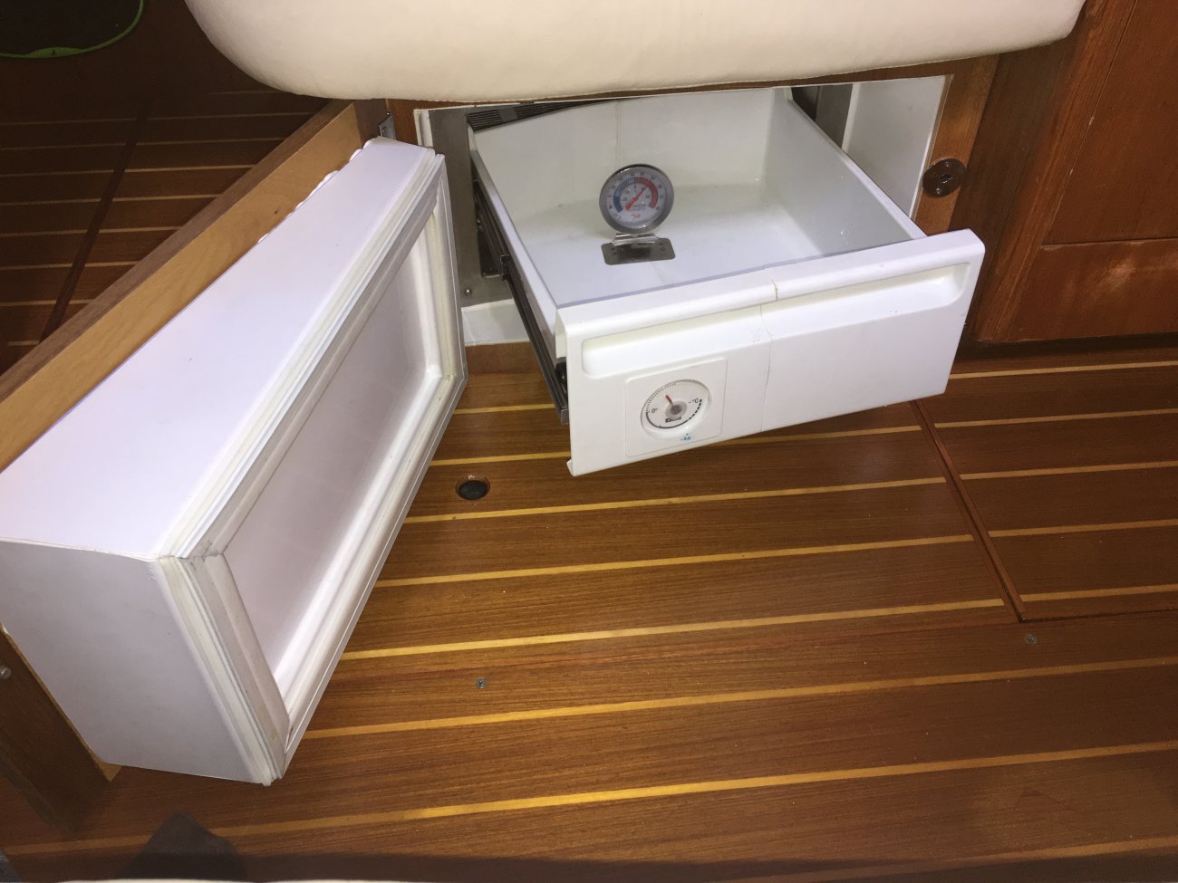

Our boat is a bilge keel and stays in the water through the winter, the "dish" has been increasing in size since we have had it. I believe it is responsible for transmitting a lot of engine/prop' noise into the heads as it works as a speaker cone.
I am not sure that the poor weight distribution is a real factor, just a very large unsupported flat-ish hull area. But you are right, there is too much storage volume on that side of the boat, ours lists to port. The area you refer to under the settee is currently occupied with the fridge compressor, but as you say would be the ideal place for my 3 batteries. I have installed a Freezer under the settee in front of the galley sink, so I can't move the fridge compressor there.
