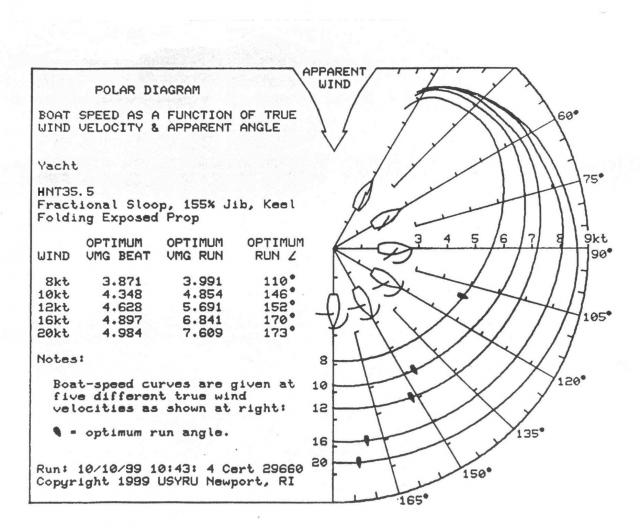

Polars
Paul
Sailing gybe angles down wind is almost always faster than DDW. DDW only works well when it's blowing like stink. I've included a copy of the polars for the 35.5 which gives the optimum gybe angles to sail for best VMG. You will note the lighter the wind the smaller the apparent wind angle (or the closer to the wind). For example, in 8kts of true breeze the best gybe angle would be 110 degrees apparent with a VMG of 3.991 kts.
I've hit over 15 kts while surfing off waves with my 3/4 oz running spinnaker. Coming off the wave and seeing the speed drop off to 10 or so feels so slow and you can't wait to get up on the next one and fly again, it's a real rush!
