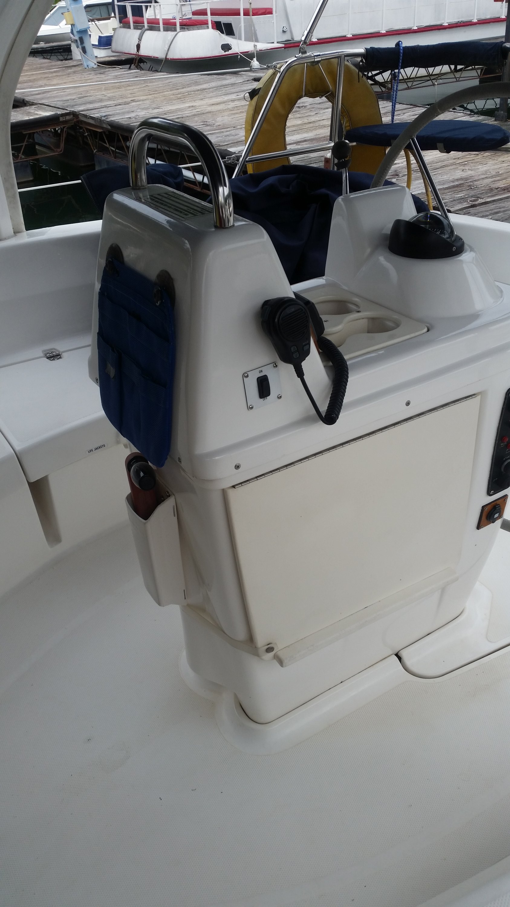

Our helm grab bar is not original, the PO installed it and we have our chartplotter on it and it sticks up more than a foot out of the helm. It has a third tube from the top down to the front for extra support. I've got a couple big crew that use it to help stand up and it's solid. There's photos on my profile.

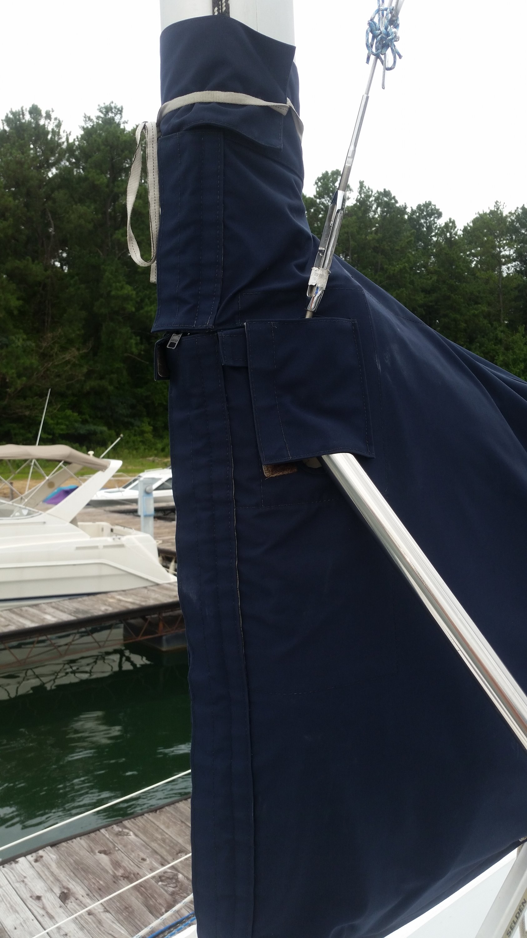

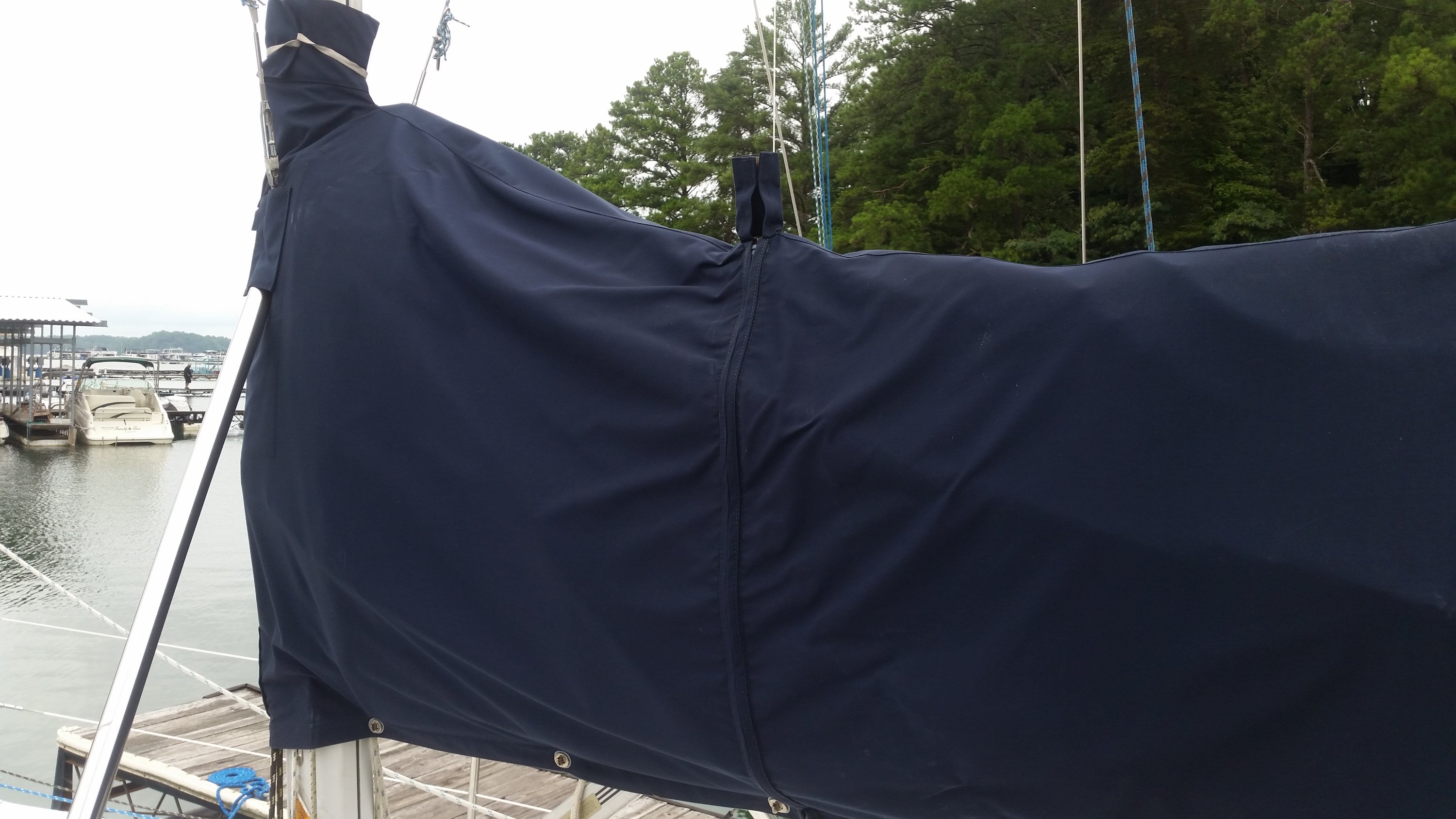

Stephany, our 1999 H340 has Dutchman lines instead of lazy Jacks but this may give you some ideas. I had a canvas maker do this cover a few years ago with some special features:
  • cutout and closure around the Dutchman lines to minimze rain washing dirt inside and onto the sail
  • cutout and closures around the top of the mast struts.
We have summer problems with mud daubers so I was interested in a tightly closed cover. The front of the mast has two zippers above and below the strut attachments. The closures under the boom are the quarter turn type clips.

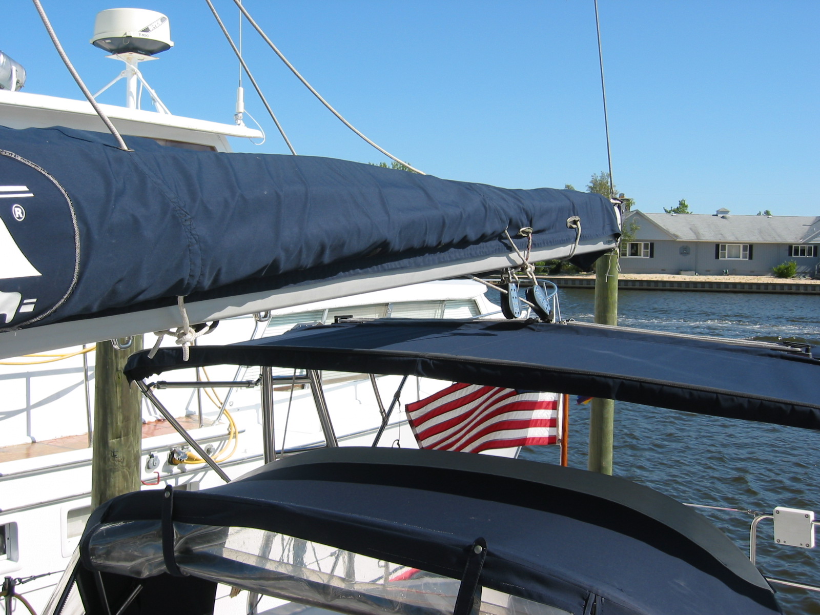

The factory sail cover on my 2000 H340 incorporates holes for the lazy jack lines so that the cover does not fall when the cover is open and the sail raised. The lazy jack lines go through grommets on the top of the cover cover, then through some SS rings inside the cover and back out of the bottom of the cover where they are secured to the mast (see photo). The cover also has long PVC tubes inside of sewn compartments (also held in place by the lazy jack lines) that run the length of the boom - they also keeping the cover from hanging down. The long reef lines stay inside of the cover and mostly out of the way. My Velcro straps are shot so the forward end of my sail cover is mostly open.
