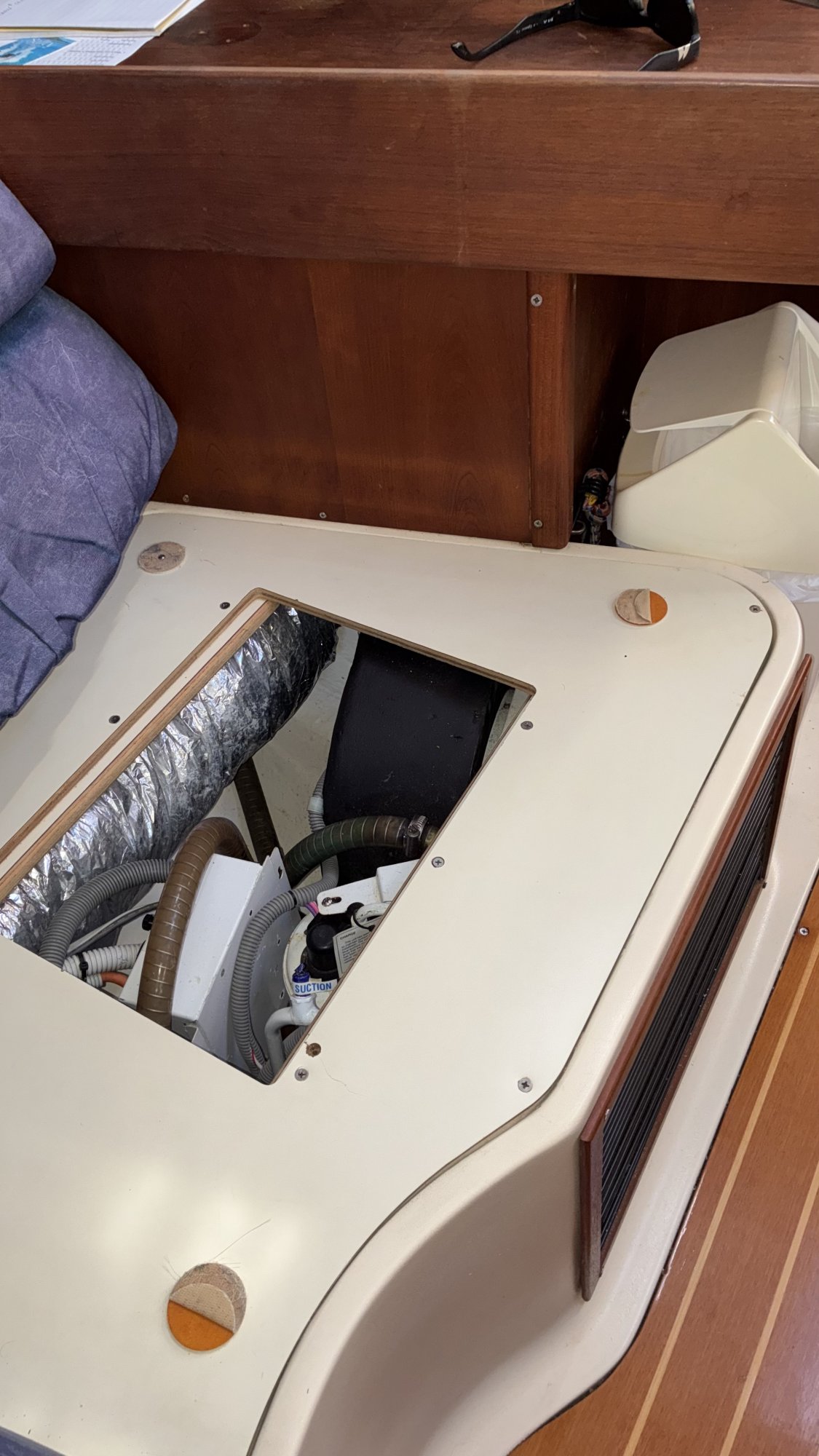

So my recently acquired 1999 H340 has an original factory installed AC unit (I think these were an optional extra).
Although I'm sure I may love it on hot sweaty nights, (North Queensland - OZ) I can't help noticing how 'in your face' the whole system is.
The AC unit itself takes up a huge amount of under berth storage space on the stb side, and this appears to extend to an under bench timber 'box' that prevents me sitting at the nav station (nowhere for my stumpy little legs to swing).

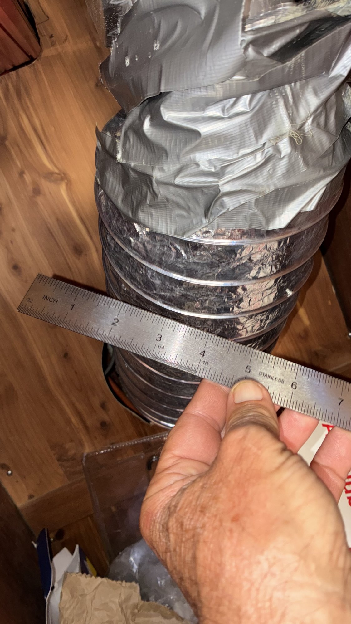

There's what appears to be unnecessarily large 5-6" ducting snaking through almost every cupboard and locker throughout the boat. And to power it offshore, the prev owner has jammed a large portable diesel generator in the STB aft transom locker... filling it completely.
So folks... my questions are as follows:
1. Has anyone 'moved' the AC unit to a more suitable/compact space.
2. Does the ducting throughout the boat need to be such a large diameter?
3. Is there a potential operational and/or efficiency problem with any or all of the above?
4. Has anyone ripped the whole system out, sold it... and just 'sweated it out'?
Any other tips and experiences would be most welcome.
Absolutely LOVE the boat, not so sure about the AC system.

We don't own your model boat, so I can't answer the boat-specific stuff. However, the general question on duct size is easy. Every A/C unit requires a certain minimum outlet area. This will be dependent on A/C size (btu) and fan speed, and should be in the installation manual. Yours may be sized correctly, or may be larger than needed because it goes to several outlets that together exceed this minimum.

Don't forget about the cooling requirements. It requires X amount of space to be able to draw air and keep from overheating.
Likes: markymac1961

We had the H336 (nearly identical to the H340) and I share your feelings about the AC installation. Before we decided to sell the boat my plan was to remove the ducting that goes aft from the unit and install a small high efficiency AC at the foot of the aft berth to cool the aft berth and head. Then convert to LiFePO4 batteries and a high output alternator for use off grid.
Moving a unit usually does not affect the efficiency much, although if it was moved a long way away from where you want the coolest air, it might have some efficiency decrease for that spot.
There are newer A/C units that are more compact than older ones. There are also variable speed units that are more efficient than older ones.
Mark
Great answer mate makes absolute sense. I might get the Marine AC guys down for a look and see what they suggest. All the best cheers.
Yes mate that what I was thinking too. I know nuffink about how these systems work... except magically turning hot in to cold. I think I'll get the Pros in and see what they suggest. All the best - Mark Mac
