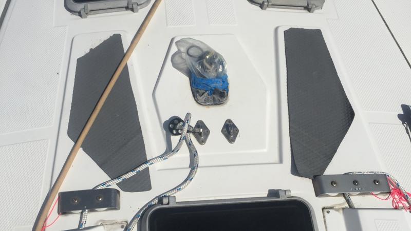

The traction pads on my h34 are peeling up and/or tearing away. I got some pads for paddle boards that would work if cut to size, but now I'm concerned they're too thick and might chafe the lines. Has anyone ever replaced these? If so, what did you use?

I replaced the pads with the same material, bought at West Marine, measure the pads, there are several sizes, and colors available. To remove them I used a heat gun and putty knife, cleaned the remaining residue with a solvent, I also replaced the small piece at the ancor, and the 2 pads in the cabin.

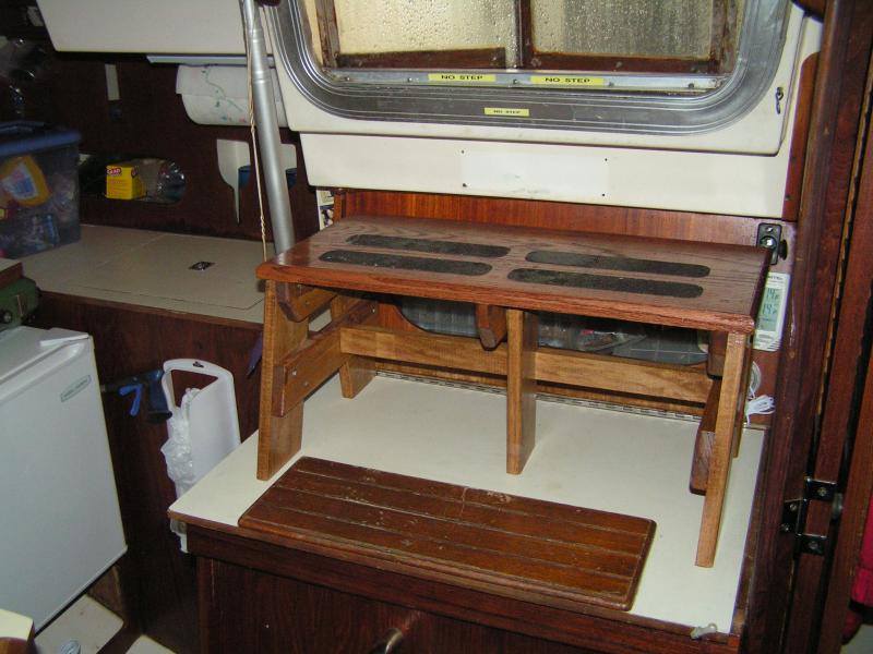

3M makes...
a stick-on sand papery tread cover that would work on these areas once you get the old stuff up. I used it on my engine cover step (ala Claude A design). See pix...

I searched everywhere for these but "cabin flooring" got by me. Thanks very much!
