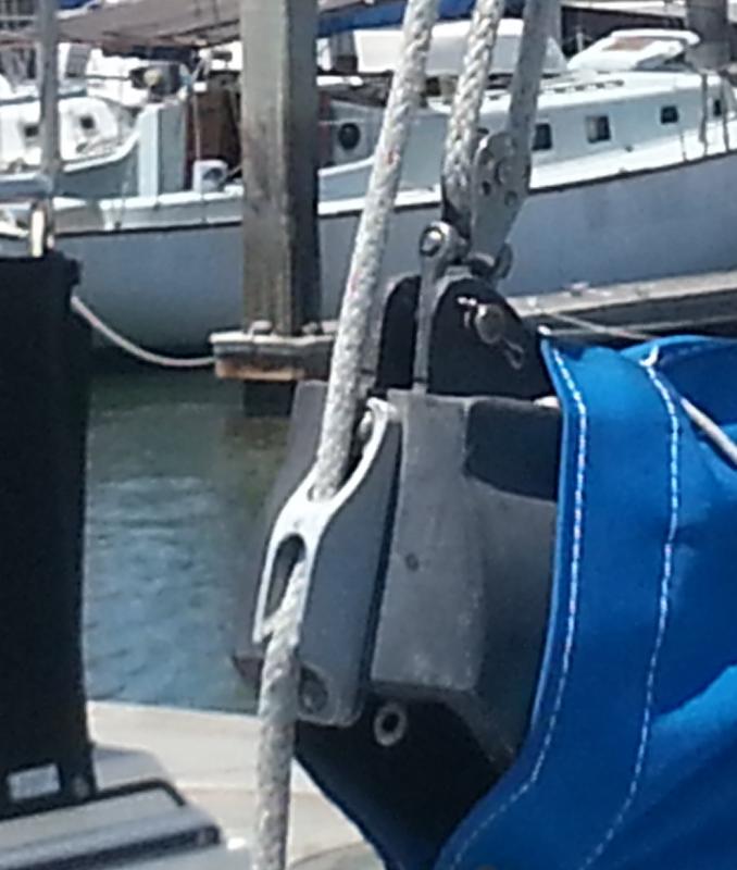

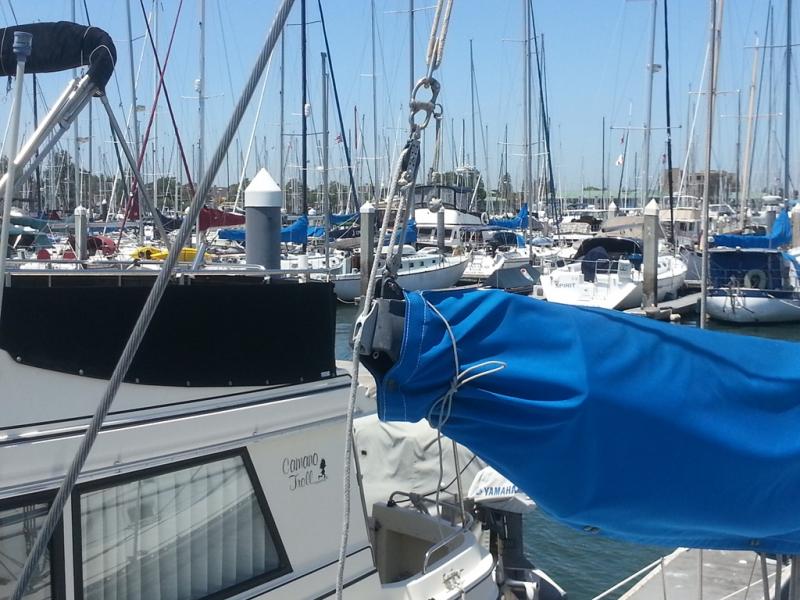

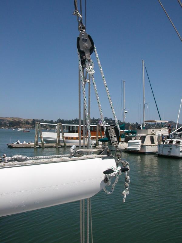

And, one more. I took these shots yesterday.
Since I use my topping lift quite a bit, I came up with the solution in the pictures. The topping lift I have is for a Dutchman system, but I used it before when I just had a fixed wire from the masthead to about 1 1/2 feet above the boom. There is a block with a becket that gives me a 3:1 purchase. Then I screwed an aluminum clam cleat to the back end of the boom. The cleat was longer than that end cap as you can see, so I drilled and tapped the upper hole then used a U shaped strap probably from another block to act as a clamp for the bottom mount of the cleat. That strap was tapped, so the lower screw threads right into it.
It works well as it self cleats in whatever position I release or pull the topping lift line to. For extra security you could tie an overhand knot in the line a little below the lowest expected height you want the boom so it can't fall on your head. My line is extra long because I thought I might go to a 4:1 purchase, but haven't needed to.

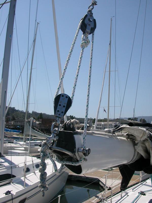

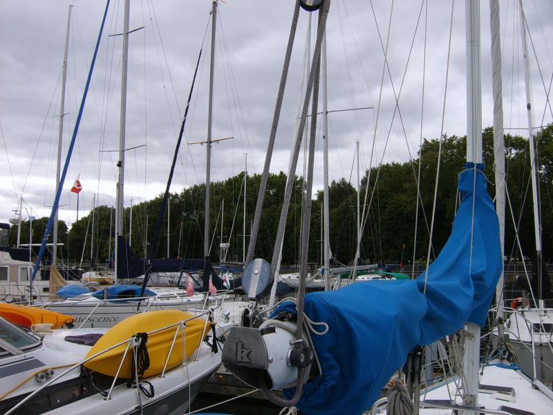

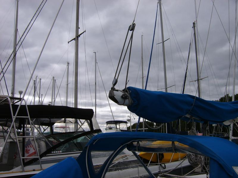

Allan:
I like your creative use of your jam cleat choice. I will give thought if I can adapt to my arrangment. Seems better than the cam cleat I have adopted.
My pics are below. After I have hoisted my sail, I like to completely remove the topping lift from the boom end which my arrangement allows. Then no need to constantly adjust the amount of slack nor does the roach of my main sail get worn as it rubs against the topping lift. At the end of my outing, I re-attach the snap shackle to the bail at the end of the boom. (The bail affords a big target so I usually don't miss!) Then put the tail-end through the cam cleat. For security, the line is then wrapped around the standard cleat. Like your block and tackle, just a pull down on the line raises the boom withut much effort.
