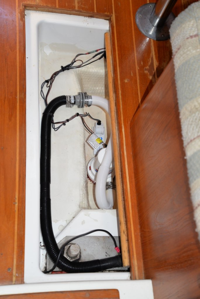

Hunter 34 Punta Gorda
LO.... Here is a picture of my bilge pump. The 3 wires are Ground, 12v from the panel circuit breaker for manual operations and a constant 12v feed that remains on regardless of the panel's main breaker for automatic operations.... -Jon

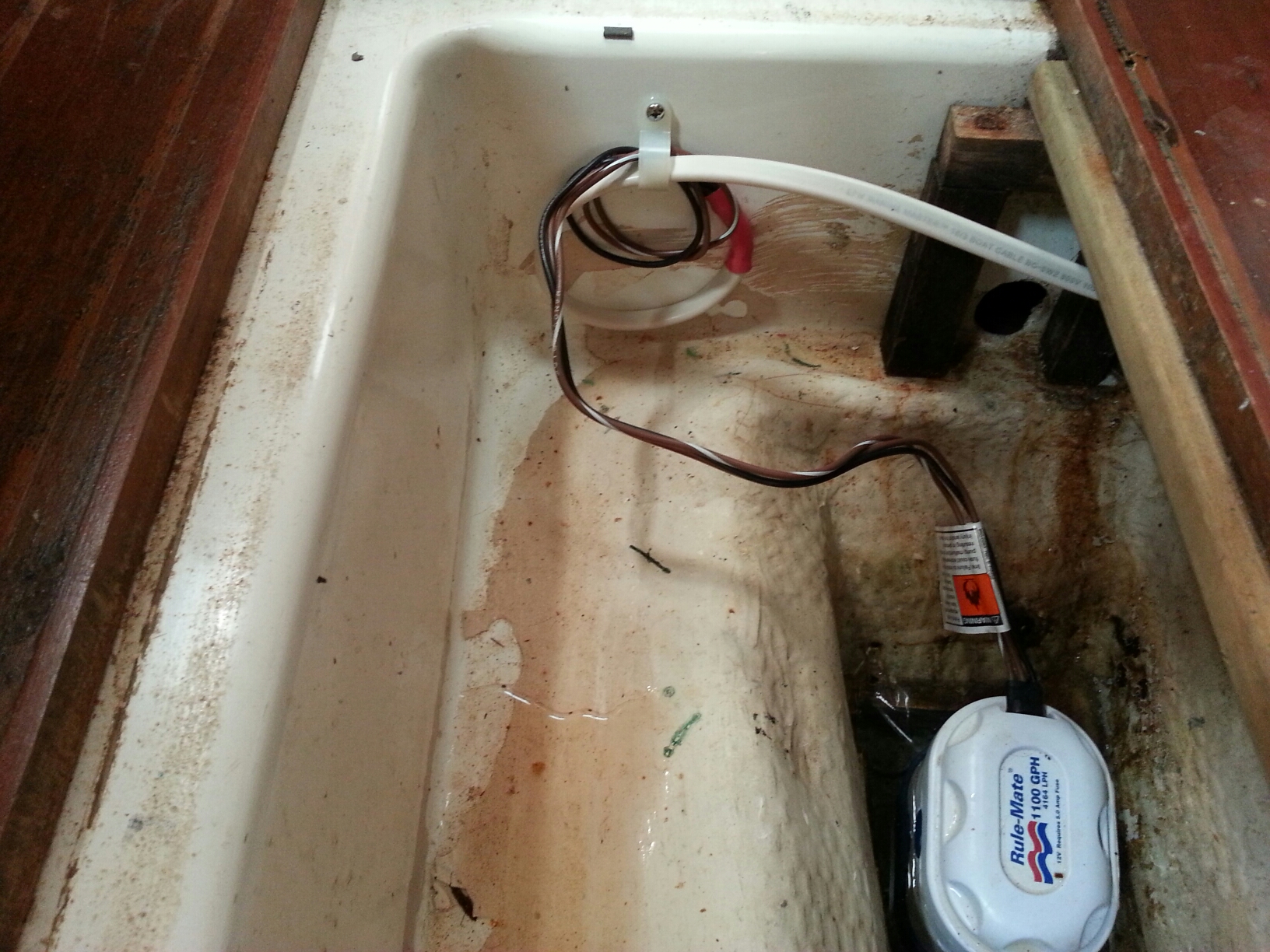

Here's my setup; pump and float switch commonly available, wiring as per Jon, all wire connections waterproof connectors.
