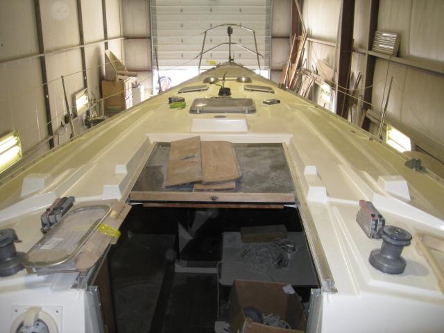

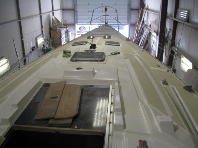

Ian, I did mine about 9 years back and it was easier than I envisioned. The traveller came off easily and then the hood was held down by butyl .. some patient upward force and a blade allowed it to come up.. Be careful not to break the long "runners" that are on each side of the companionway.. Good Luck ! I'd like to see the pictures of yours .. since I am going to have to do mine again this year. This time, I will install a new plexi slider and wood stops for it

Hey, chuck.. That is the big cover over the sliding companionway plexi.. The piece that includes the two tunnels for the lines to run back to the cockpit in.. The slider pocket on the 34 is notorous for not having a rainwater drain and any rainwater that lands on the plexi slider goes into the pocket and then runs down inside the cabin because it can't drain up hill ! Hunter didn't think that one thru very well ! I drilled a couple of holes in mine between the pocket and the rope tunnels and that helped but didn't cure it.. The 31 doesn't have that same uphill drain problem..
