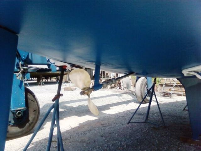

Cruising along this weekend I started to wonder why I go so slow under engine power.
My H34 makes about 7.25kts max hull speed, but the best I ever get out of the engine is 5kts (with the occasional 5.5, but 4.5 is more common). Moreover, this is at about 2800rpm. The engine (a Yanmar 3GM(F)) is rated for continuous operation at 3400 rpm, but full throttle under load only gets me to 3000, with considerable vibration and little increase in speed.
The prop is a 3 blade that's been on the boat since we bought her 6 years ago. Aside from looking for a replacement, can anyone advise on how to increase my motoring speed? As much as I hate to run the thing, I want to get maximum distance for each hour of noise.
