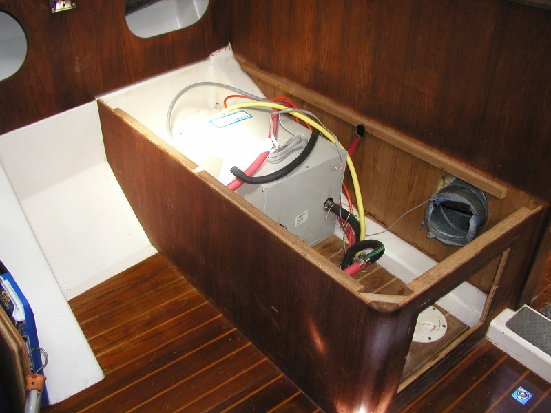

When I installed the air conditioner in the settee just forward of the sink, I was able to fish a (10ga, triplex) wire from the water heater through the floor beam and up behind the nav station to the switch panel.. The yellow cable in trhe picture.. From there, it could easily be routed through the sink island wall to a fridge unit..

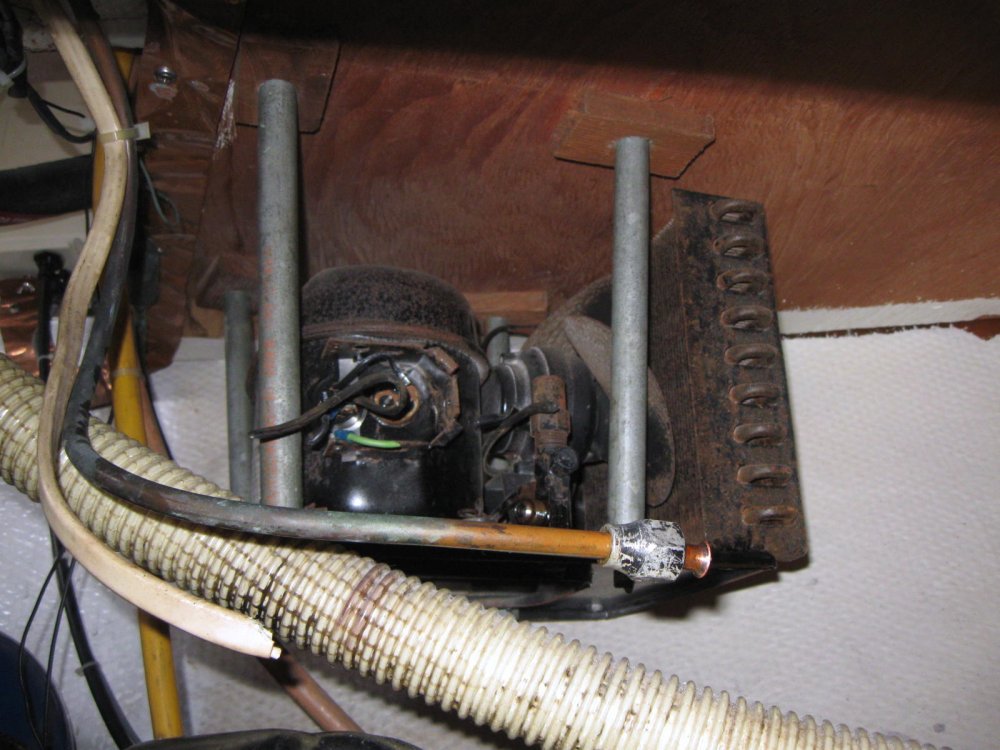

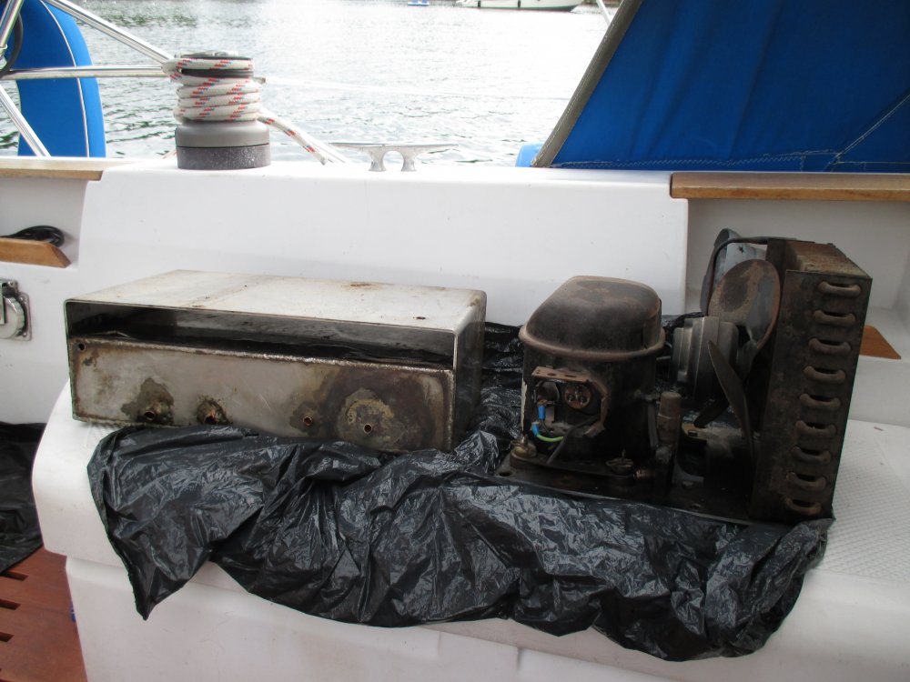

My compressor is installed in the dungeon, suspended under the aft lazarette. Pics show the old unit being taken out in 2015 to replace with NovaKool evaporator/freezer and compressor. Access to wires and pipes from stern cabin, but removal of old unit and installation of new compressor done from starboard locker. Works great, gets air all around, and keeps noise at a minimum (has to be very quiet in cabin to hear it !) . While doing this, do check your insulation and add as needed. The secret to good refrigeration is really in the insulation. My NovaKool thermostat is set at 2 (out of 7), draws barely 3 amps when running, and the evaporator/freezer keeps the meat frozen besides giving ice cubes. Of course doing it this way involves the pretzel factor going into the locker !!!
