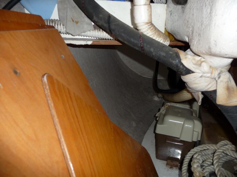

Joe, my previous owner did some long races in the boat and had installed one before I got the boat. The pump is mounted behind the side of the cockpit lower wall on the stbd side. The handle is removable and there is a rubber boot to seal the slot in that wall that is required for operation. The pump is a diaphragm model Whale Gusher.. The discharge is out the upper starboard transom. You can't see the pump in the attached picture, but that white hose at the top of the picture is the intake hose, running down to a strainer fitting in the bilge That picture is in the pit looking aft. I really don't have a good picture of that installation.. May get a chance to get one after Christmas..
