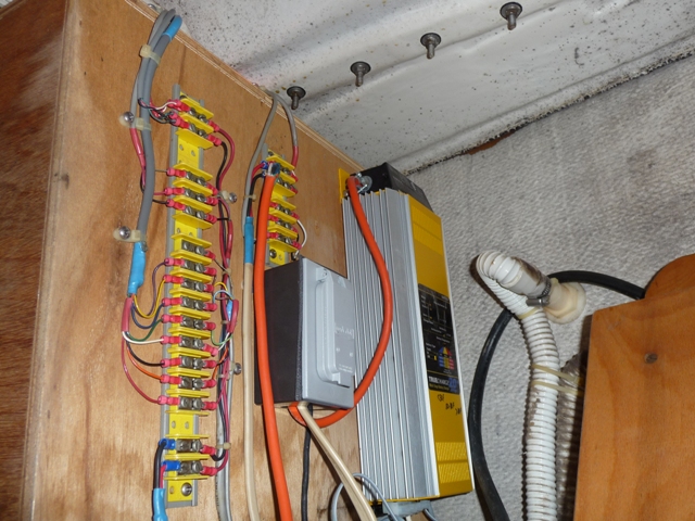

Here is a shot of the factory location of the thru-hull for the bilge pump in my '85. That bulkhead where the charger is mounted is the other side of the dish box on the starboard side.. My hose is going to be changed soon so I am interested in how your job goes, PGIJon ..

What a great wiring job! Thanks for the pic.. Finally have a minute so, I'm going to trace my line now. I'll let you know what I find out.

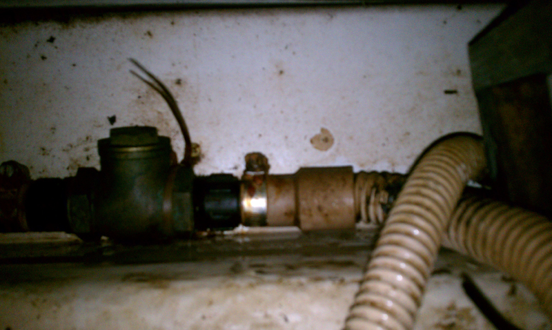

Here's what I found.. .Have attached to pics.... Looks like in '86 they moved the bilge thru hull forward. Secondly, I only need about 2 feet of hose. So I don't think I'm going to rerun the entire line... Well at least not right now. My question is now, what is that junction for? Another bilge?
10,116
That is a check valve, PGIJon.. The hose has a lot of volume in it and without that check valve, when the bilge pump stops, the water in the hose flows back into the bilge backfilling the bilge to the point that the pump would have to run again soon. If ya can get at it, pull it and remove the screw cap and you'll see a flapper .. all that stuff should be fairly clean and free to move. If it is corroded and messy, ya might do well to replace it..
