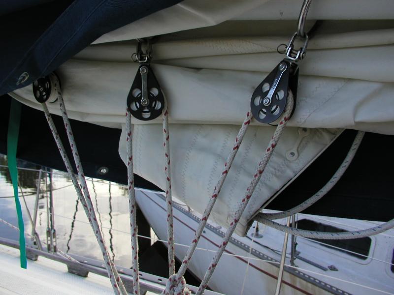

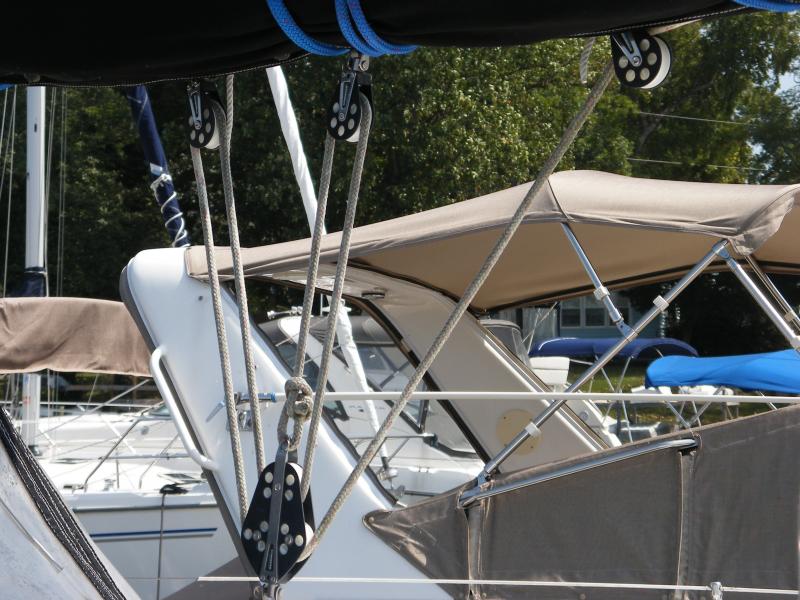

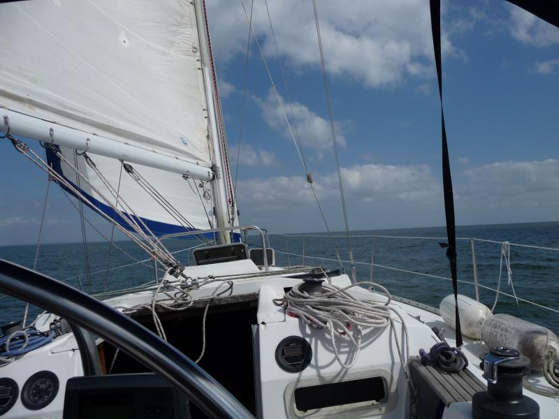

OK here is an attempt to talk through it - the sheet bitter end is in the cockpit and the sheet goes forward the through the jam cleat and up the port side of the cabin top (photo 1) through the fairlead cheek block on the cabin top towards the mast. Through a block just aft of the mast and slightly to port. (Photo 2) Then up to a block under the boom and maybe a foot aft on the boom - the sheet continues aft along the bottom of the boom to (Photo 3) a block down to the double block on the traveler back up to the boom - back down to the double block and back up to the boom where it is tied off.
Photo 1
Photo 2
Photo 3
Hope this shows you enough!!

Wow I guess I should have looked at the title before posting!!! Thanks the photos and text help a lot. Much less complicated then the mess on mine. They have a cable between two boom bails and the sheet end secured to it. I may need to get another bail.
