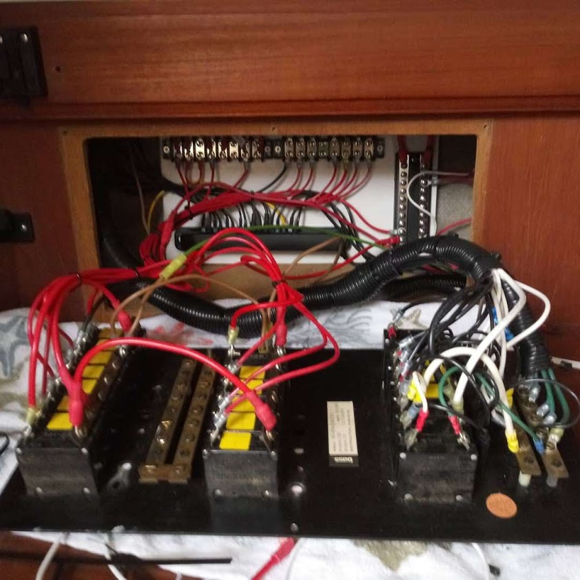

To reiterate what Tim says, the panel on the H34 is particularly dangerous from what I have experienced. Not only are the wires terminated with fork style ends and in a rats nest formation, the AC side wire bundle is super tightly compressed onto the DC side so that removing the panel requires it to be shifted aft to even come down. I can only imagine the metal that would have been lost had they worn into eachother. Might be different on your boat but its worth a look. I had terminals come off in my hand while working on the old system. Don't forget to tug test the terminal ends you install. I was surprised to have one of mine come off. Took my ego down a notch to be sure.
Here are some before and afters if it helps. I added bus bars and terminal strips from blue sea systems to simplify the look of it and allow regular inspection. I also had to extend the AC wires as well as 2 layers of wire loom so I can sleep well.
You got this man!

:thumbup: Nice improvement Drew.

The terminal blocks are a nice touch Drew. Looks like you and I had a similar approach but I took a deeper dive down the hole and took out the shelf, and made a complete panel with additional instruments, added a ShipModul Miniplex which I'm fabulously happy with. Let me know if you want some pix
