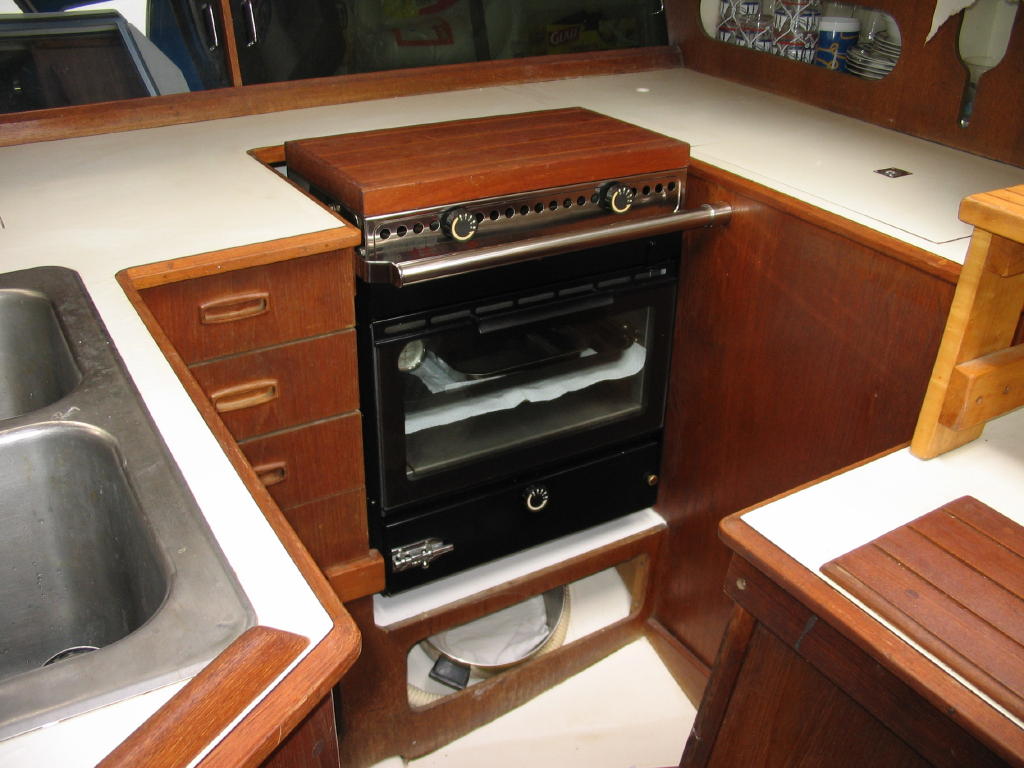

Hey Dick, good to hear from you. Hope everything is fine for you and your wife during this crisis. My wife and I just returned from Florida last Tuesday and are thus quarantined in our house until April 7th if all goes well. As for the hose, mine has got too many ups and down even if I disconnect it there is water staying in it. Take a look at pix. It even coils down under the stove. My simple solution in the fall is to dump non-toxic antifreeze in the bilge and run the pump until I see antifreeze coming out at the through-hull. No problem.
