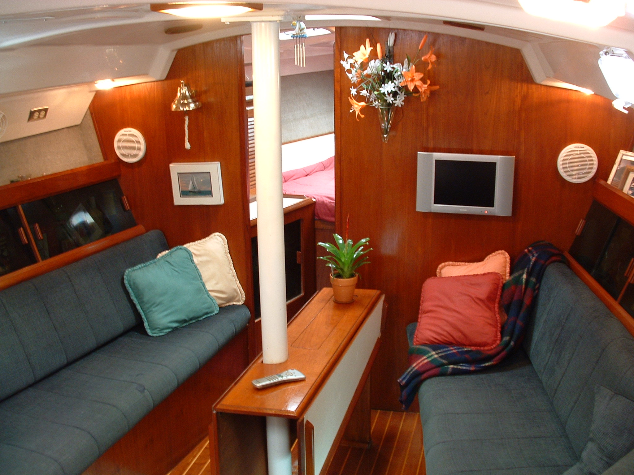

Yo Eric!!!

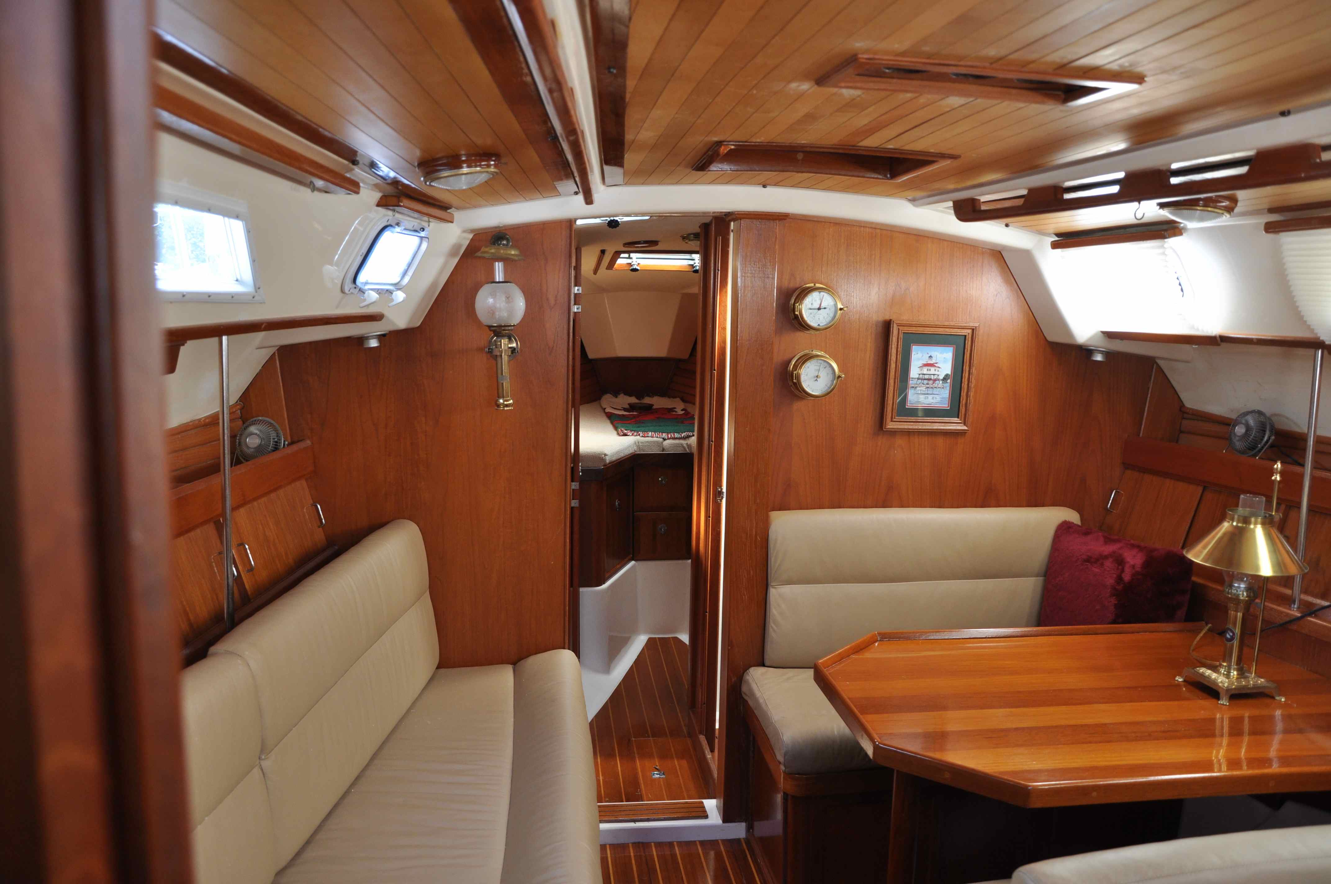

Majorly nice interior refurb job! I like the radio rack, the dorade vent frame, and the port shade covers--nice touches to a really nice looking boat!

Re: I finally did this
Wow Eric that looks sharp!
What material did you use?

What a beautiful job, Eric!! (we need a "green with envy "emoticon here).
Are the headliner strips custom milled or did you find something off the shelf?
What did you do with your fixed ports? It looks like the same frames as the original aluminum but white? If you took the originals apart and refurbed them would you decribe the process in some detail for me? Either an email or a new thread- I have these ports on my job list for next year and I am not sure how they are put together. How did you disassemble and what did you use for new lenses and what kind of paint on the frames (inside and out). Thanks in advance
Eric -- that is the absolutely best H34 interior that I have seen, and I have looked at a bunch of them while shopping for mine. The wooden table and the replacement of the carpet on the walls are both things I am considering as well. Excellent job!
What kind of wood did you use?

Thank you all for the good words.
Here's a rundown on how this happened, probably more than you want to know. I wish I had seen Rick Sylvester's approach earlier -- that's a sensible one! Nice boat!

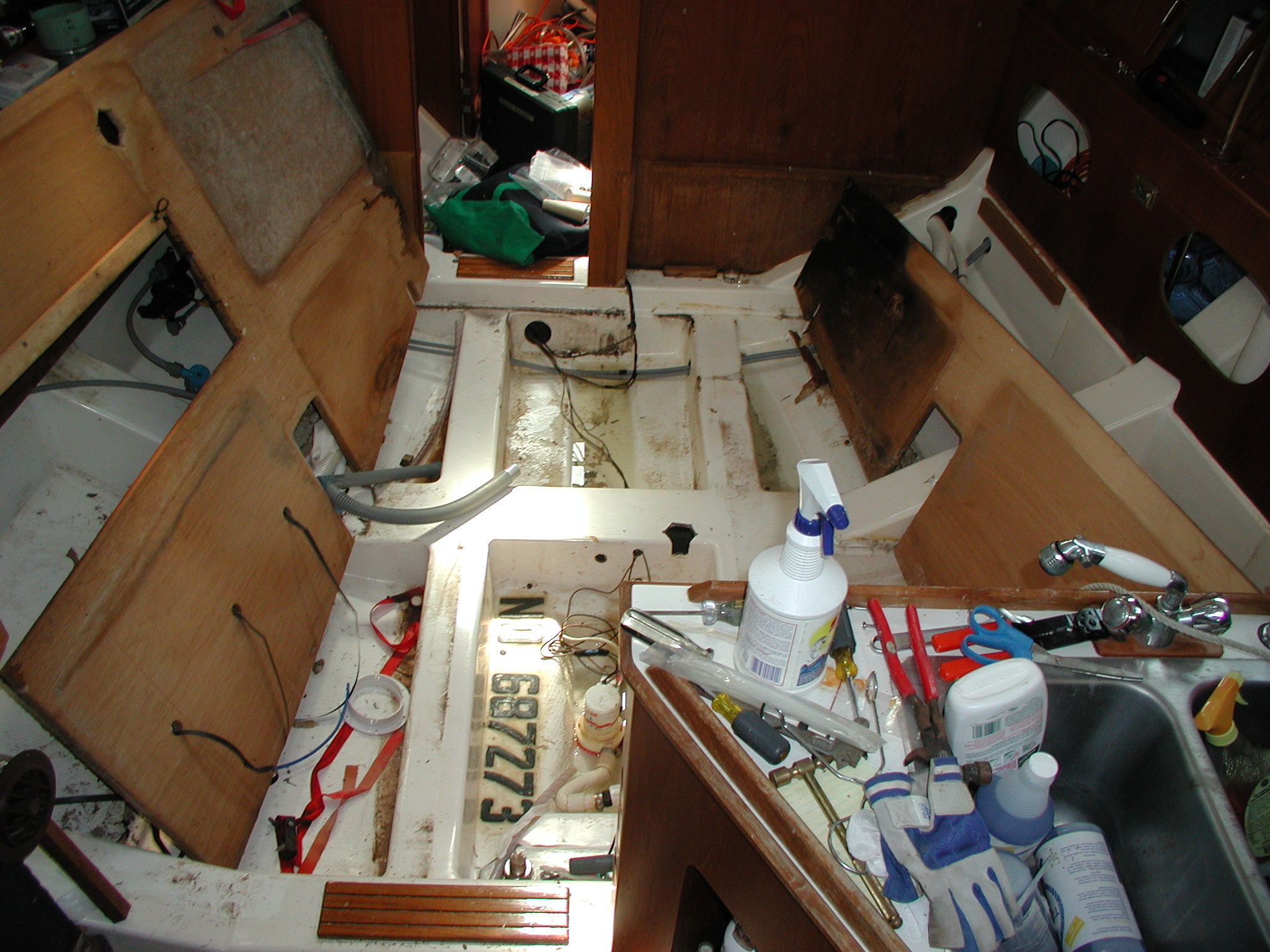

The first photo is what you want to avoid -- that's November 2005, sole replacement that turned into holding tank, refrigerator, head, and water heater replacements, too. Well, that's twenty years for most of that stuff so I shouldn't complain. You can see the results of a persistent window leak on the starboard forward piece of sole and in the bilge. The bilge is now a desert and I am determined to keep it that way.
Since I had to disassemble the salon, I took the pieces home and sanded and varnished them over the winter. Added a few trim doo-dads to make those long flat surfaces a little more interesting.

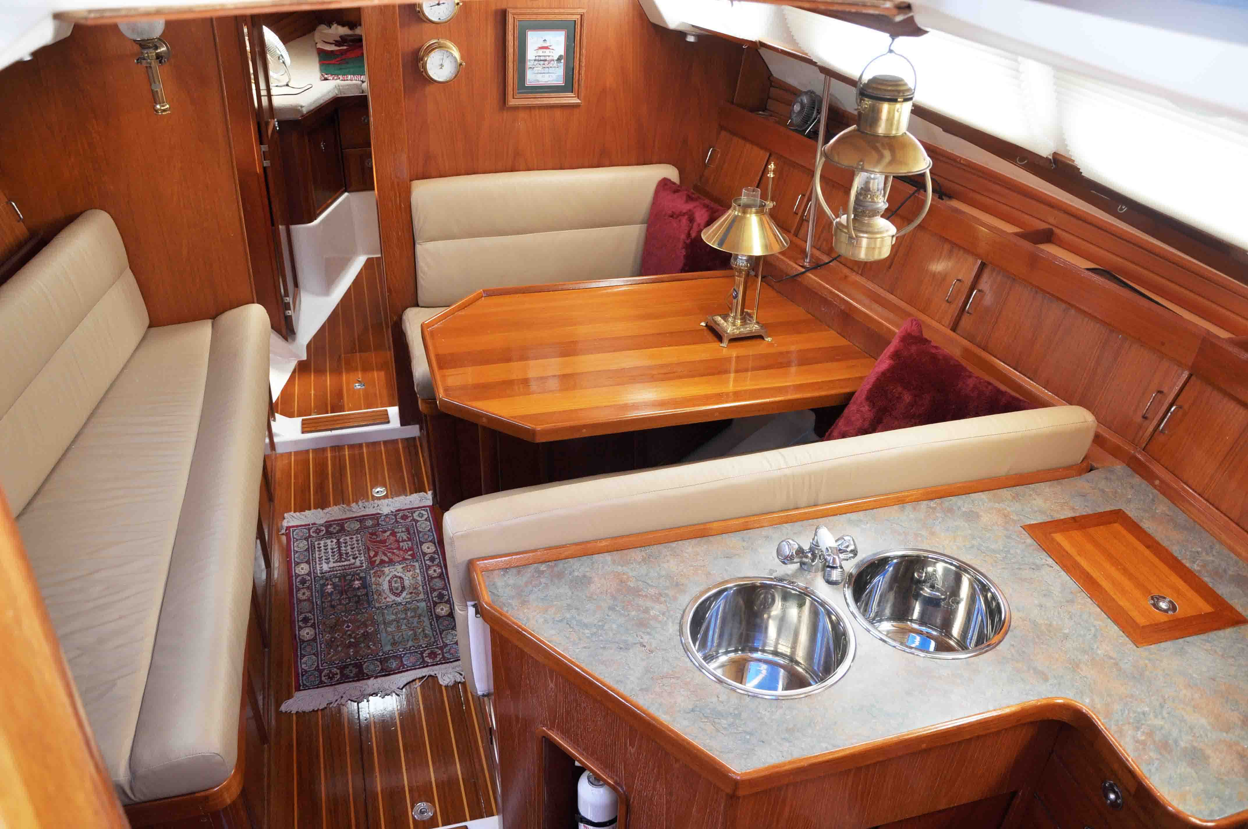

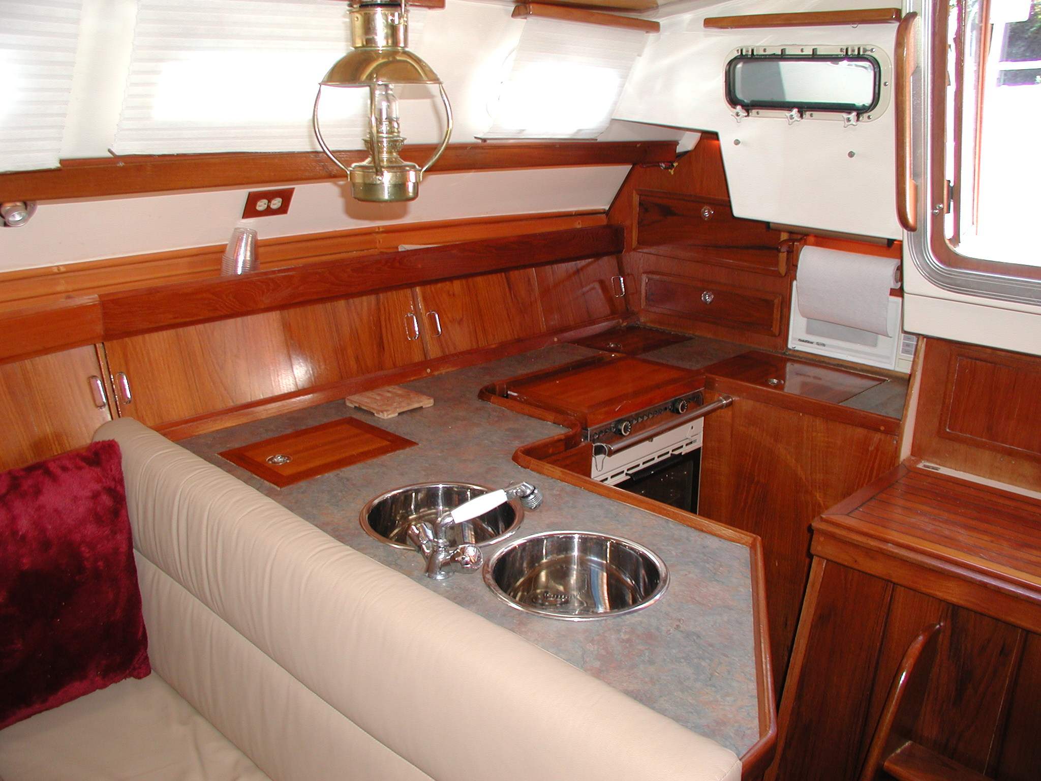

The salon table and galley refurb started simply to replace the cracked melamine surfaces. The project got a life of its own and consumed most of a winter. The table surface is teak sliced as thin as I dared cut it on a table saw. Same with the reefer, trash and galley storage tops.

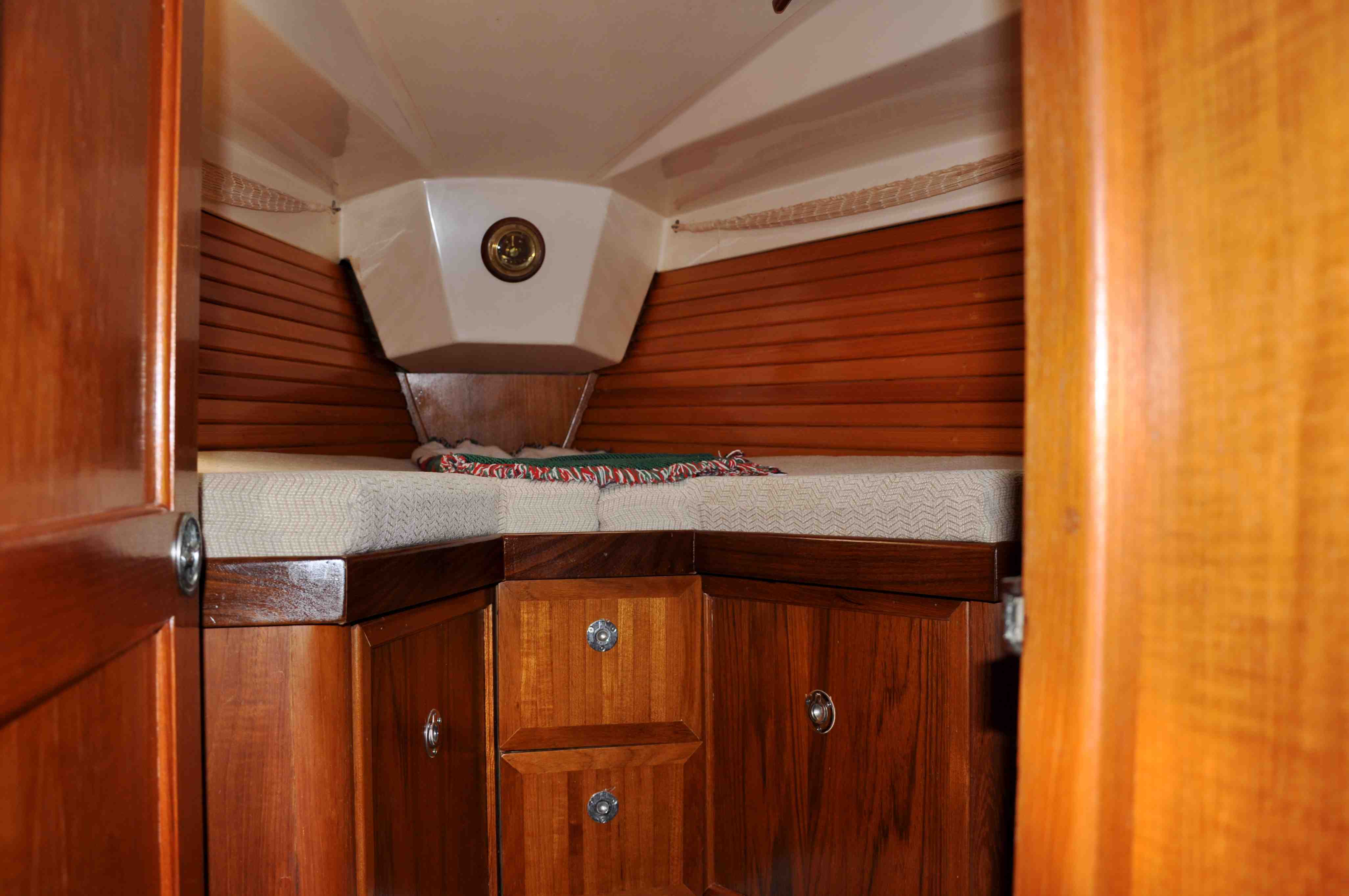

The ceiling replacing the carpeting has a functional value -- I installed bubble wrap insulation behind. Really makes a difference in the winter, especially in the quarterberth, as we used to use the boat as a floating condo in the winter. The material is cypress. I had a millwork shop slice 1/2"X1-1/2" and bullnose the edges, then sealer and semi-gloss varnish. Essentially maintenance-free for 12 years.
Leather cushions courtesy of U.S.Yacht Cushions of St. Petersburg. They made the original cushions for the H34. Fixed ports (this year's addition) from Mark Plastics of Corona, CA.
To answer Richard Bryer's question, the 85 H34 had cheesy plastic ports that I unsuccessfully messed around with for years. Sounds like you have the aluminum ones, which probably are worth saving and re-glassing. They're only held in with a few fasteners and a lot of heavy mastic sealer. You might break the Lexan whenyou disassemble if it's original and crazed.

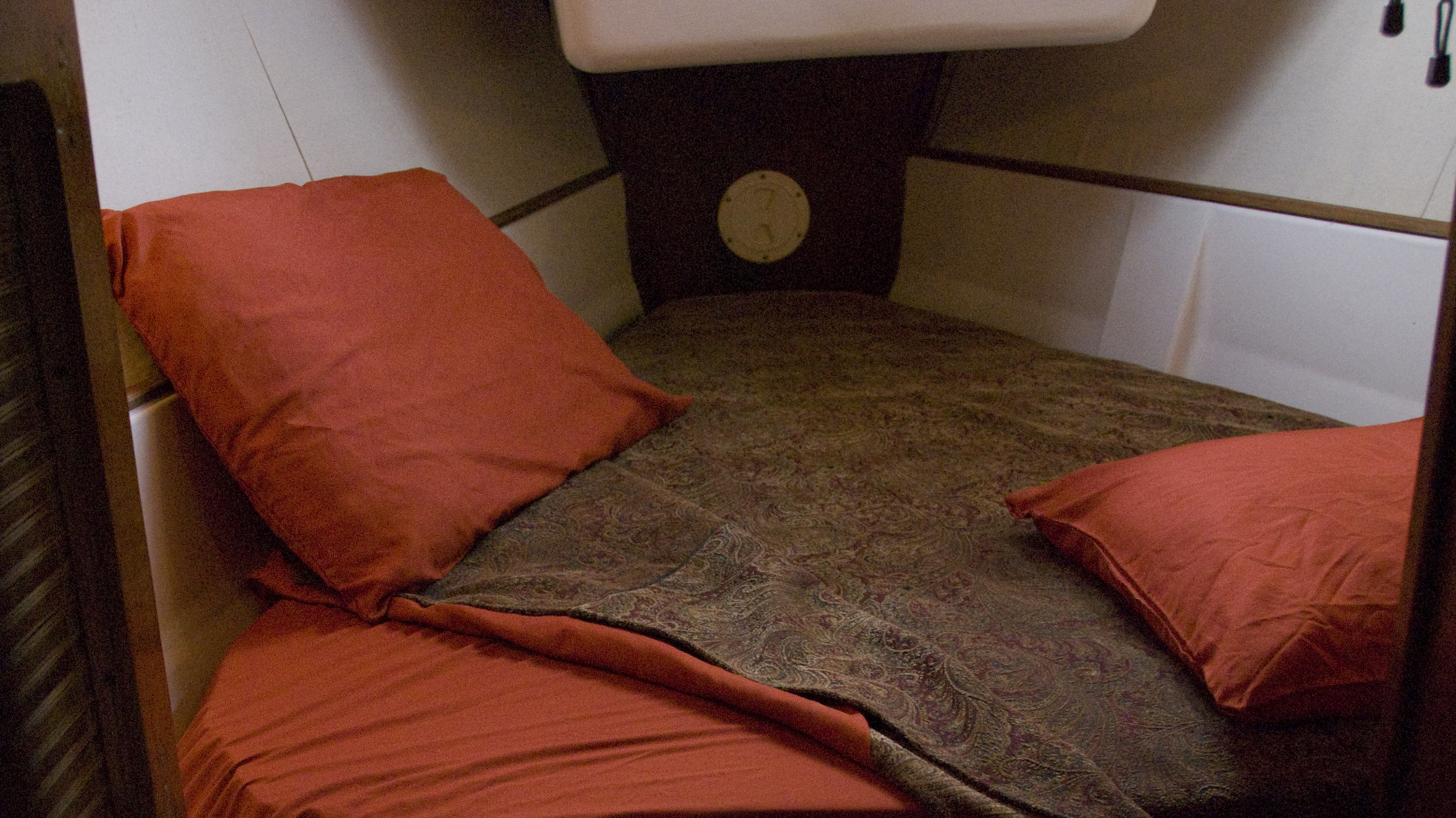

Lots of Monarch teak veneer from Constantines. Beautiful stuff and a fraction of the cost of teak plywood or .. gasp.. solid teak. Used that on the sliding doors and on the enclosures in the V-berth. The solid wood in the V-berth is Ipe, 1/4 the cost of teak. Weird wood. It doesn't float, so don't drop it over the side. Hard as iron, won't take varnish, dulls your tools, but 1/4 the cost of teak and hard to tell the difference when finished with lacquer or Cetol. Did I say it's about 1/4 the cost of teak? Cheap enough to make mistakes, which is my general approach to projects. That way I get to do them twice.
The headliner. Straight from Lowe's plus some solid teak trim. Satin varnish on the face, semi-gloss on the teak border. The backing and the face are 3/16" maple plywood paneling. Pretty cheap, actually. I sliced it on a table saw and chamfered the edges 45 degrees and glued it on the backing. Used a router to trim it before glueing on the teak trim. The only real challenge is getting a decent measurement of the center section, which has just enough camber to make a difference at the edges, and has to be built in two pieces. Same with the hatch and Dorade trim, the challenge is getting the camber right.
That's about it. What I learned is that a router beats a saw anytime for cross-grain cuts, and that wet sandpaper is the only way to go to get clean, smooth and fast surfaces. The trick is to use paint thinner/mineral spirits instead of water for lubrication. Doesn't raise the wood grain and helps the sandpaper cut smoothly.

Thanks again Eric, and everyone! Not even close to being more than I want to know. In fact, I have another question -- the countertops -- is that covering or did you replace them with new material too?
