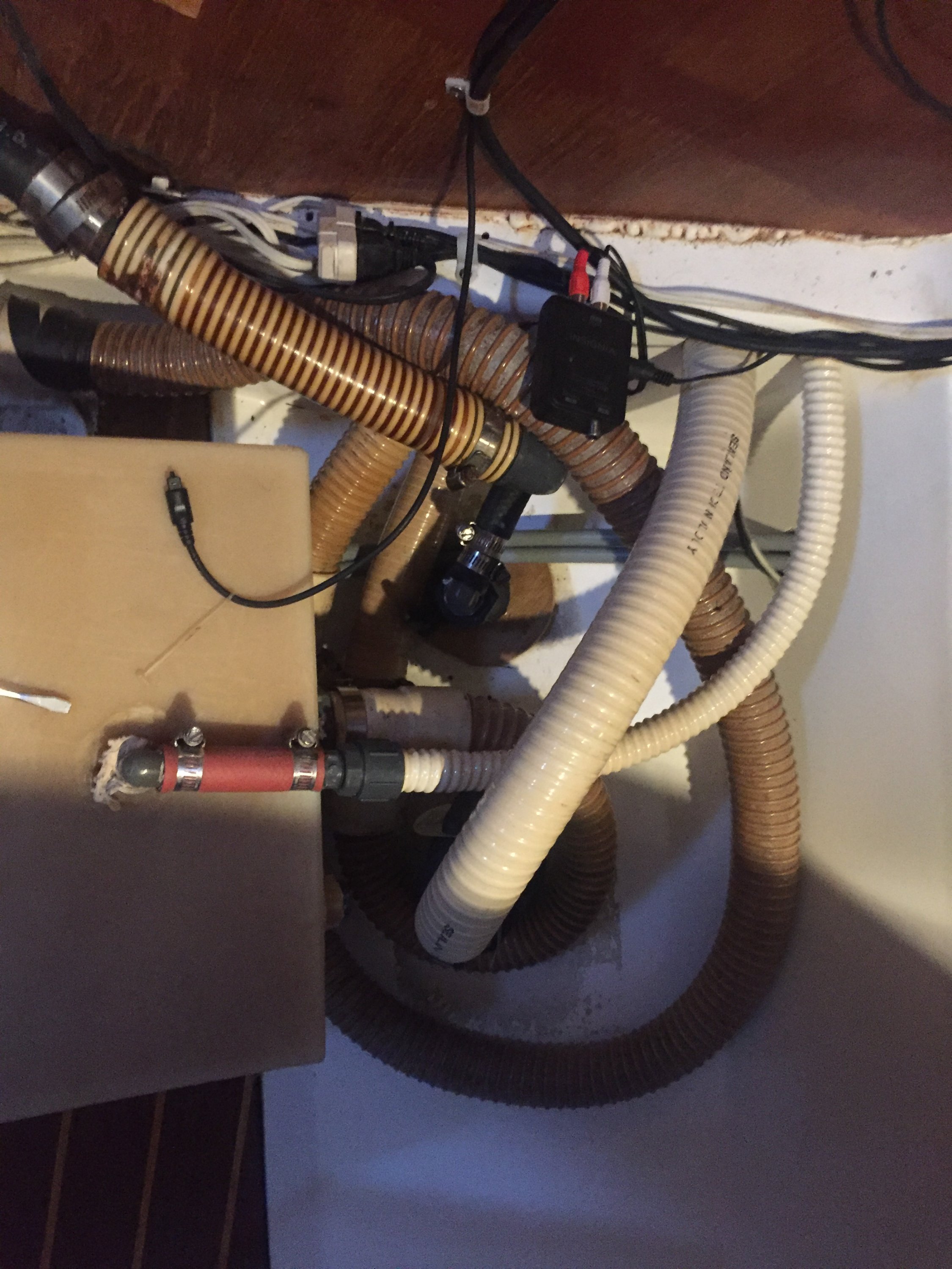

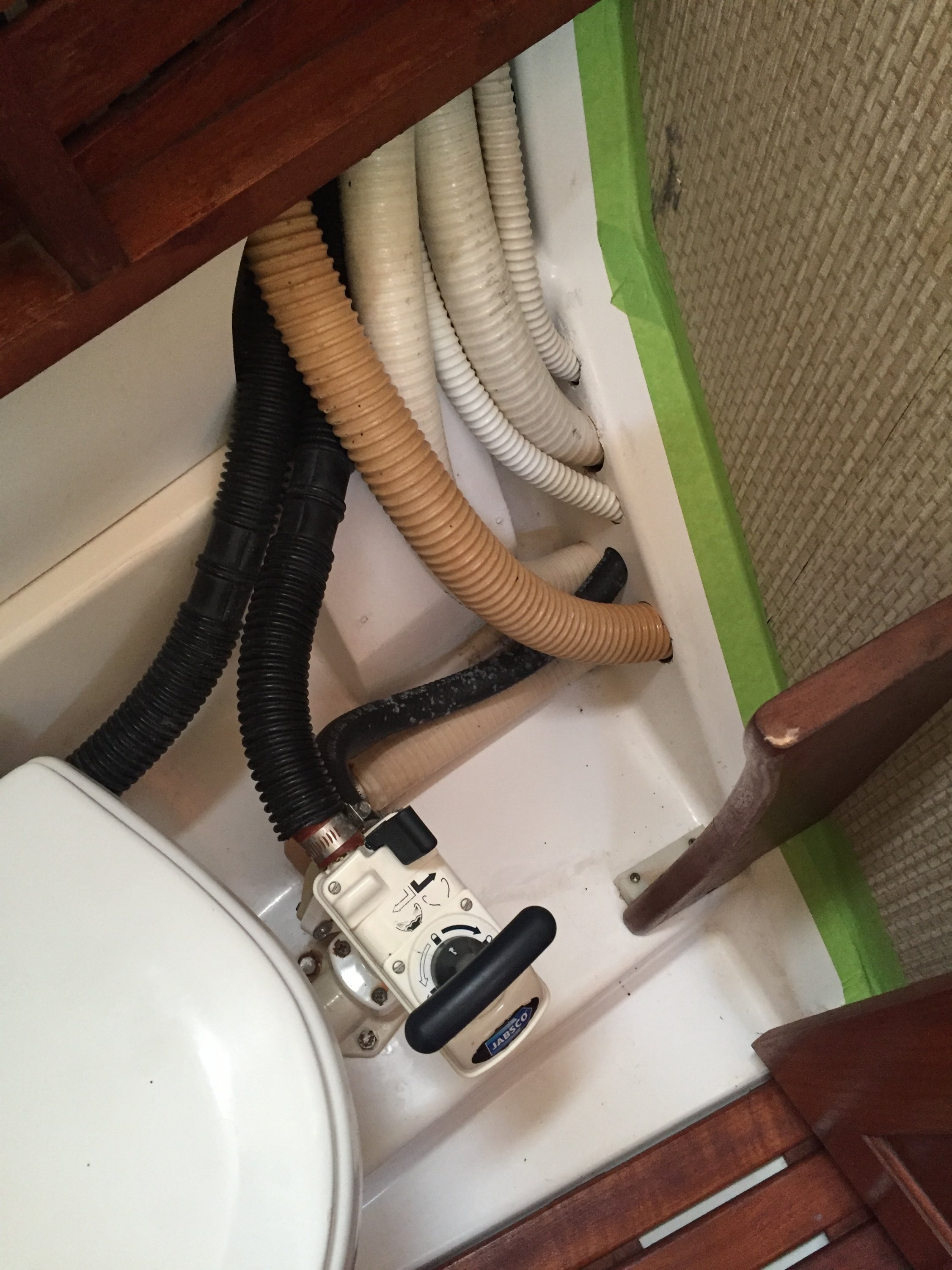

New to big boats owner here (1-week) and just received Peggy’s book yesterday via Amazon express. I’m on the boat now and will start reading tonight. I’ve attached a picture of the current configurationmess of hoses on my H34 discharge system.
Yesterday, I found a leak in my Jabasco 18590, so thought I’d take a relook at the web of hoses and possibly get it designed/laid out better this time around.
I’m also going to be changing the bulkhead panel which separates the shower from the dining area as the leaky pump rotted out the backside of the shower panel. And doing the compression post repair, too (another story).

1. Edit: My pump had a 90 screwed onto the inlet, can I do away with this and mount the pump sideways vs vertical? It was mounted with the motor on top and pump on bottom. I’ve read that it’s best to have the pump above the tank.

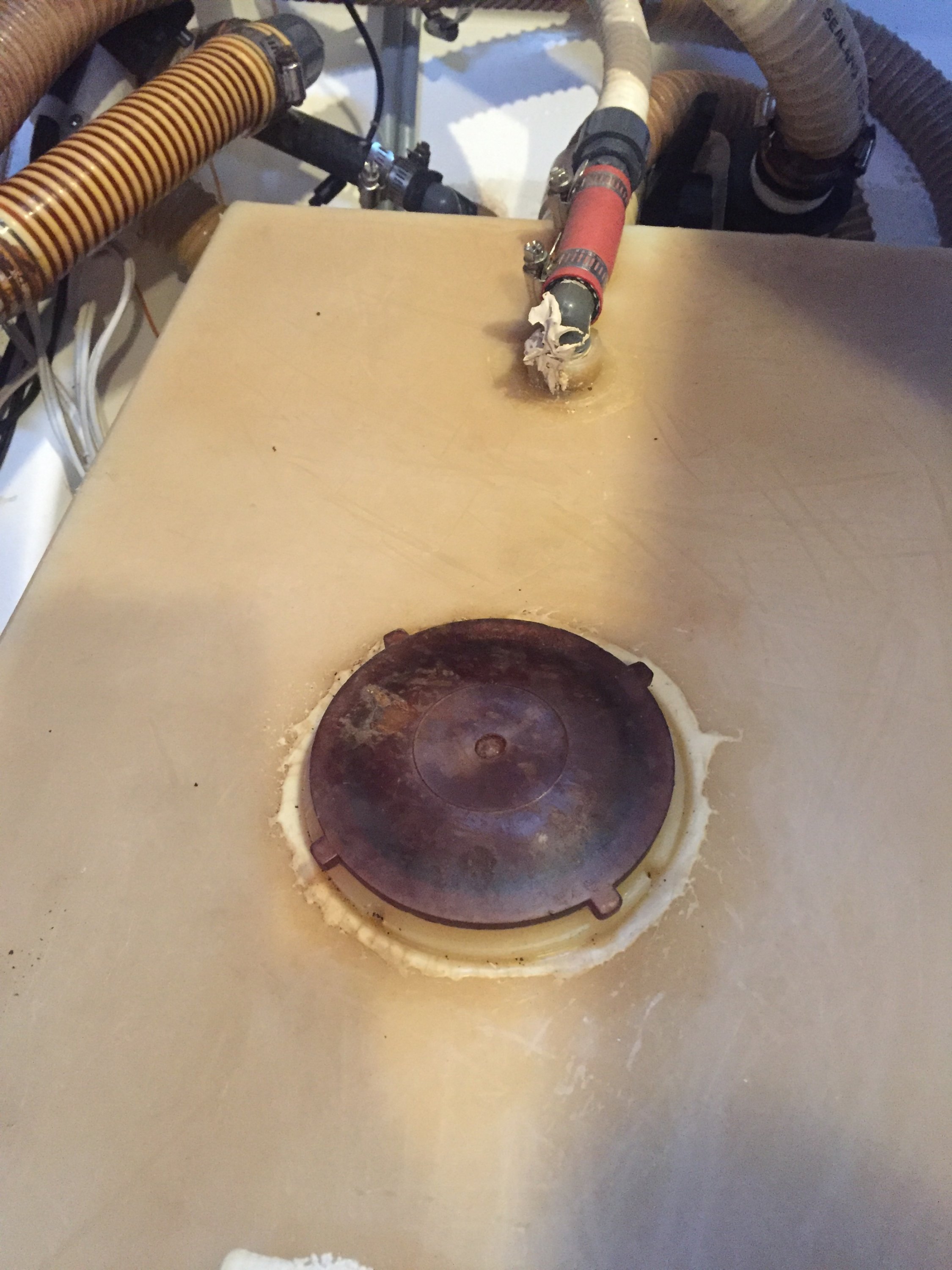

2. My holding tank lid is a poor fit (too loose), any ideas on good fix?

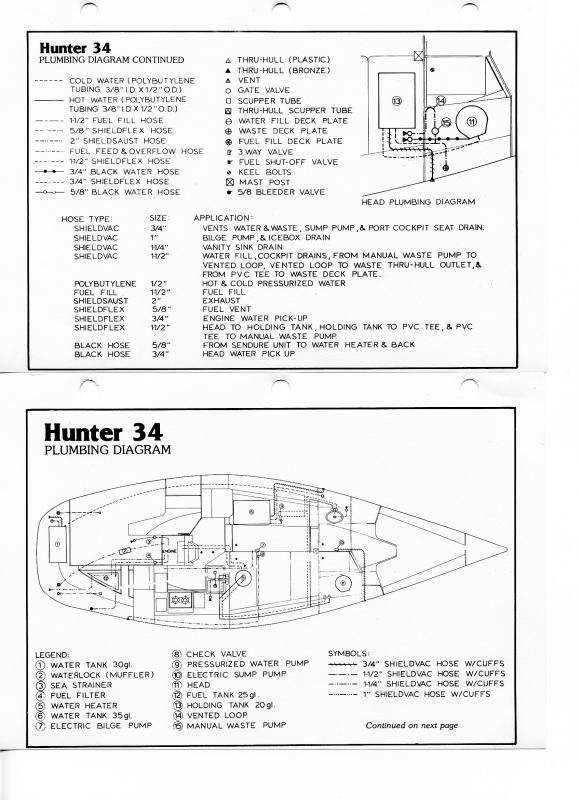

3. When I look at the original H34 pluming diagram, it appears to show the pump inside the shower compartment vs under dining settee. Which is the best place for it?

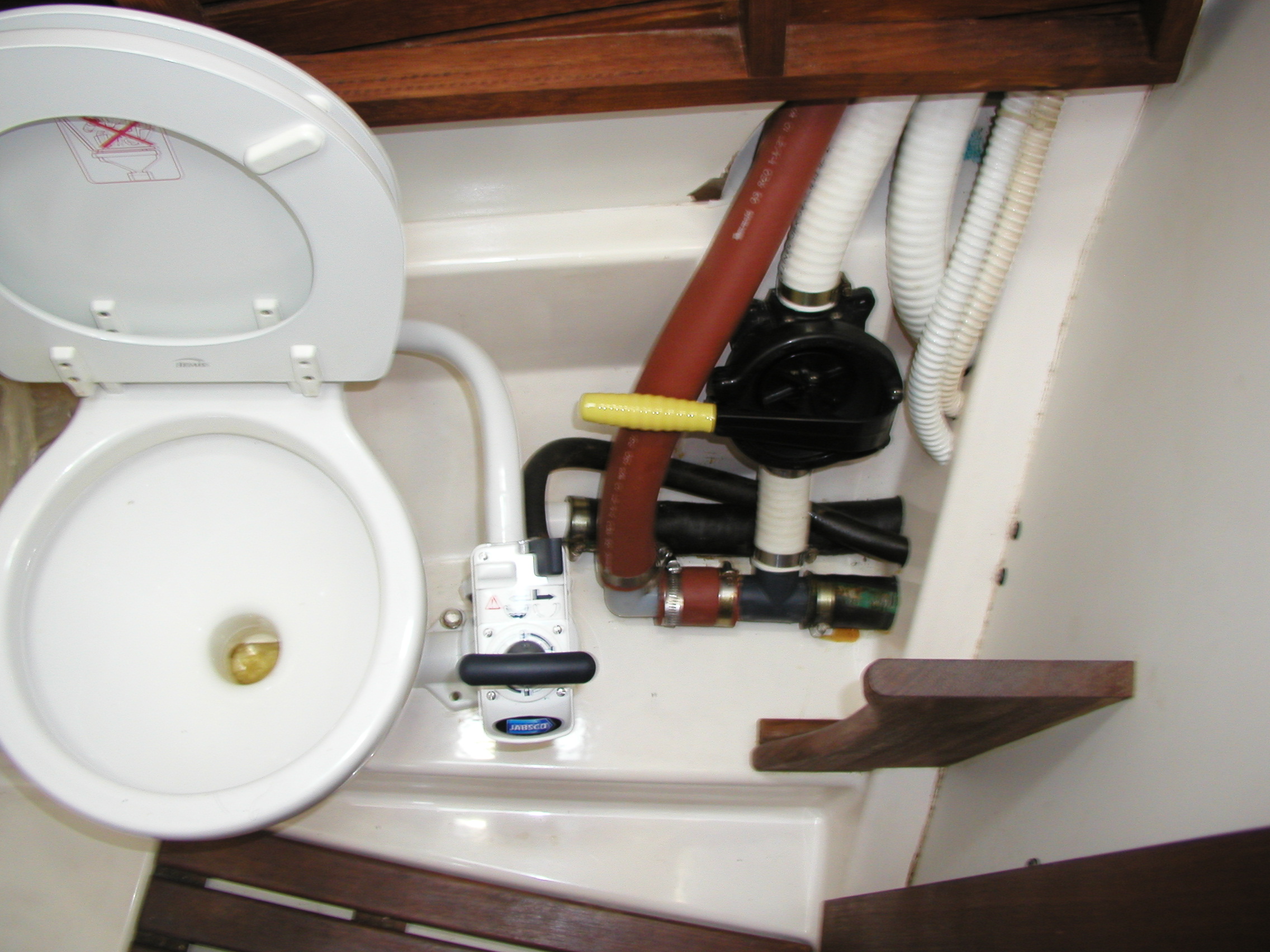

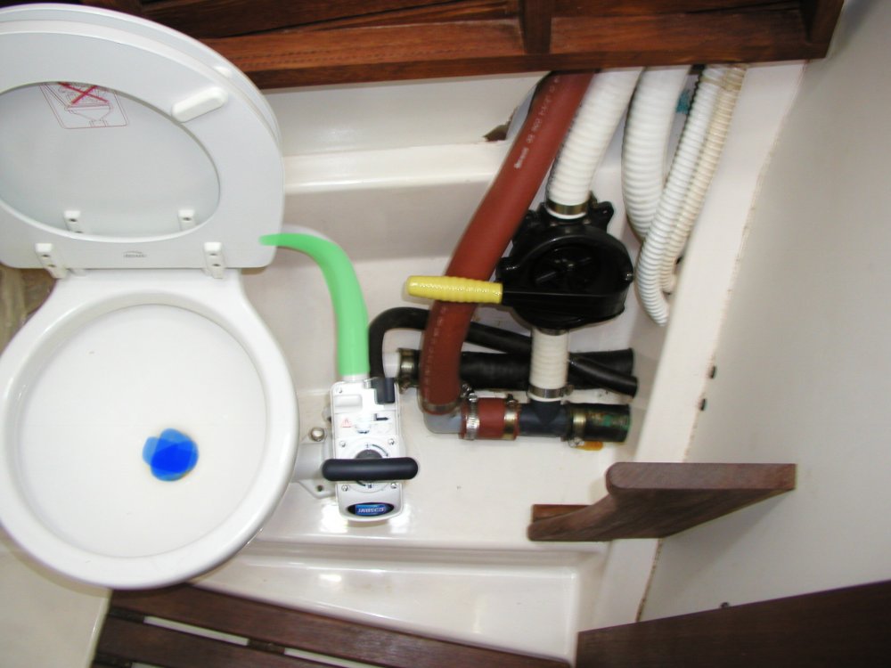

Attached is original set up with manual pump.. (yellow stuff in head is bayou water, not waste) I have not gone to an electric macerator .. I don't think the electric pumps are self priming so they have to be at or below the liquid level.. The motor is best if mounted above the pump, but mechanically, I don't think it makes a difference.. In motor-above-pump, leaks will not so quickly get into the motor.. The macerator pumps don't have a good reliability record..
Holding tank lid? the removable one or the hard cover that the cushion sits on?

The red rubber hose in my picture is a chemical hose with an impervious liner.. so, much like the good Trident ..

I like what both you guys are saying! I’ll look at a manual macerator located inside shower compartment like Claude. And, begin to utilize the shower for quick flush.
I hate that the pump is in the cabin and could leak at any time. It’s done tremendous damage to the panel and compression post; so it’s going to get moved.
Claude: how hard is it to manually evacuate 30-gal with that pump??? Thanks, Shannon

It says Kracor Inc. / Milwaukee, WI
This lid:

Claude, is your pump mounted to the hull, or suspended between the in/out hoses?
10,153
Not hard to empty the tank manually at all.. takes less than 10 minutes.. .. The Whale pump is mounted to the big fiberglass bracket. I can see, in your picture, the old screw holes on yours (behind the hoses).. The clean out port in the tank top is not standard and was installed by a previous owner. Looks like a deck plate .. may have mismatched threads? (wrong cover for the base?)

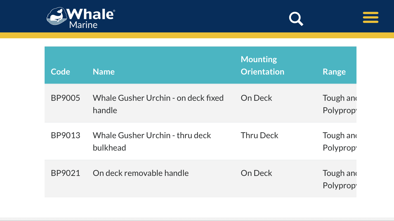

Pretty sure this is the pump I have: http://www.whalepumps.com/marine/pr...009&Product_ID=10012&FriendlyID=Gusher-Urchin

Kloudie is write whale urchin pump works fine however get the upgrade rebuild kit from me directly because the diaphragm will ware out within a year. Mine did and they said that the neoprene material is only rated for water and not very resistant to chemicals.
It fits almost within to same holes of the factory original. Nice thing about urchin pump is that you can adjust the pumping handle. I think you can buy it on amazon or defender a lot cheaper the west marine
Likes: mnmpizza
10,153
Fixed handle, on deck. You can buy the nitrile diaphragm kit as a spare and install it when the other fails..

In Peggy’s book she says to not run that fill line (the green one) directly to the toilet but to run it up above the WL and in a loop back to the toilet. I’m sure you’re aware of this, so why did u keep it this way? Also, I cleaned your toilet
10,153
Thanks for the clean up !
I know that the waterline is just a little below the toilet rim on my boat so it won't overflow if/when the valve leaks .. I have had guests leave the wet/dry switch in thee wet position and the bowl fills but does not overflow.. I don't worry about it when sailing because I check on stuff below every now and again..
I noticed that your picture has a vented loop in that line; I'd probably not change it..
