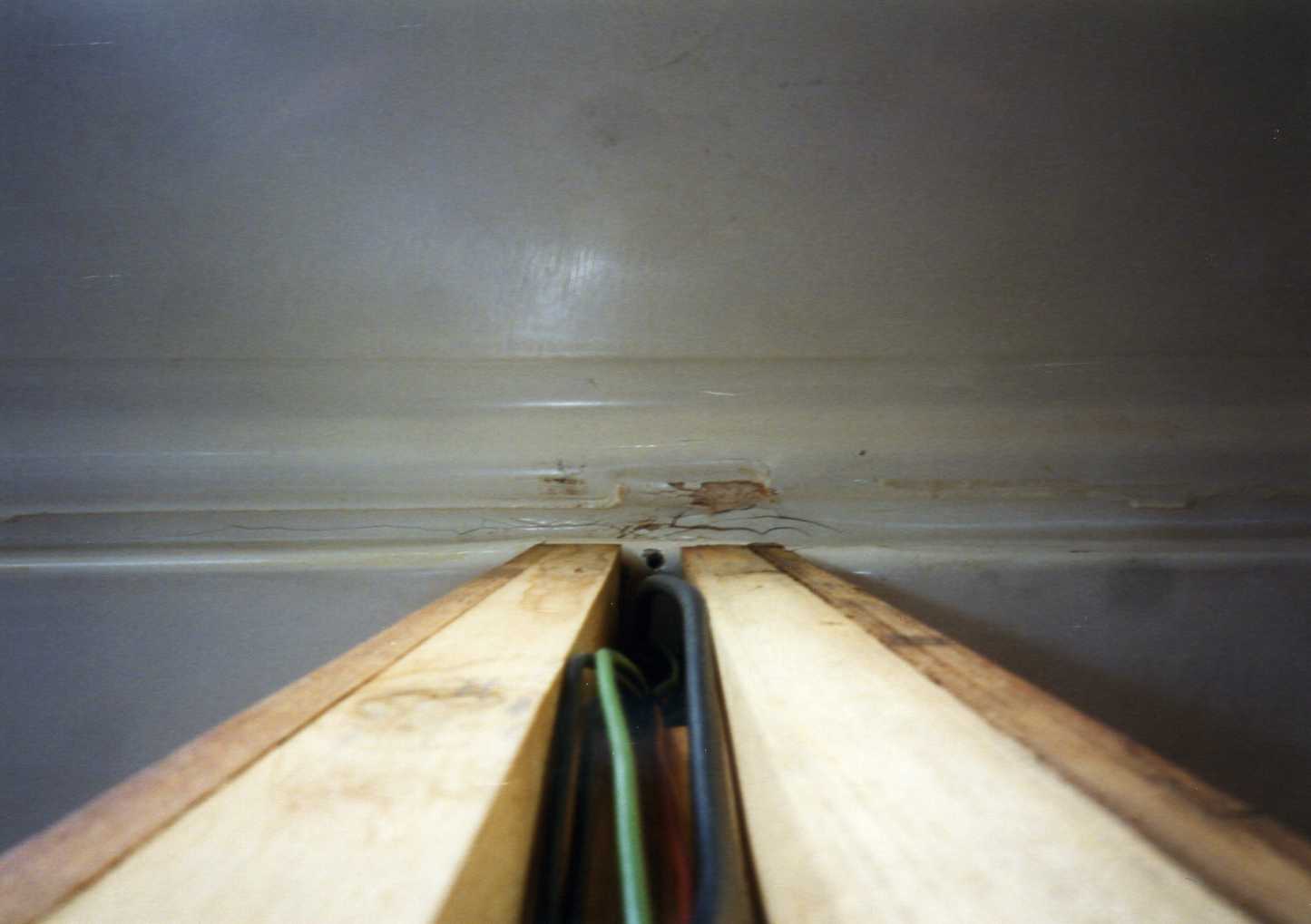

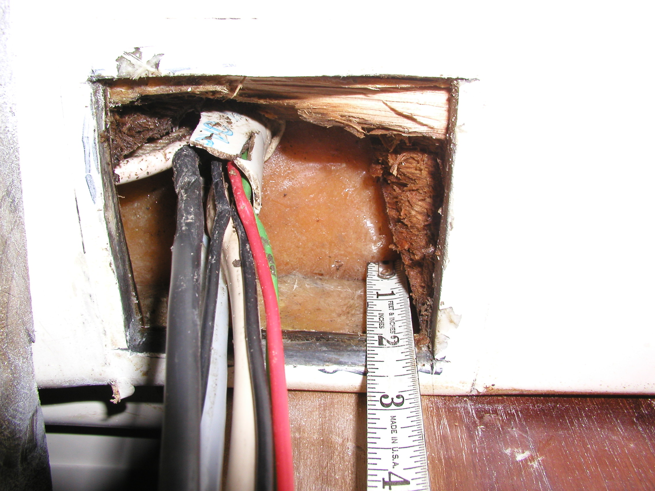

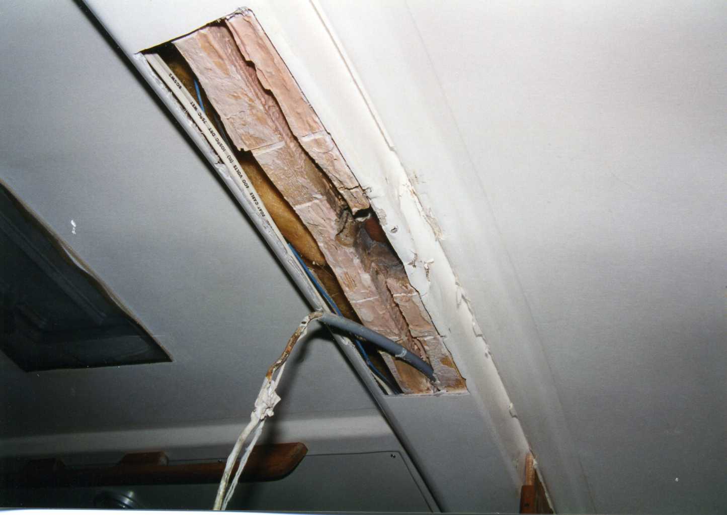

Here are a couple more photos from mine. Wires for the lights (anchor, steaming) disappearing straight up Wire for the coax VHF feed plus a pull string routed through a piece of water pipe. That was laid into a hogged out channel in the wood transverse piece and off to port. After my repair I ran the light wires (now tricolor, steaming, spreader) down to the settee to a terminal strip. If the mast comes off again I can disconnect down there and pull the entire wire bundle up and out. I taped all those together to make it easier. The coax still goes to port and so I still have a connector inside the mast with enough slack to get to when the mast is raised about a foot.

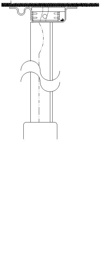

By the way, its not a straight shot down into the post. It turns out the mast is slightly aft of the compression post, so you have to fish around to find the path. He is my attempt to diagram how mine looked after I made my beam repair. You can see the dogleg in the wire path down to the post. When I replaced the PVC I made it about 6 inches above the deck to prevent future water intrusion allowing for a drip loop in the wire loom.

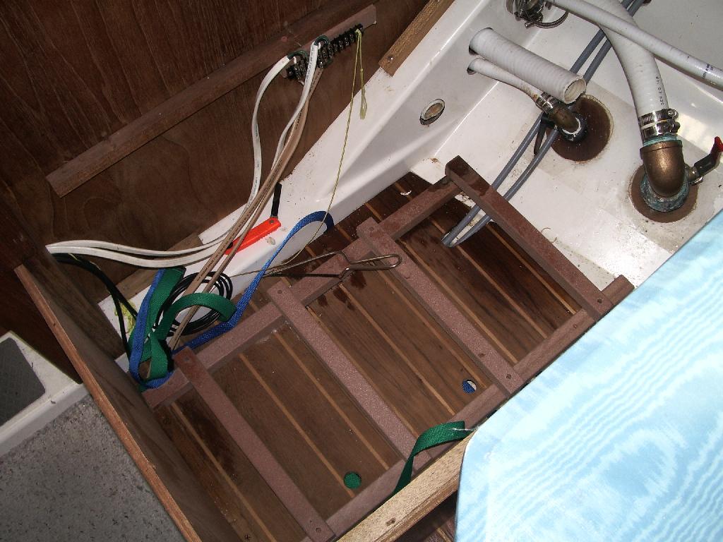

Look at the very bottom of the compression post inside the settee where the holding tank is. Do (or did) the original wires emerge down there? I found a picture after I routed the new wires similar to what you are doing where you see them coming out near the bottom and going to my terminal strips.
If so, you can use them to fish the new wires down the PVC and through the post. If you don't see the wires down there then all of yours may follow the same route as my original VHF coax by making a sharp turn and heading to the port side. The expanded size of your new wires may not fit that way if they are trying to squeeze in that grooved piece of wood. I don't like that route as they may eventually get pinched. That happened to my coax when everything compressed down and necessitated my compression post repair project.
The best choice then is to get the wires down to the bottom if they have never been routed that way before. The channel in the post is behind the teak head door jamb. Remove the head door and hinges. Then look for the wooden plugs hiding the screws that attach the strip of teak to the front side of the post. Once you pop those plugs out and remove the screws, the jamb piece can be removed. It may reveal the channel in the compression post. Or, if the bulkhead still extends far enough to cover the channel you can pull the post revealing everything. I think (20 years ago at least) that the door jamb screws are what holds the post up against the bulkhead. Once they are removed the post is loose. You might have to push up on the cabintop and it will fall away. At that point you can poke upwards through the hole in the bottom of the beam and emerge out the PVC on top.

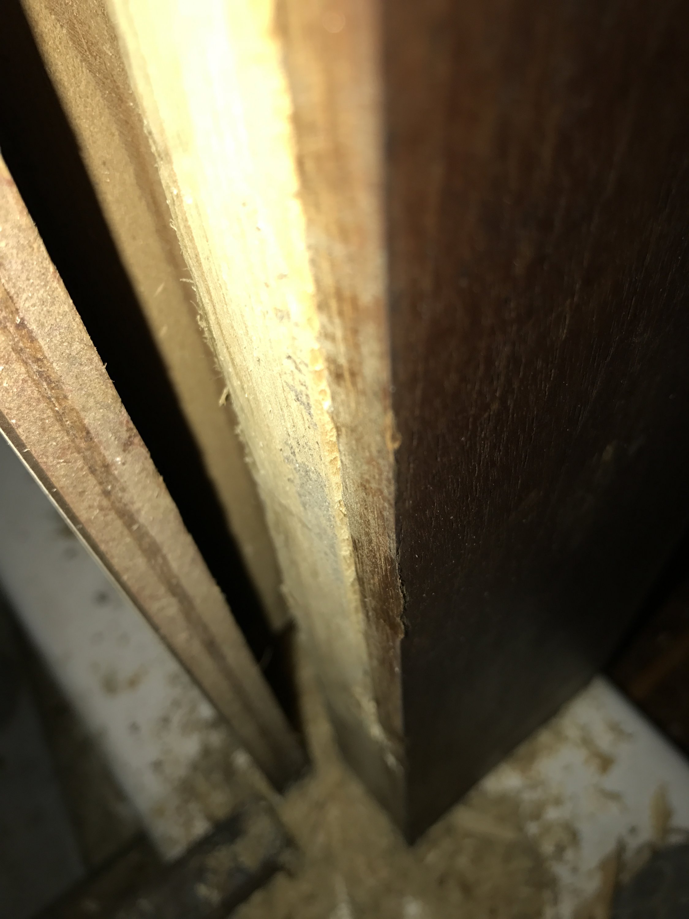

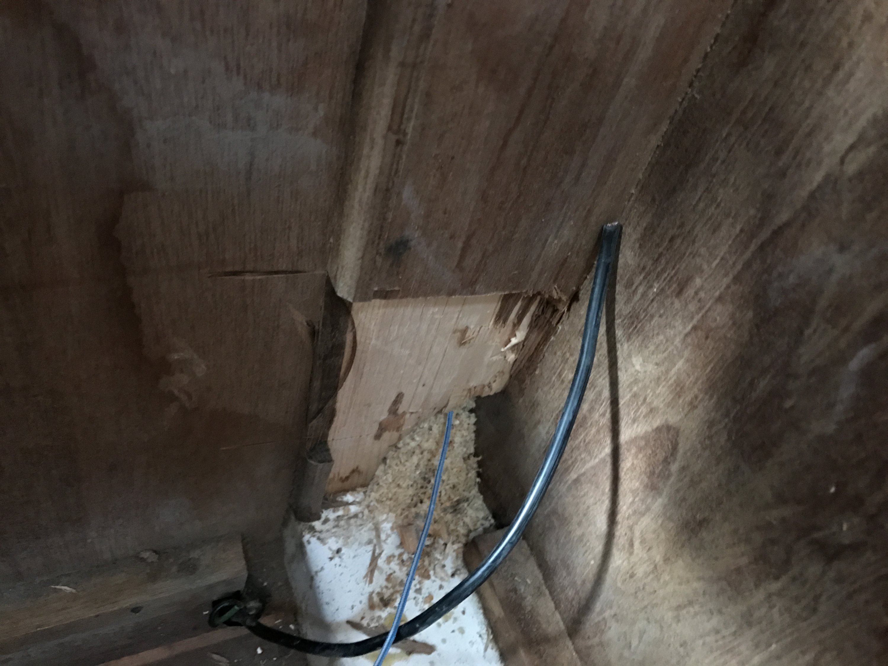

Back again new update re my wiring coming downthe post! I arated removed the teak strip from the bathroom inside door jamb. And found the wiring channel and now easy access to run my loom. I found it dry and no signs of water. But I want to mention the wood post is a tight fit and how would I know if it needs replacing?IMG_2181.JPGIMG_2180.JPGIMG_2179.JPGIMG_2179.JPG
