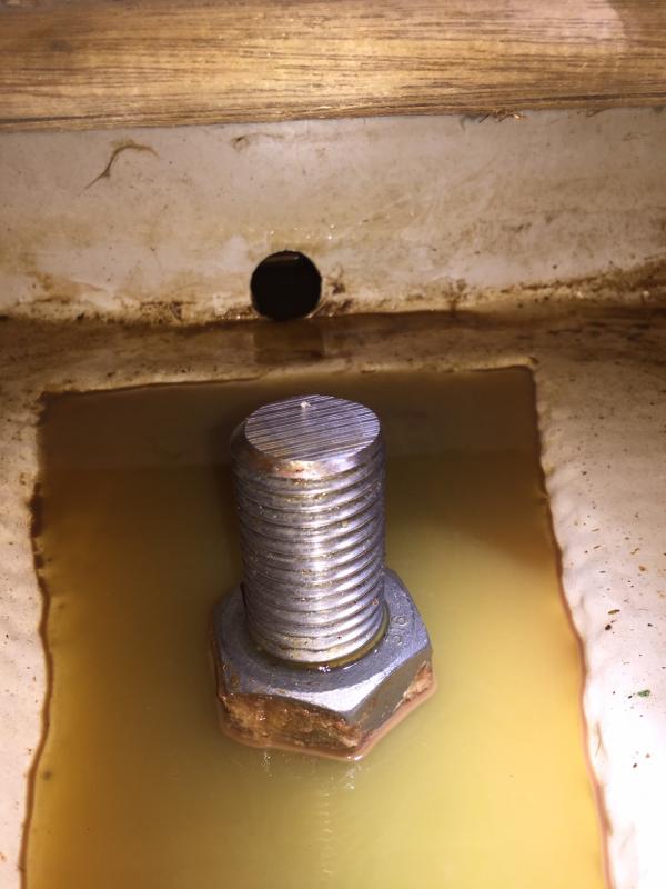

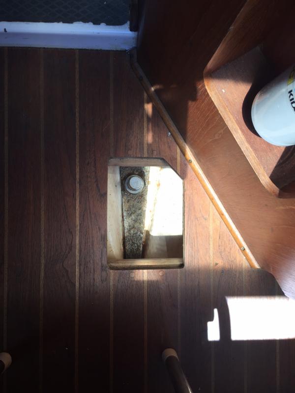

Antifreeze/h2o mix is draining into the small bilge at the bottom of the companionway (i call it the aft keel bolt bilge, because i don't know better). 1/2 pint to a pint when i run the engine for any length of time.

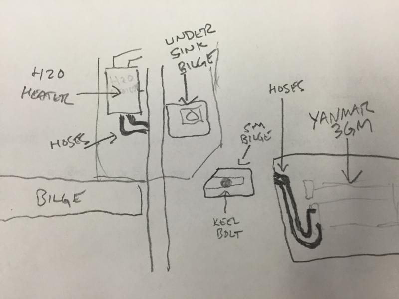

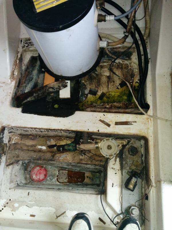

I've committed to replacing the water heater, which appears to be quite old with visible corrosion at the bottom on the port side. However, I can't for the life of me figure out how the hoses get from the engine to the water heater, how to access in order to run new hoses, etc. It's the mystery hose run...
I'm sure I might get a clue when I pull out the water heater next week, but wondering if any of you could offer any experience or insight as I am mystified and find no clues in any Hunter documentation.
Attached is:
- a poorly drawn diagram
- pic of the so-called "aft keel bolt bilge"

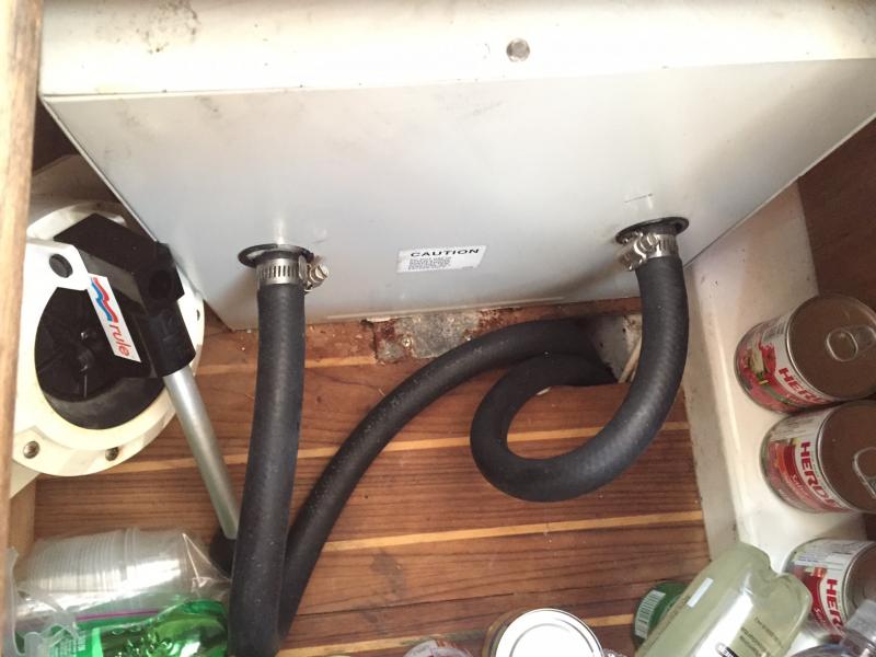

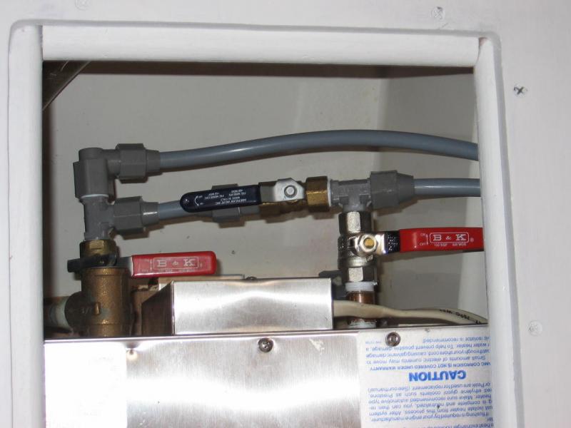

- pic of the hoses exiting the water heater from it's port side and disappearing into oblivion.
- view from inside the "aft keel bolt bilge" looking forward

Dan;

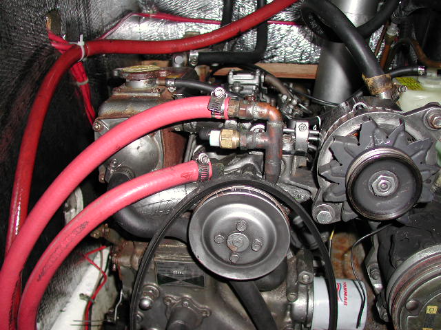

Don't look to close at the mess but focus on the hose routeing. If you blow the picture up you will see the hose's run though a stringer. I think it runs under the galley sink.
The only thing I could suggest is to attach the new hose to the old one and pull it though like you would a wire.

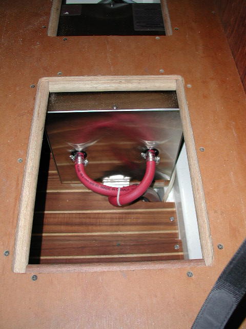

a suggestion - couple the hoses, old and new butted together by an insert held in place with really tight zip ties?

I had the same problem on my 1984 h34. I dropped in red die in the mix an located the source. A pin hole in the hose running to water heater heat exchanger. As mentioned tied new hose to old and pulled it through.

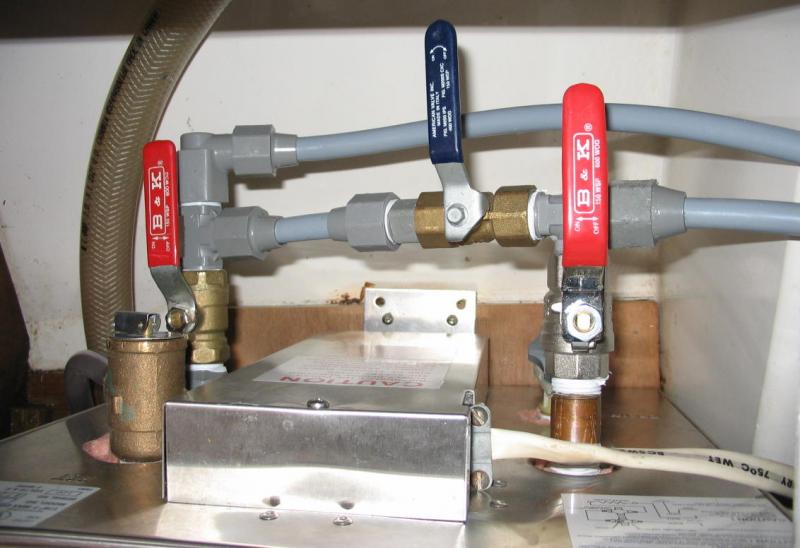

Been there, done that. Pin hole in the water heater hose. Had to replace. Check pressure with a tester to make sure. Here you go with info and pics. I'd suggest you make yourself a manifold like pictured here. Simplifies winterizing without sending antifreeze in the water heater.
