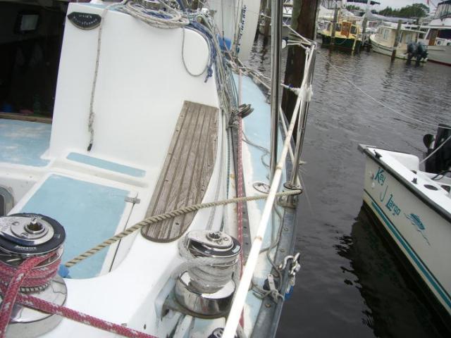

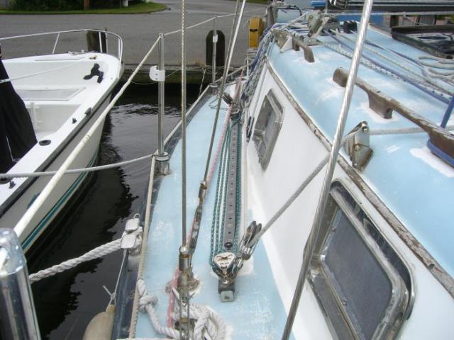

My tracks are Garhauer, about 11 feet long, mounted on the side decks as close to the coachroof as possible. They extend from the chainplates back almost to the winch pods. My head sail is a 135 so the sheets pass outside of the shrouds. Sixty holes, thirty per side drilled, thickened epoxy filled and re-drilled. Strong and no leaks.

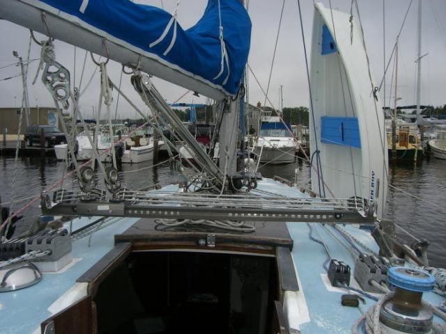

Pictures show it best. First is looking aft on the starboard side, Second is looking forward on starboard. second, smaller winch was added for better power on mid boom mainsheet traveler. Third shows Garhauer traveler mounted mid boom and Garhauer solid vang.

I thought that winch would get to you Jorge. It is mounted using a Spartan Marine bronze winch base like you used to see on lots of older boats, especially those that had wooden coamings. With the mid boom traveler and the main sheet brought all the way back to the wheel the winch is the only way I can get the power to haul in tight on the main in a good breeze.

Hey Sam, I couldn't really tell from the pics you posted - how are your jib sheets run to the winches? I am considering putting cheek blocks at the end of the outside of the coamings to run the sheets thru before going to the winches (boy that is wordy!) any thoughts?

Uh -- Ok. I figured out what you're asking. Jib sheets run through the Garhauer sliding blocks on the tracks, back to turning blocks attached to toe rail just outside of primary winches. In the middle picture above you can see the red jib sheet going out of the picture, through the block which is out of the pic, and then to the winch.
