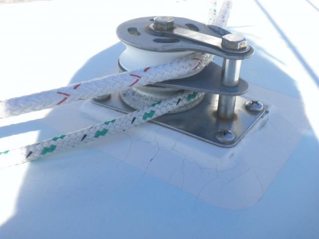

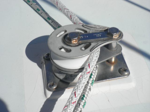

I am referring to the two-sheaved organizer mounted on the deck which turns the lines from the mast base to the rope clutch and winch; I will stop by the boat on my way home from work and snap a photo. . .
Jun 21, 2007
2,117
From your photos, the organizer still looks in reasonable shape? Just a thought before replacing the entire unit, if its mainly the sheaves you are concerned about, again from the photos, it would appear that removing the center axle bolt will enable the sheaves from the block's stainless steel pieces to be removed. Replacement sheaves can be purchased at many sailing sites.

Dear Fiesta Mojo:
At my boat yesterday, my eyes chanced upon my port side organizer. It's something that I cobbled together from a one level organizer to make a two-decker to provide more and better aligned leads when I added a cunningham line back to the cockpit. Not particularly pretty, but it has been working fine now for a number of years.
This triggered me to take another look at your photos. I see from your profile that you have owned the boat since 2010 = many years for PO's to make undocumented mods.
Is it possible that your deck organizer is not a block as originally made by any manufacturer? A few things make me think this:
1) The upper and lower sheaves are different; nylon and metal.
2) The bolts which go through the center axle and the support to the right, look more like they are from the fastener selection at West Marine, rather than original. The appearance of your bolts differs considerably from OEM bolts as in the below picture (from my miscellaneous parts bin) for example.
3) Somehow the cheek parts of the organizer don't look quite original?
Anyway, it could be that your organizer originally was a one level block. A PO might have drilled out the original pressed-in axle and the other pin and then got creative. In the same manner, I've kept alive older blocks that were basically good shape except for the sheaves by drilling out the factory pressed pins, putting in new sheaves, and then replacing the pins with 1/4" lag bolts and nuts to tighten.
Back to my attached picture. Say if I were to find an older block at a nautical flea market that had the same distance between centers as the block pictured, I could mount the flea market block on top of the existing sheave by replacing the existing short bolts with longer ones and make it a 2-fer. The top block wouldn't be as strong as the original design, but depending on the intended use, probably would be OK.

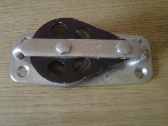

Its a Double Cheek Block
FiestaMojo:
Take a look at the bottom of this web page. CHEEK Blocks instead of organizers. In particular, the double cheek block SCH30329 looks very much like yours.
http://www.mauriprosailing.com/category/Schaefer-Flat-Base-Cheek-Blocks.html
Maybe you could measure the distances on your part between the four mounting holes for the small screws and then ask a supplier to verify that the Schaefer cheek blocks have the same?
Jun 2, 2004
5,802
Good catch Rardi. That is exactly what he has, a stacked cheek block. And I'd bed that he will find a match for the holes.

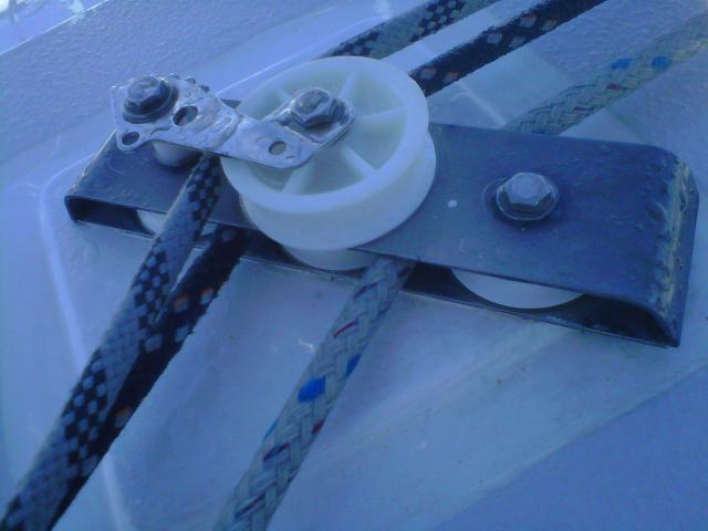

Hi Ed:
I know that I've become a little too transfixed by this topic ... but it became a mystery to be pondered. Gotta give the "little gray cells" some exercise once in a while.
I still think that fiestaMojo's cheek/organizer is modified from something else. At the very least, a PO drilled out the factory pressed center pins of a double cheek block to replace one of the original sheeves.
While at my boat yesterday (after a great afternoon sail), I again rummaged through my miscellaneous stash of stuff. I found the two Schaefer items in the first below picture. The cheek block is a flea market acquisition for couple of dollars or so. The standard block was one of the original boom sheet blocks hanging from my boom bails when I bought the boat. Good chance it was Hunter's original supplied equipment in 1980.
The centers between the two pressed-in pins on each item are identical. The cheek block has a metal sheeve. The standard block has a nylon one. Same combination as fiestaMojo's piece. So if one drills out the pins on each item, stacks the standard block on top of the cheek block, and then replaces the pins with 1/4 SS lag bolts -- we've got a custom designed deck organizer.
Also attached is a picture of my modified starboard deck organizer. I've probably got the only one like it in the world! The second deck sheeve routes the boom vang line back to the cockpit. Hunter did not outfit Cherubini 36's with a boom vang. The orientation of the 3rd sheeve in the existing organizer (the lower portion in the picture) was wrong when I added my boom vang. So a second deck was needed.

Feb 14, 2010
156
Hunter H33C Quincy, MA
Thanks Rardi and Ed. . . looking at your last set of pics Rardi I do think you're right about the origin of the organizer. . . I haven't checked under the organizer, but I replaced the double rope clutch and there is an aluminum plate under it (I'd assume there are plates under these also)
