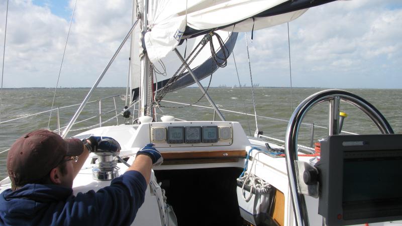

Curtdo, we had our Hunter 340, almost the same boat as your 336, out Saturday and saw apparent wind over 30 knots most of the time upwind. We had to run just the main with two reefs. I recently had the main luff recut to flatten it more and I think it made a big difference. We kept it under control but made lousy headway. Tried to unroll a little jib, but never could make it work very well upwind with the short jib car track length. When we made the turn to head back on a broad reach, we rolled out the whole jib and had a great ride back to the marina! Never had her over 8 knots before then, hit 8.2 SOG several times. When I do get a new main, someday, it will have a third reef or deeper first and second reefs. I have it rigged to use the outhaul on the first reef to help pull it flat, but it won't reach the second reef grommet.
http://youtu.be/vNmq1yd63ZY

The sail loft did not shorten the length of the luff, they shortened the width of the sail by cutting off the luff, 4 or 5 inches wide near the lower spreader patch and tapering to nothing near the head and tack. They had to sew the luff rope back in, reattach sail slides, install new forward reef points, even shorten the lower full batten. $400 worth of hand work. They strongly recommended a new sail, but I don't want to put that much money into my boat right now (In case I find a 38 at the right price). I've only been out in a calm or double reef conditions since I put the sail back on last month, so I can't really say yet if it was worth it and will hold up. In this calm photo it sure looks flat. Most 336's I've seen have full batten mains, and would not be as blown out as mine was.
