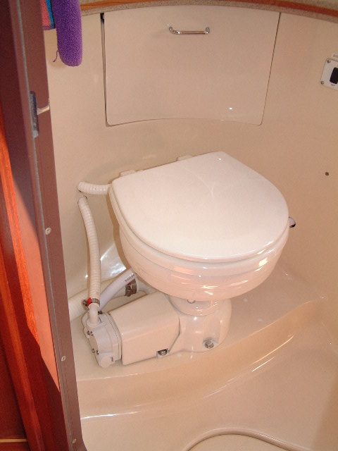

I converted ours to the Jabsco electric that is shaped like an egg. All of the mounting points are identical to the manual as are the hoses. All we needed to do was to run the wires. It seems to be trouble free, and more to the point it's easy for everyone to use.
I had thought to go with the Raritan, but if you measure it does not fit.

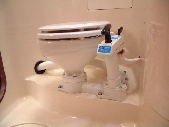

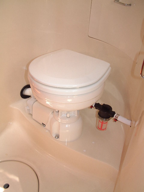

I changed my OEM Jabsco for the Raritan Sea Era this past spring. Very happy with it- easy to use, easy to winterize. Everyone likes it. However, I have a 1997 h40.5 and I easily had space that you might not have. Measure for space and for the hose locations to be sure it will fit. Pix below of Jabsco and the Raritan. I installed the raw water flush model.
The mounting holes were slightly different - used some and put white plastic plugs in the others- not a big deal IMO. I had hoped to install the raw water strainer inside the cabinet but it would not fit easily. I've gotten over that and now I think that the external location is superior for cleaning. Cleaning is a 1-2 times per season in my location. I don't think that the fresh water flush model has the strainer.
