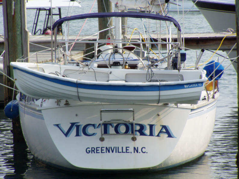

Gary A.
H34 With Davits
We have davits on our Hunter 34 and love them. I'll attach a photo. This is our H34 hanging a Boatex 10' dinghy. I have photos from other angles if you are interested. Gary
