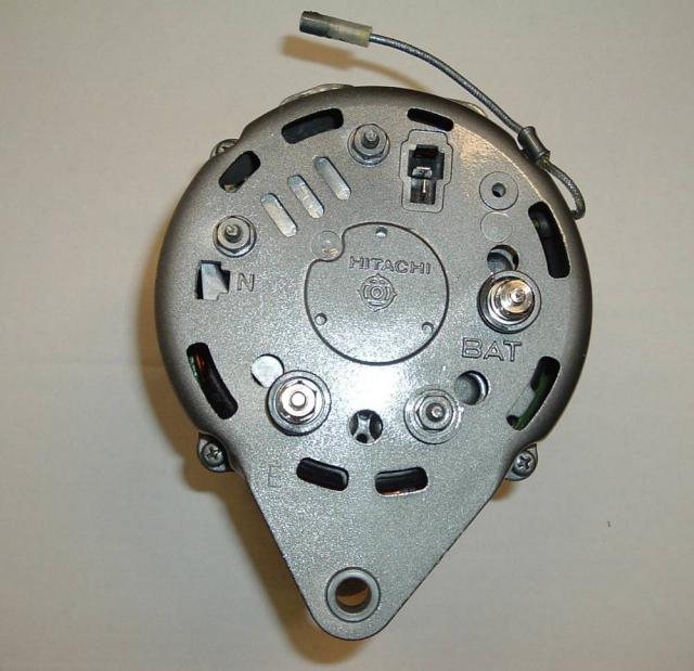

The 60 amp would be a nice upgrade not requiring the expense of a regulator. In this picture( http://www.spidermarine.com/UserData/Images/Large/100438.jpg ), near the top, there is a recess with two spade terminals. One is marked 'L', the other one is 'R'. I ran a wire from the start post on the starter solenoid to the 'L' terminal to get my exciter voltage. In other words there is 12 volts to the alternator just while you are starting the engine. This is sufficient to "charge" the stator field.
I think that I am remembering that right. I cannot find the thread where we discussed this back in 2000 or 2001.
P.S. found a better picture in my files.
