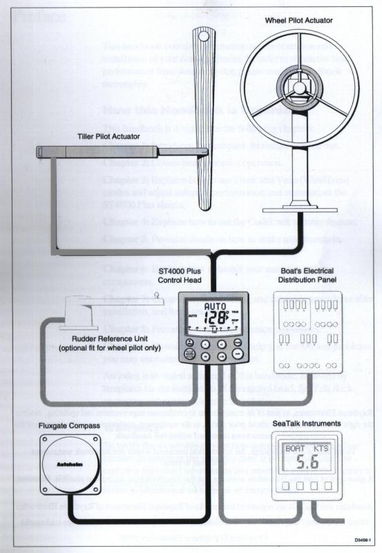

In addition, if you have an Autohelm ST4000 Plus Autopilot, the only sending unit (controller) is the "Control Head" as shown in the attached layout. The fluxgate compass (on ours) is mounted in the bottom of the hanging locker. Only the dark black wiring (as shown) was used in our construction. Yours may be different.

Yes, I was referring to the fluxgate. I have the same Autohelm, but mine is not in the hanging locker, so I assumed it was behind the aft bulkhead as in many of the other models. I have no immediate need to access that area yet, but when you do, it usually happens when you do not have access to extensive tools. So I'll probably make two vertical cuts to open the whole area and finish it with some teak strips, like Hunter did in later years and other models, to provide an access hole near the tank. I do have the original manual as well, but it just meets the minimum requirements of providing something, usually leading to a false sense of security.
