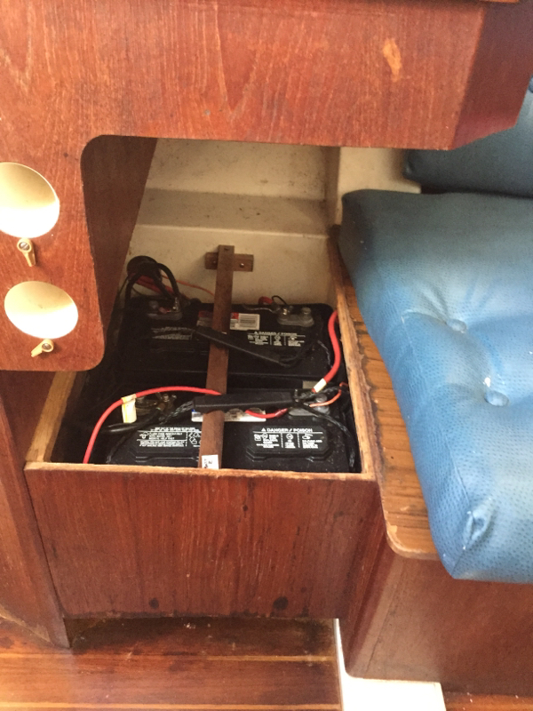

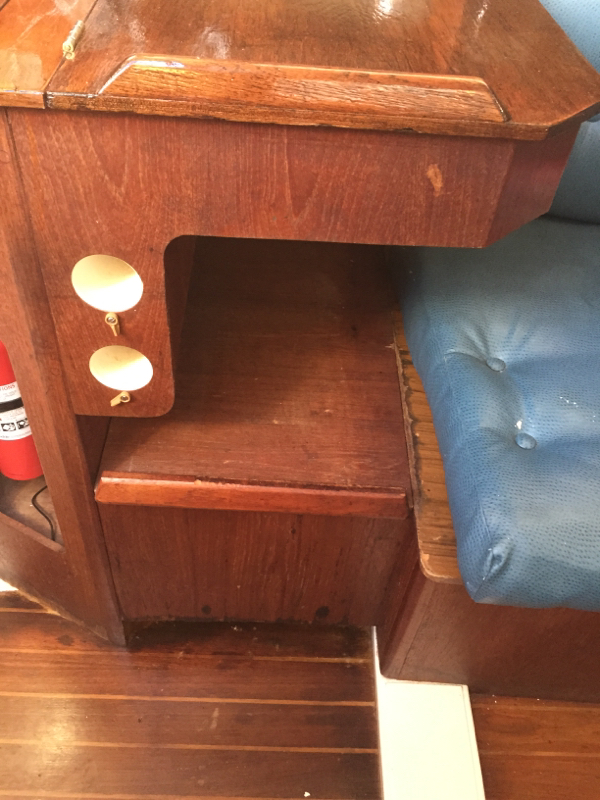

I have a single start battery just port of the shaft just behind the engine compartment and I have two house batteries in a compartment under the nav table. Our boat does not list much to starboard.

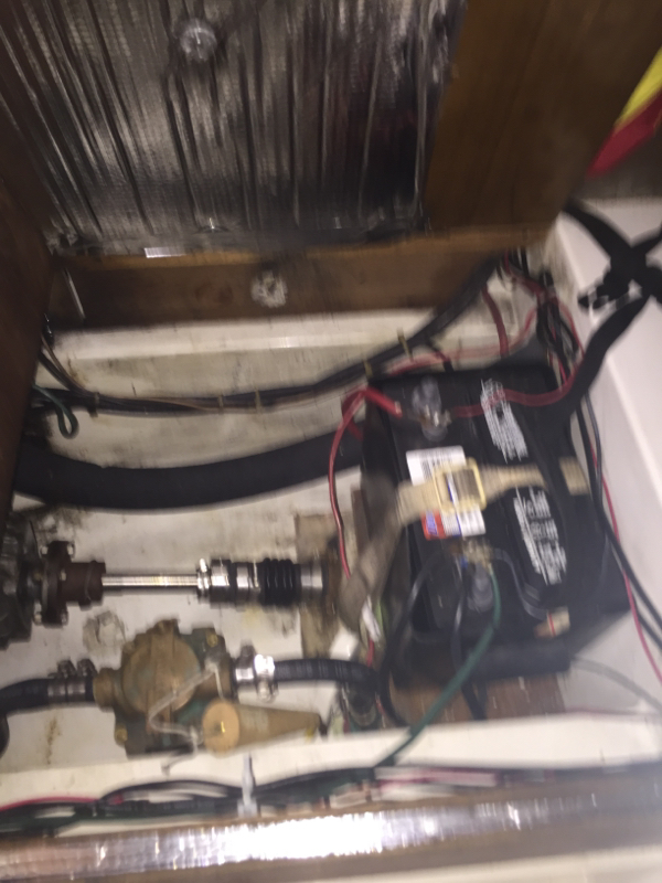

Can someone post a picture of how/where the batteries are mounted behind their engine on their H31?
Both of mine were relocated by the previous owner to the starboard lazarette behind the hot water heater, and I want to see where the were from the factory.

I will try to get by my boat today. Did the boat come from the manufacturer with a house bank of batteries and a start battery? I have no idea what the original battery configuration was, but I sure like mine

I have an 84 31. I have 2 batteries above the shaft log and 1 battery behind the water heater. Under my nav station is empty. No box at all.
Hope this helps.
