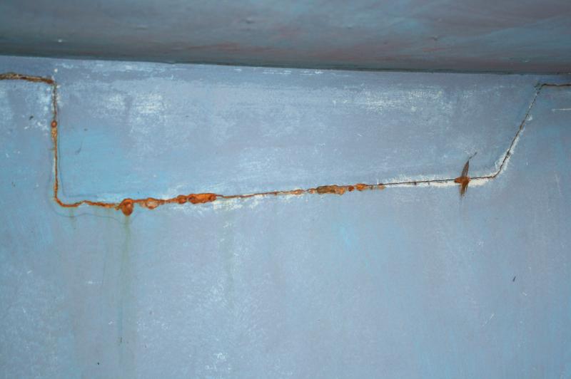

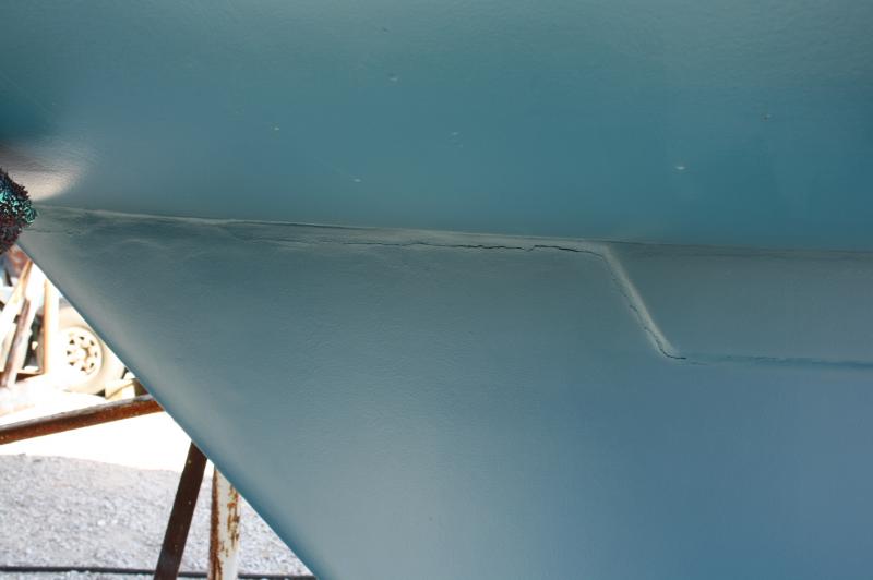

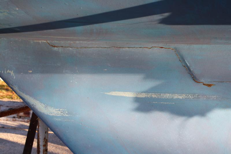

H31 Keel shifted? Anyone ever had this problem and what's the fix? Or leave it alone? Boat was pulled last year and bottom painted. The boat was put back in as the pictures show that our friend took. Does not leak that I know of and I have no idea how long the keel has been shifted like this.
1,715
Hunter 34 Alameda CA
Probably was always that way, but I don't know. The holes that the bolts pass through aren't that much oversized that it could shift that much. It seems that something may have been out of spec originally. The key at the moment is to be sure that the nuts inside the boat are properly torqued. You could check one of the bolts...take off the nut and the SS backing plate and look at where the bolt comes up through the hull. If it is off center in the direction of the shift, then yeah it either moved (unlikely) or was installed originally off center. If the nuts are tight and it doesn't leak use fairing compound next time you haul and don't worry about it.

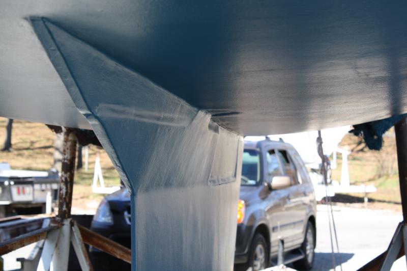

P.S. If you look at the bottom of the hull you see some triangular ears on the keel that fit up inside the hull providing stability. It would be hard to move the keel laterally with those recessed ears up inside a cavity of the hull.

Thank you Allan, that makes a lot of sense. Now that you mention it, I think this boat draws more than other H31s, I remember when I got the boat, it wouldn't fit in the slip because of the underwater brace. The owner of the marina was perplexed because he used to sell the H31 and said that there was no way it should have been hitting the underwater brace! I wonder if this is a keel of an h34 or something?? I will check to see that the nuts are tight. I'm not sure I want to take any of the nuts off while it's in the water?? I would hope that if it was a big problem that the marina would have let me know about it before putting the boat back into the water! If Hunter put this boat together that way, they should fix it! There is no excuse for that no matter how cheap the boat is! Maybe if the keel wasn't tight enough over a period of time, maybe it could have rounded out the mounting holes before it was corrected?? I would like to take some of the nuts off and see what's going on.

I would agree that check the torque on those keel bolts would be prudent. Then just dig out all of that old caulking and re-do it. It think we have seen some of these 83-87 era boats have have had a hard grounding that are much worse than this.

Honestly it looks like the caulking has just deteriorated.

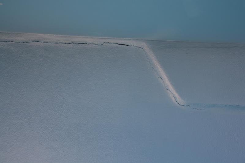

I wish it was just caulking, the keel is off to starboard for sure. You can see for sure that the the interlocking part of the hull is a high spot on port and a low spot on the starboard by about 1/2 inch I think. I'm going to check out how tight the bolts are tomorrow. There is a h31 on the hard and I'll take a look at it also and take some pics to compair with pics of my keel.

I doubt it left Hunter that way
I know Hunter gets a bad rap from some (not me, I'm on my second) but I doubt this was like this when new. Personally, I think this is cause for concern. If you've had the boat out of the water before and this is the first time you've noticed it I'd say it shifted for whatever reason. I can't imagine a surveyor missing this.
I would guess that Hunter beds the keel with something like 5200 when bolting it on. I agree with everybody else when they say to carefully check the keelbolts.
It appears to me to be shifted more on the forward edge that the aft edge. If it is not true to the centerline this could cause issues on one tack. Do you notice that she likes one tack significantly over the other?
It also appears to me that there is a significant amount of bedding at the forward edge, much more than on my 33.5.
If it was me I'd devise a way (strings fore and aft, etc.) to determine if it was cocked along the centerline. I'd also have a Hunter tech check it out. If all is determined to be ok, fair it in and forget it.

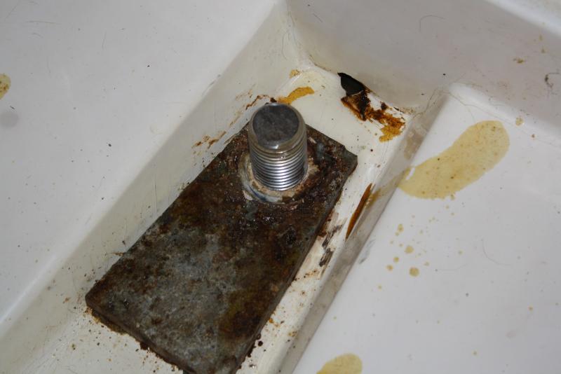

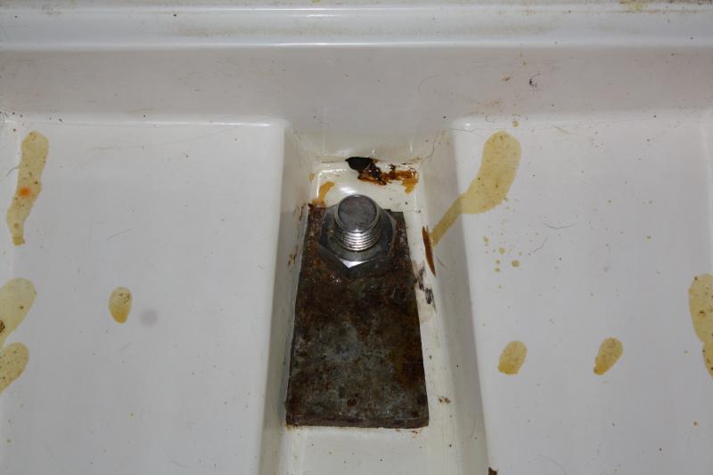

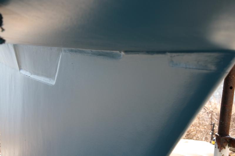

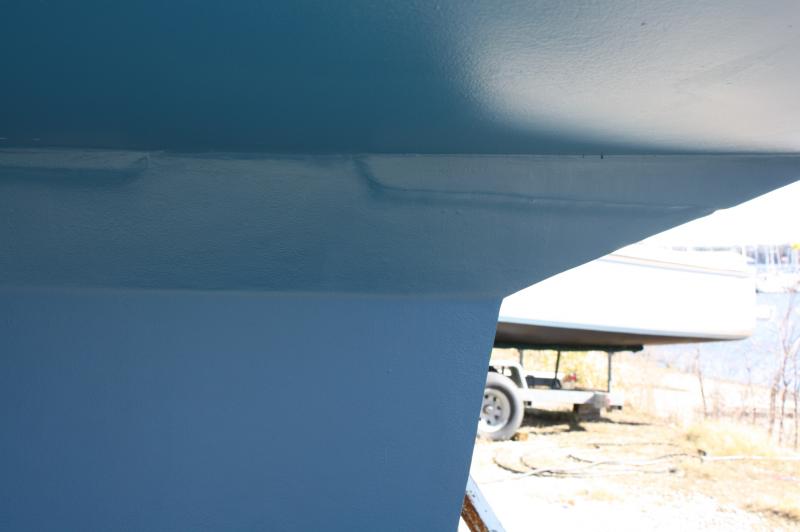

I checked the keel bolts and they seem tight. I did manage to take off the nut on the rear stud by usine my legs on a big crescent wrench. Couldn't get the big metal backing plate off, so I can't see if the holes are rounded out, but you can plainly see that the bolt is off to the starboard side of the boat in relation to the bildge pan. I can't see signs of a recent shift. I bought the boat in '06 in the water and didn't question the bottom because I bought it from the dealer who had recently hauled it out and painted the bottom etc. This last time, the boat was hauled out and painted by another service and they put it back in without mentioning that the keel was shifted, so they must not have been too concerned about it. See the pictures below and let me know what you think.

Mine is like that too. Every spring after sitting on the hard it bleeds rust from the joint. This year I went right to the gelcoat all the way around, and in the bilge area on starboard side there was close to 1/2 inch build up of epoxy to match the keel. Port side there was none. Same at the bow one side even other side built up with epoxy. In my opinion there is no way mine could have shifted as 4 of the 5 bolts have a tab that sits recessed into the hull. I am going from the hull down about a foot or so and am glassing the whole joint and hopefully eliminating the constant weeping. As a side note it seems that the keel joint had an epoxy between rather than say a flexible agent such as 5200. I was able to chip a good portion out very easily. Seems the keel rusts and the epoxy no longer adheres. I hope this solves the annual bleeding of the keel joint. Now just to stop the pocket book from bleeding!

Yup. Pretty much identical. I think when they built these things the faired the joints to compensate for poor fit, but I wasn't there so can't say for sure. If you pass along your email I can send pictures of where my project is at. If you want to pm me or what ever you prefer.

I would like to see pix of your keel joint project as I'm going to have to tackle that project soon myself. Here in the picture of my aft keel bolt, looking aft, you can see that it's off center. It doesn't look obvious to me that the bolt and backing plate has shifted, so I wonder if you might be right that it left Hunter that way. I can't get the backing plate off to see if the hole for the keel stud has been elongated. I would think that the hole would be very close to the stud size... shouldn't be much of any slop for it to shift from the factory? My e-mail is sail902@windstream.net Thank you!

This is known as...
the "Hunter Smile". It is common to the H31 and H34 production runs. I have pix of my keel and other h34's that look the same.
Allan covered it. Scrape it clean, fill it with epoxy, 5200, or fairing compound, repaint, and go sailing!
