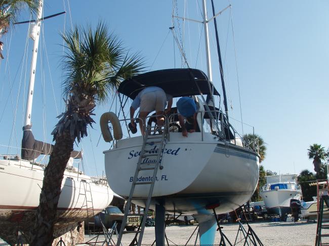

I have a H31 and it was rigged for raicing so it has some rigging that bends the mast to de-power. Not sure what its called.I dont race... slow is good.Can I pull this rigging without any problem? B&R rigging does not need an aft stay. Like to get the extra cock pit room and can use the stainless for new lifelines.What do you think.
