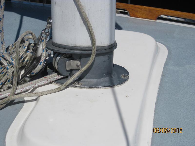

I have a 1981 H30 and will be dropping the mast when the boat comes out this fall. I need to know if the wires plug together inside the base of the mast. I attached a pictire of the base.

I have a Hunter 31 and all my mast wires have male/female disconnects inside the base of the mast. There is usually 3-4 inches of extra wire length to allow you to raise the mast a little and get your hands under the suspended mast to disconnect the various wires.
