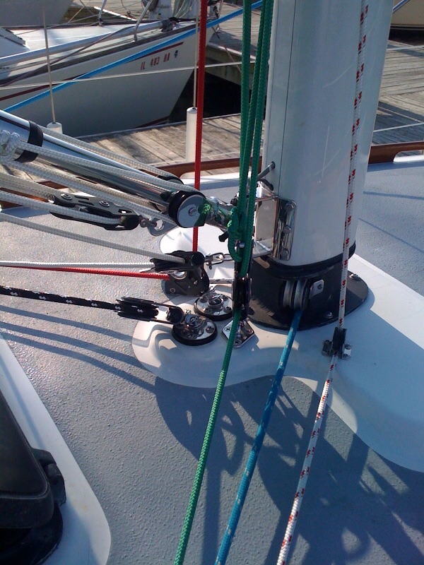

Riverbouy,
Does your mast base look like this one? Assuming Hunter did not change the mast base design between '77 and '82, the base sleeves up into the mast about one inch. It's right at the bottom bolt on the vang bracket in the attached image. Standing rigging is all disconnected at the time the cranes lifts the mast, but not before. If your coax connection is where mine is, you need someone holding the base of the mast so it doesn't swing while you unscrew the coax. Putting fingers under a suspended, heavy mast is risky. Best to use pliers for that job and keep the fingers out of a potential guillotine if the mast drops unexpectedly, which I have seen happen when a crane operator's lashing around the mast slipped.

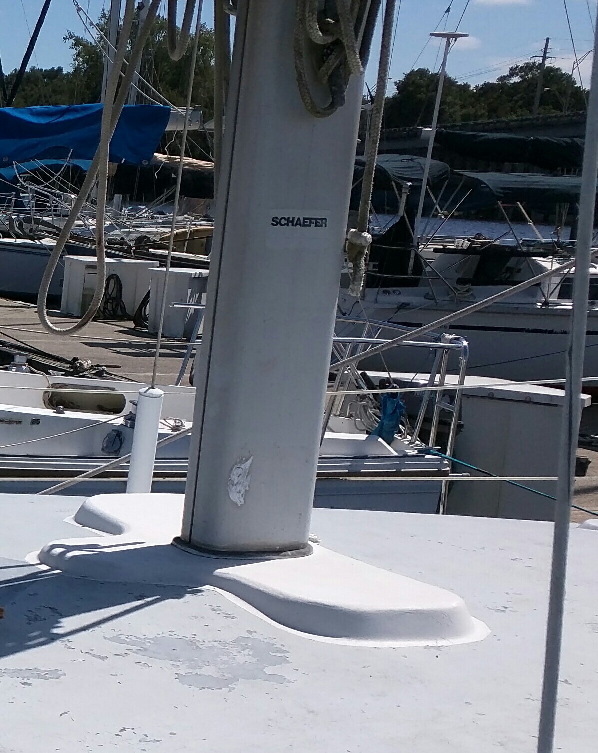

Dalliance, thank you for the response. My mast appears to rest directly on the deck with no screws visible, see attached photo. The VHF wire appears to come through the center of the mast while the connection is about three feet inside the boat. I am worried that it will get hung inside the boat as the mast is raised. I'll likely have someone in the cabin feed it through.
Riverbouy, I think the mast itself does not actually sit directly on the deck. It looks like a simple cast aluminum base plate, likely with a few screws inside to anchor it to the deck and some kind of upright flange to prevent lateral movement of the mast. You are right to have someone inside the boat to feed VHF connection through.
This is probably right because he has an earlier-Hunter Schaefer spar. I was sorry to see them go!
The drawback to the mast-step system Riverbouy seems to have is that there's nowhere for a through-pin in it, which I would advocate to anyone racing or going anywhere offshore. Even if one of the shrouds (especially if two) were to part, this could become a problem without having a mechanical connection between spar and boat.
