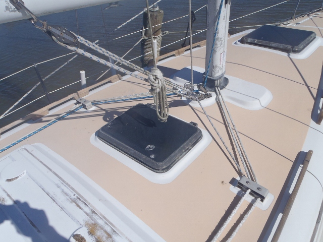

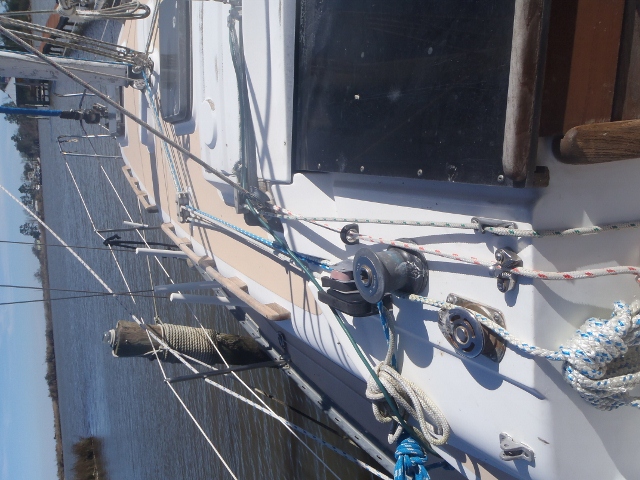

I hope these photos help you get an idea of my running rigging setup.
Basically, I have halyards, outhaul, traveller, etc. led thru deck organizers to rope clutches, fairleads and cam cleats, all ending up on the cabin roof on either side of the companionway.
On the port side, the main halyard, main outhaul and traveller line, and on the starboard the jib halyard and the boom vang.

Thanks DB, these images are very helpful. I wasn't aware that "double decker" stack organizers existed - those will help. Also, it looks as though you don't normally use the winch for the mainsheet (red/white line??); instead, it just goes to a cam cleat and you trim by hand most of the time?
And whats the round SST device on the aft end of the port cabintop? Not seen one of those either.
