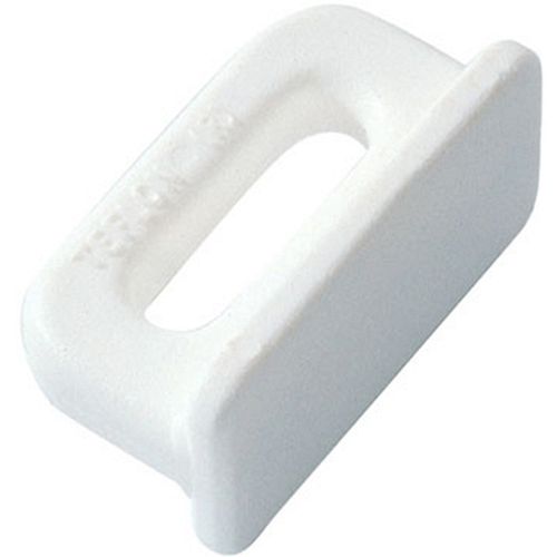

There had been alot of mods done to the sailboat over the years so I would believe this is aftermarket. This is the best I can do now.
These are sewn on the luff for the mast and on the foot for the boom.

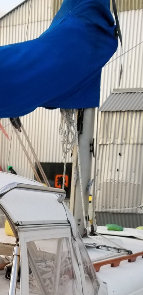

You can just make out a shackle at the bottom of the goose neck for what I believe was for a down haul. I would have to come up with some block/tackle mechanical advantage but I have open clutches on the deck to accommodate it.

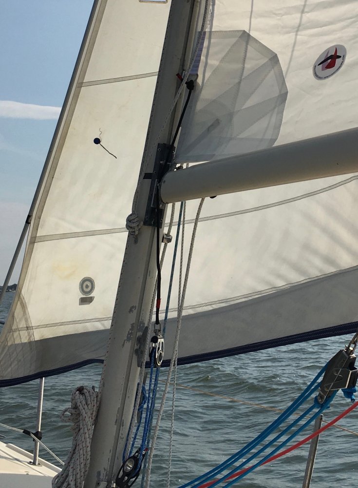

I hand sewed a SS ring/strap to the main sail along the luff about 6"-8" above the tack cringle. www.sailrite.com shows how to do this in a video on their website.
I tied a line from the ring down to a two block setup for a 4-1 purchase. Here is a photo.
The blocks are what I had laying around. I ended up with the line tied to an eye on the mast. It ran up through a small block on the Cunningham ring, then down to a turning block on the boom and aft to a clam cleat with keeper about mid boom. I think it was a 2-1 purchase?
Having the line run back on the boom allowed me to tighten the Cunningham while standing in the companionway of my 25. This system worked real well.
I don't have a Cunningham on the main sail of my Catalina 30. I'll be doing the same thing this winter, sewing on a strap with ring. I'm planning to rig it the same way but with a 4-1 purchase.
