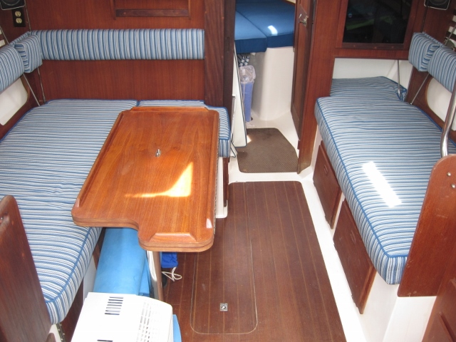

I expect that my 1980 36 has the same table pole and fittings. (Picture of mine attached just to verify/compare.)
I haven't had the pole stuck problem, but while on the topic of:-
Several years ago, when I removed the tube's base fitting while refinishing the cabin floor, I noticed the beginning of cracks in it.
So just a thought that you might also take a good look at yours for signs of weakness. The material I would guess is maybe an aluminum/zinc alloy of some sort. With moisture settling down into the cup, a bit of galvanic corrosion might also be occurring. My base piece did have signs of pitting.
I had just assumed that a new one of these fittings would be hard to come by. So I didn't look and instead went the DIY repair route. I forget now the details of how I actually did it. But I do remember that I turned the fixture upside down on a work bench and sanded/cleaned the surface. Then I put over the fixture's "cup" a round plastic container with a diameter somewhat larger than the diameter of the "cup" and from which I cut off the bottom. Then I filled the area with several layers fiber reinforced West Systems epoxy. The several layers so to avoid a large volume of epoxy from kicking too fast and overheating.
I also reinforced from the top by gluing and screwing down a piece of metal sheet.
I'm sure other alternatives for fixing (if in need of) can be thought of.

Yes, that's the same leg(s) I have - I just have two and one is stuck, You're fix looks great.

rardi, is that a non-standard table? It looks smaller than mine
Hi Actel:
Yes it is smaller. Actually we two have broached this subject before:
http://forums.hunter.sailboatowners.com/showthread.php?p=1130562&highlight=table
But to provide some more background: When I brought the original table home a number of years ago to try to repair/refinish the damaged surface, my wife and I noticed how much bigger and less crowded the whole salon area felt without the table in it. We use the boat almost always for day-sailing, so a large table wasn't really needed most of the time. So I made the smaller replacement you see in the picture. Large enough for putting down sandwiches and beer and potato chips for two. The original table it turns out is easily wedged out of the way over those side shelves in the v-berth area. And the new large shelf that it makes in that spot is great for storing soft stuff like sleeping bags. For those times we might want to use the original table (either as a table or to convert the starboard seats into a bed), the table is easily retrieved without fuss. Turned out to be a good modification for us.
