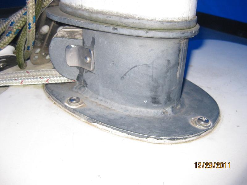

Well, I bought the boat.. It needs a good cleaning and eventually the Micron orange peel sanded off the bottom.. The boat was shrink wrapped and I didn't even consider trying to squeeze my fat as* thru the small zippered opening, so my son went in and checked over everything using a flashlight. He gave it 2 thumbs up even if it is "an old mans boat". It has the 15 hp Yanmar, CDI furling, and what I think is the most important, a T cockpit. It seems like every H30 I look at is different, for a production boat it seems a little strange. The mast on this one appears to sit on an aluminum base. I haven't seen this on any other boats.

This is the same style mast base as my 82 Hunter 30. The Hunter 30 is a fun boat. Handles well in light and moderately heavy winds. My wife and I have found it comfortable below and above for two for weekend sailing and anchoring. Hope you enjoy it, too.

Interesting. The mast base on my 1980 H30 does not look like that at all.
