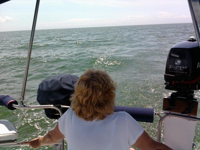

Mine is between the port side stern seat and the upright of the opening for the walk through. Motor is a 3.5 horse Nissan that hangs over the propane locker on the stern. This restricts the lid opening but not a big deal.
319
Hunter 29.5 Gloucester, VA
I made one out of AZEC which is similar to starboard and a piece of Mahogany. It is attached with stainless U bolts. Has been fine for the last several years. the motor is a 4hp Merc

319
Gary it was made very cheaply from scrap. The stainless U bolts are from Lowes, about 1/3 the cost of WM. You could even use plywood if you seal it and paint it well and replace every few years.
