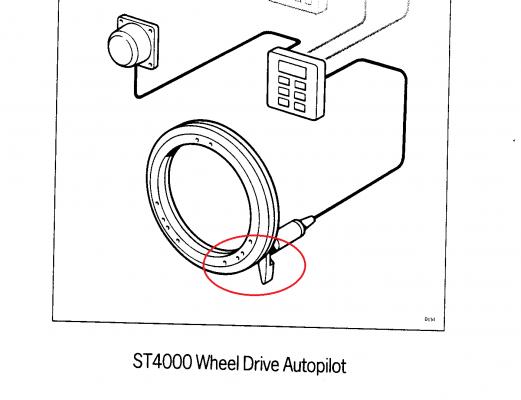

BTW, I'd love to add a lock; can you possibly make a couple of pictures showing where it is mounted; how large an access hole; etc.? It would be most appreciated.
Thanks,
Clark
Thanks,
Clark
The wheel lock is part of the AutoHelm Wheel motor arrangement. I will take a photo when I get back out to the marina, but the small lever on the wheel drive unit in the diagram locks the wheel (at least I hope that is what it is for...it seems to work).
