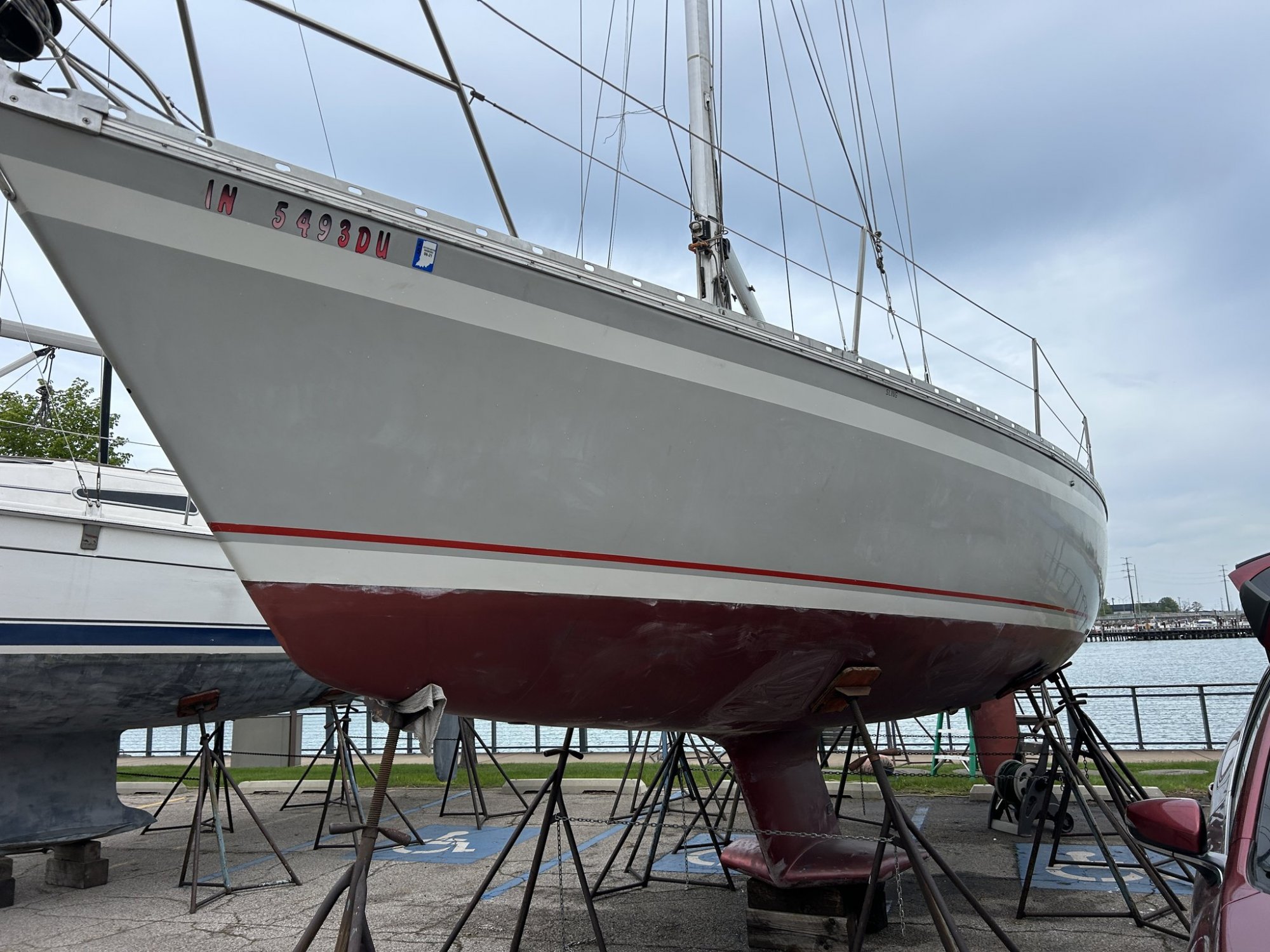

How bad is the bottom?
It looks like the yard wants to remove the barrier coat and reapply (Interlux 2000), then apply the anti fouling paint.
My 38 year boat was painted with several coats of barrier coat, and has never been repainted (except anti foul).
So, I would wonder why it need the barrier coat reapplied.
Also, what are they using for antifoul? On the Great Lakes, VC17 is a decent anti-fouling, goes on very thinly, does not need to be sanded off to reapply, and will dry in 20 minutes or less.
Greg
These shots are my “touch up” of VC17 this spring. I can get 2 years out of a full repaint, and then just touch up on the 2nd year.
