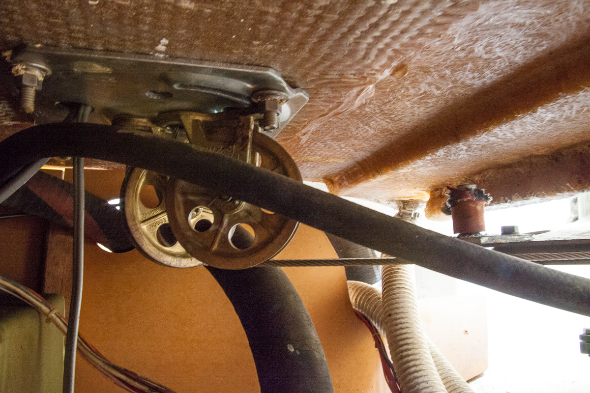

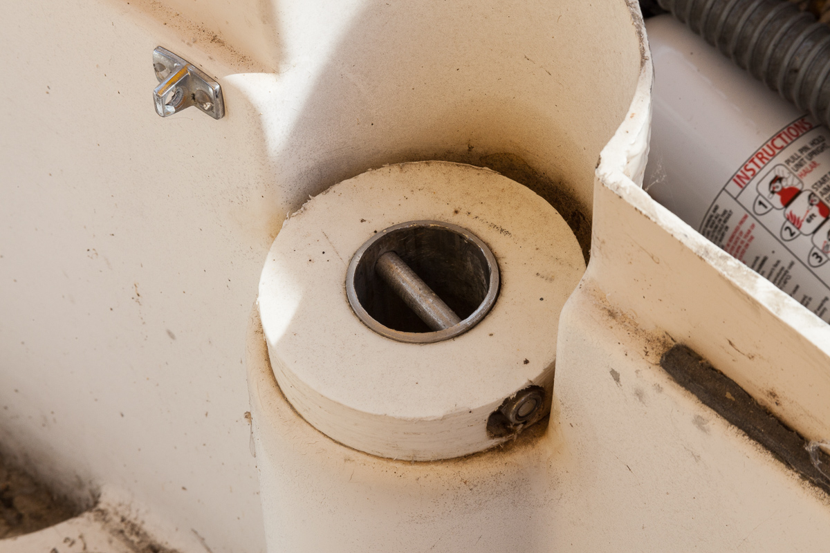

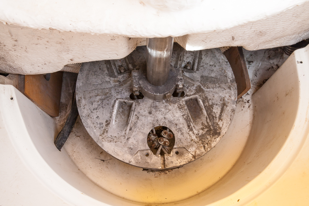

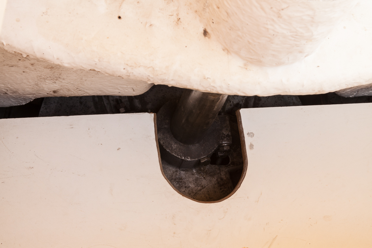

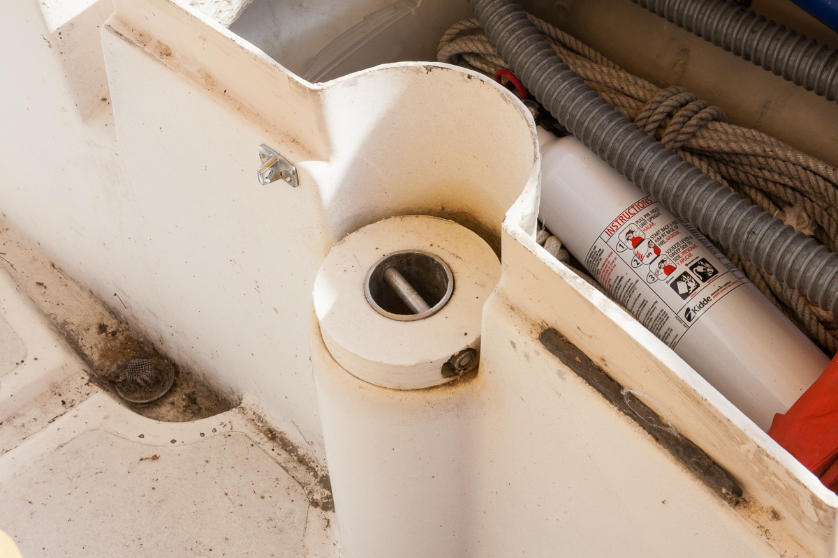

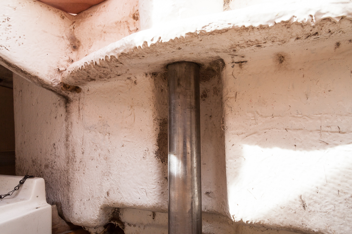

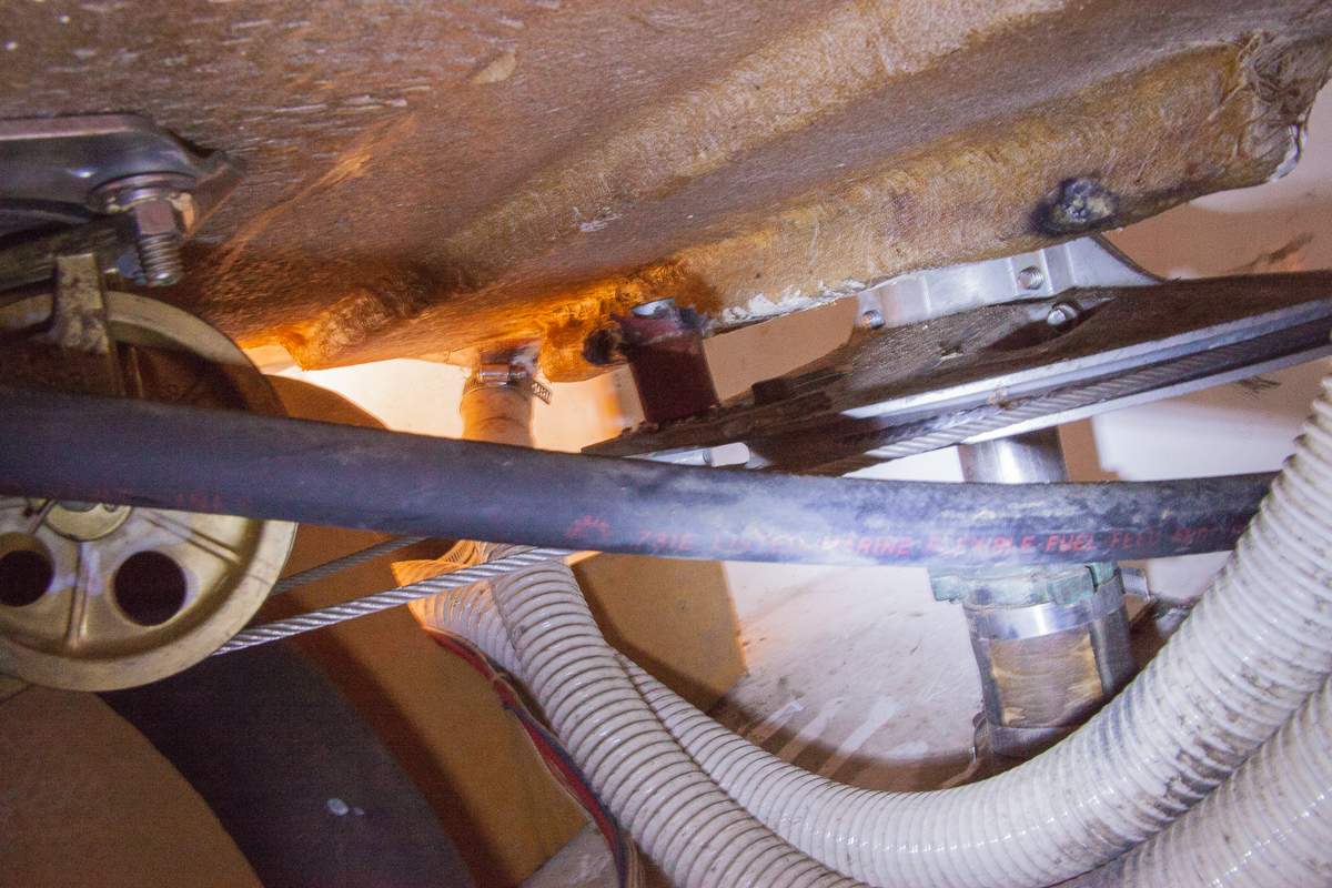

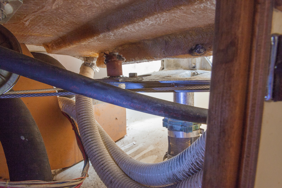

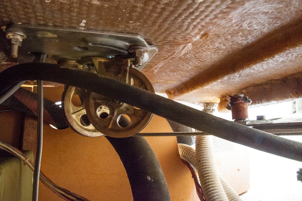

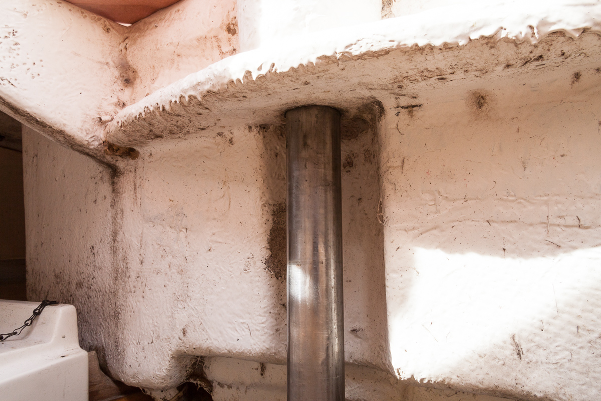

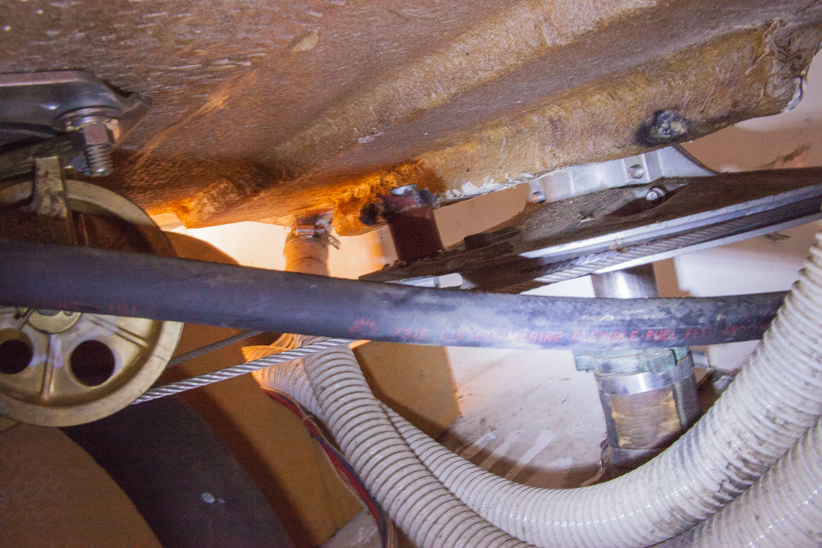

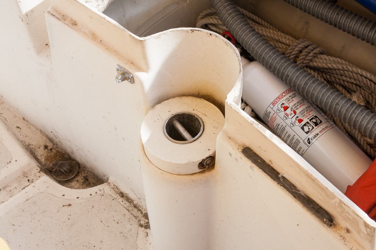

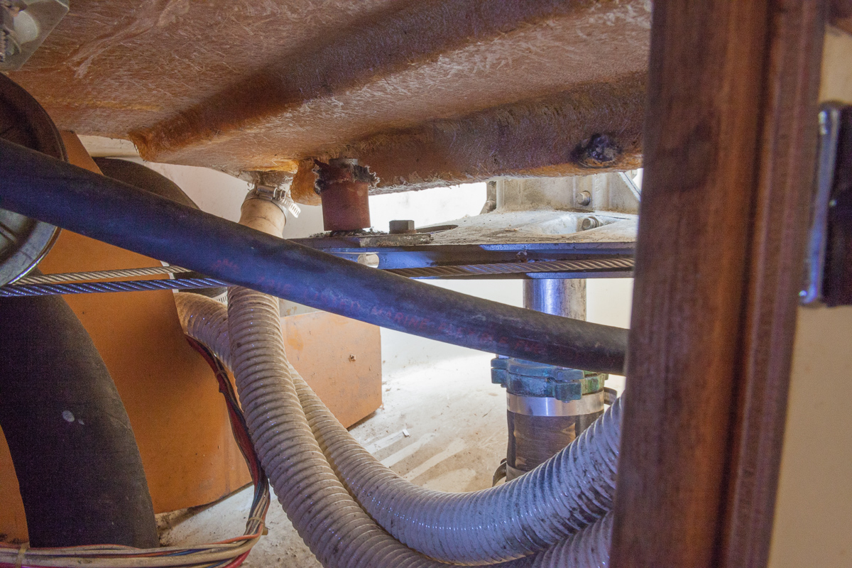

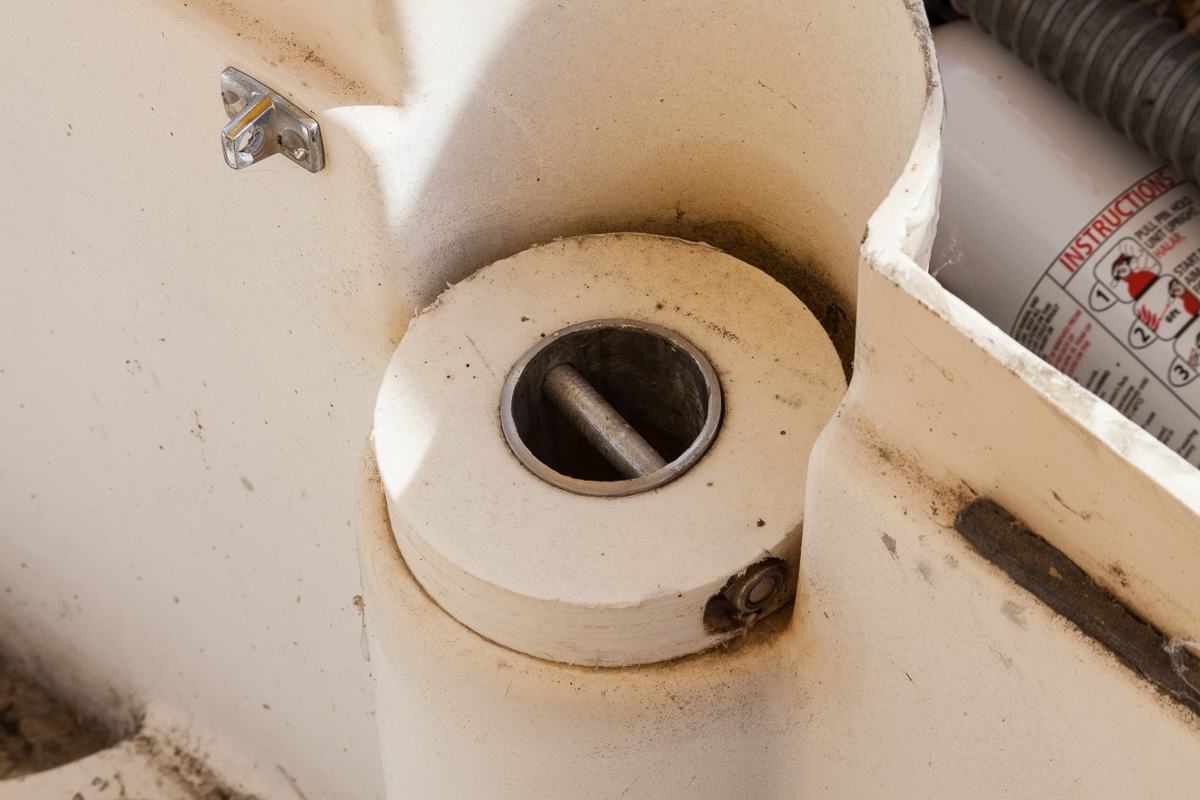

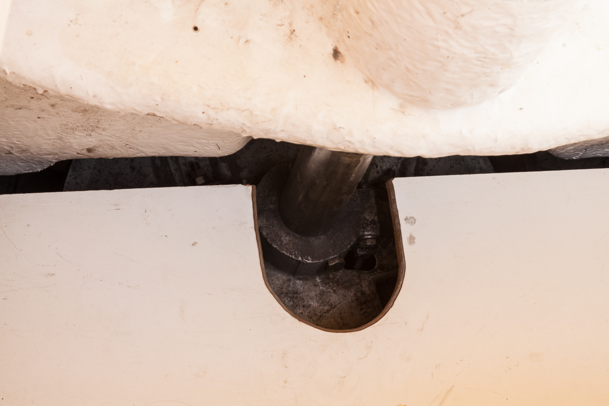

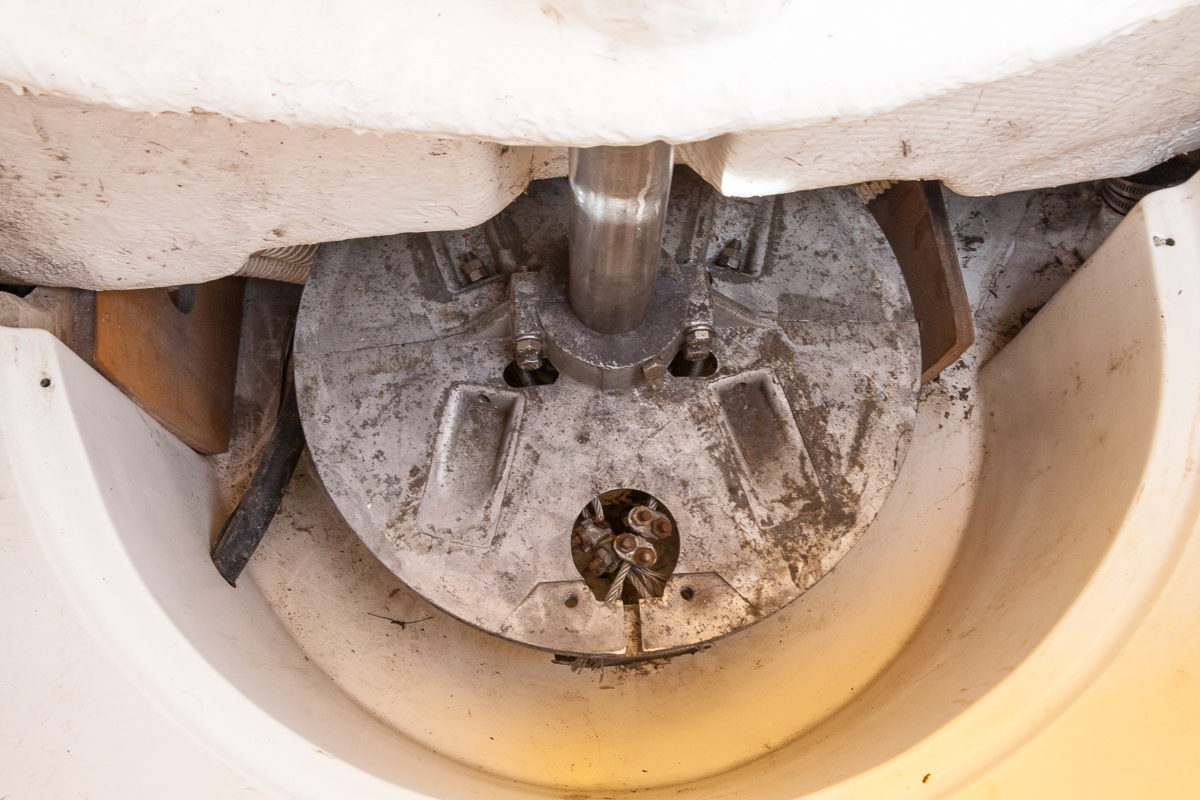

Mine leaked before but not now, sounds like something is missing at the top - a bushing or something - it shouldn't be loose. I didn't actually do the work, so I can't say off the top of my head, but sounds like a good excuse to go to the boat and get some photos.
Hatches are available here through SBO, but will take a little work to enlarge the opening to get them to fit. It's a fall project that I am working on.
Jan 24, 2009
450
1981 Cherubini Hunter 27 Shipwright Harbor Marina, MD
Hopefully these are of some value, not sure what you meant by "loose at the top", possibly the white HDPE piece at the top of the rudderpost was not installed? I didn't see anything else at the top that looked like a bushing or spacer, etc.
