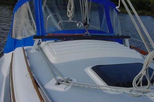

My Main Cabin overhead hatch has broken 'dogs' and can not be secured tight enough to prevent water leaking. While I have seen some great repair/replacement information on the forward trapazoidal v-berth hatch I could not find references to the similiar hatch in the main cabin. I wonder if there are other effective 'dogs' or closure devices that can be fitted. If not what are my replacement hatch options?

Bob, I purchased Bomar model G927-1100 hatch with screen that was a direct replacement for the original. See the link below for the Pompanette www site. Regards, Fred.

If it is just the dogs that are broken, West Marine has replacement parts for the old Bomar Hatches, though at a pretty steep price

I couldn't find a diret replacement for the trap. shaped hatch so I replaceed it with a square on. If you wan me to e mail you a diagram and step by step instructions Nelsonhow@netscape.net
