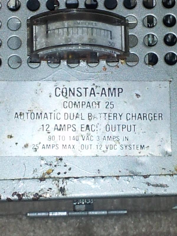

Below is a picture of the original ( I think) Automatic Batter charger... also it has one lead for Ac plug..
I have a 35 amp Hitachi alternator and I need to replace this item .. the Ac side works but do-sent charge batteries any longer...
If any one can help me with that item I am looking for.. whats it called maybe the largest size I can use.. for 1gm alternator..35 am... I am looking to have four ac plugs in my boat.. (not for use at one time).

Well to begin with the alternator and inverter charger don't really have anything to do with each other.
The real questions to size an inverter/charger are:
what AC and DC appliances do you use at the dock? charger for sure, water heater?, reefer? etc
What is the size of your house bank and starter battery?
Do you live aboard, weekend sailor, daysailor, how do you use the boat?

CC 30 South Florida
