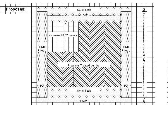

I have serious compression post problems... The bottom 2 inches is missing...The problem was caused by water coming in through the wiring at the mast step. Of course it is the worst case scenerio...COMENTS REQUESTED!I am currently in the process of rebuilding the cabin floor...Nest step is the compression post. I am going to go with replacing it with treated lumber, laminated for stability as illustrated in the attached "picture" That is unless somebody tells me that I am crazy (stupid, uninformed, whatever) for doing it this way...Next step will be the core around the mast step... more on that later in the project...I will post pictures if I can find my digital camera... The kids may have hocked it to buy drugs or pay tuition....And yes I am extreamly envious of those of you are ready to splash....
