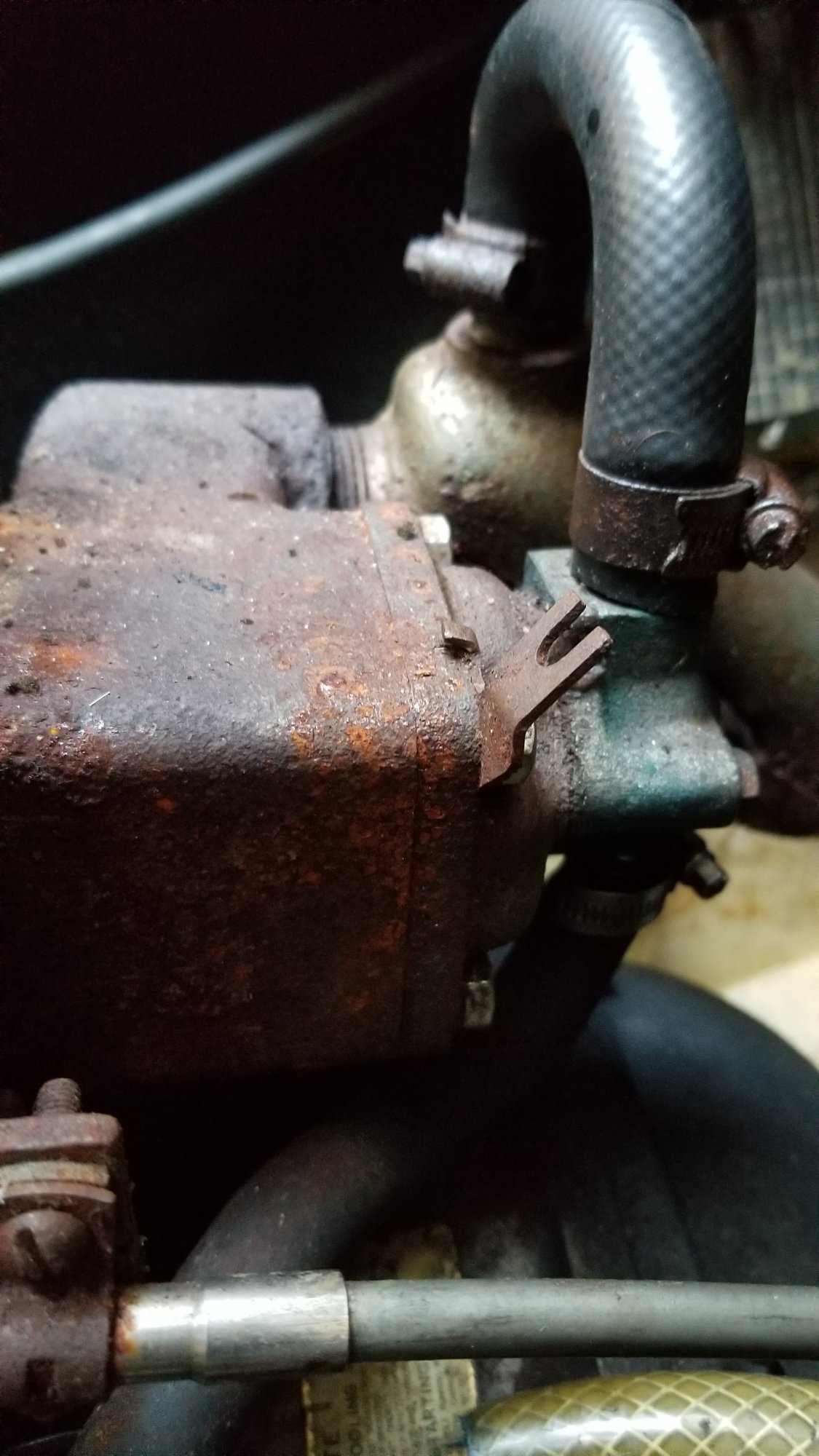

#1 Yesterday, I inspected impeller it seemed flexible and intact. I cleaned off old filter material and installed new gasket. I detached intake line from sea cock and cleaned inline sea strainer filter and re-filled strainer with water and thought I primed hose line with enough fresh water. I also ensured all hose clamps were tight and placed hose in 5 gallon bucket of water. Still no uptake of water, took off impeller cover off again and turned her over to be positive it was spinning and impeller didn't detach from hub.
Sounds like air leak or worn impeller to me, any other ideas? If water pump was bad would impeller still spin? I disconnected hose immediately after cooling water pump should water that I primed with just drip or flow past impeller maybe impeller is worn even though still intact and flexible. What product should be applied to new paper filters, is it a specific type of grease? I couldn't pull out old impeller out I tried but was getting to dark. I saw there are expensive pullers but also saw long nose pliers with a 90 degree bend should work. Going with pliers before buying an actual puller. There is no set screw correct?

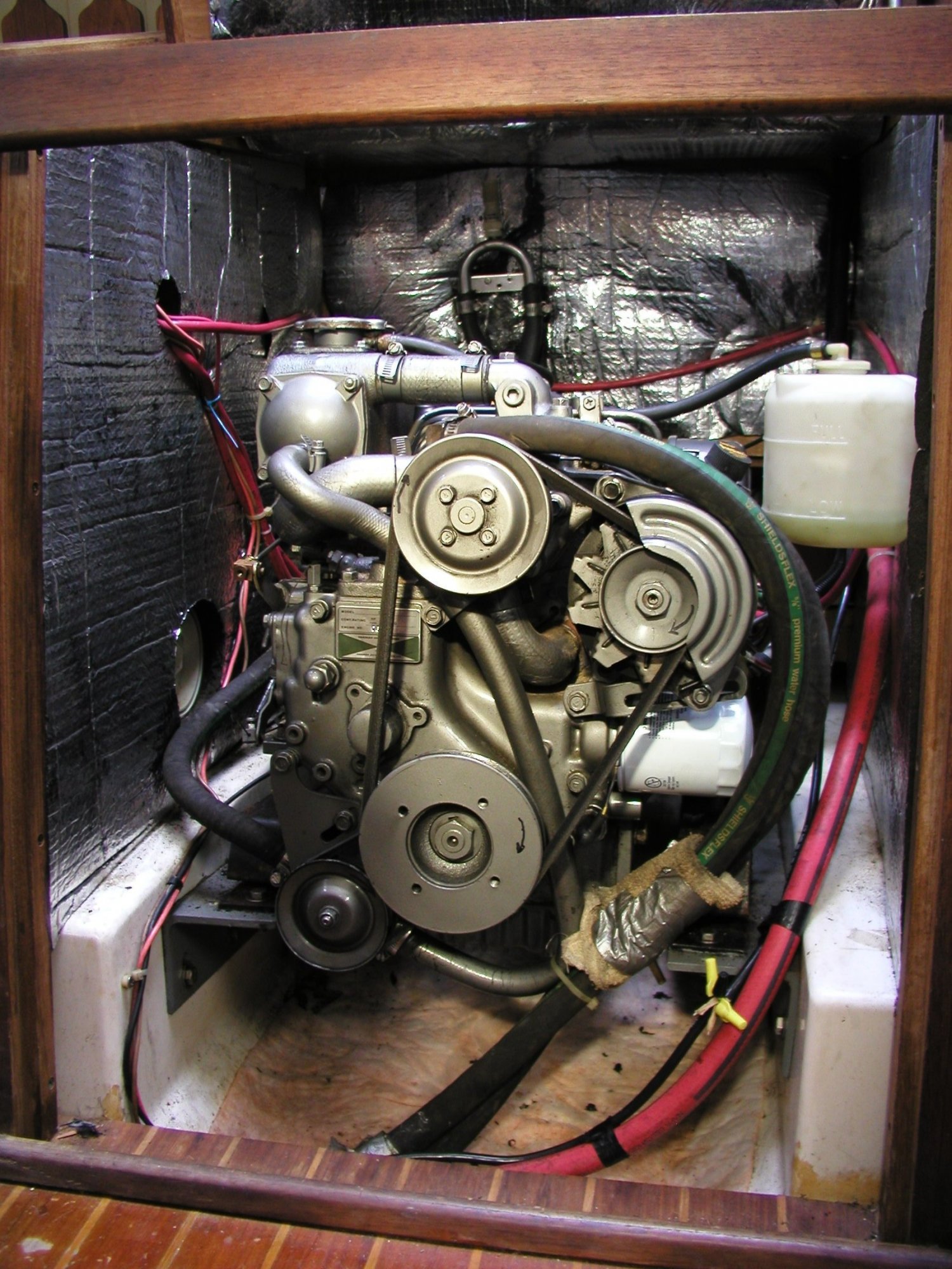

Your approach sounds fine.. Is there a raw water strainer before the pump? sometimes a very small air leak will cause the pump to not work.. Measure the width of the impeller and make sure it is exactly the same dimension as the depth of the case.. the tips have to be in contact with the ID of the case, but the sides of the impeller also have to seal against the bottom of the case and the pump cavity cover.. The gasket should be a very thin paper and not cardboard or cork.. There is no set screw holding the impeller on the shaft. A light coat of silicone grease on the impeller and in the case will help it get primed without toasting the new impeller. Sometimes the cover plate can get some wear in it that allows an internal leak.. You can polish the grooves away or if the cover is symmetrical, reverse the cover to put a new surface against the impeller..
The exhaust should go from the elbow to a "lift muffler" then to the hull outlet. If the engine is cranked without starting for a fwile, water can fill the muffler and back up into the engine.. The water outlet hose to the elbow should rise to higher than the elbow (above the outside waterline) with a "vented loop" at the top which prevents water from siphoning and filling the muffler and back flooding the engine ..
I am not familiar with that exact engine installation, but in general these are probably useful observations.. Picture is of a vented loop (check valve in the top to let air in but not water out) On the back wall, the little stainless semicircle is the vented loop.. Outside waterline is about at the lower line on the coolant catch tank.

The YSB 8 and the YSB 12 are one cylinder, flat (pancake) engines and usually sit in the Hunters below the muffler and the exit thru hull. The thru hull is above the waterline, except when motoring. Hunter did not put a vented loop on any H 27 or H 30 of that vintage that I have seen.
Might be a good idea though.
And Kloudie, that is a very clean installation in your pic.

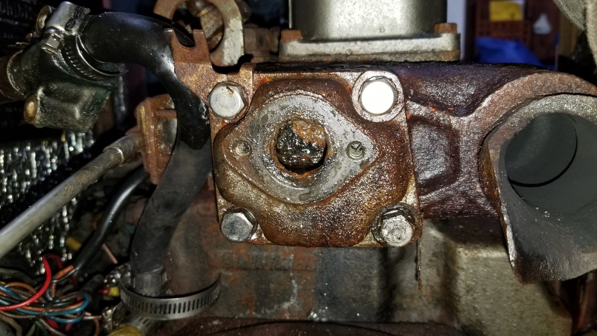

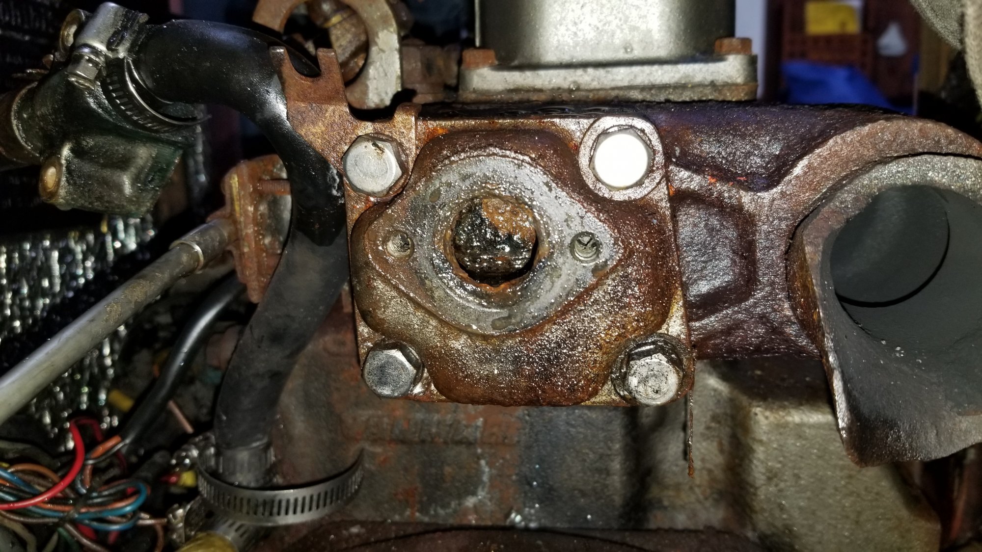

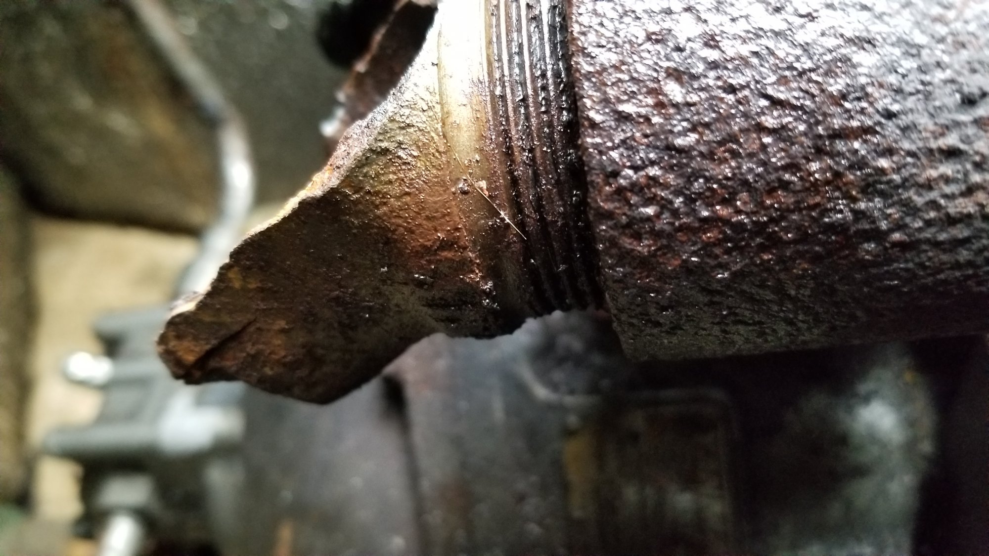

Thank you everyone I was able to push through some antifreeze for the time being. However when removing the mixing elbow which was already compromised broke while turning with pipe wrench
Nov 5, 2019
54
Hunter 27 Jones Creek
I have tried multiple sprays of liquid wrench and now some heat still will not budge should I remove the square squats silencer manifold that the mixing tube and the thermostat housing is screwed into and work on a bench or maybe see if I can crack the rest of the mixing tube.

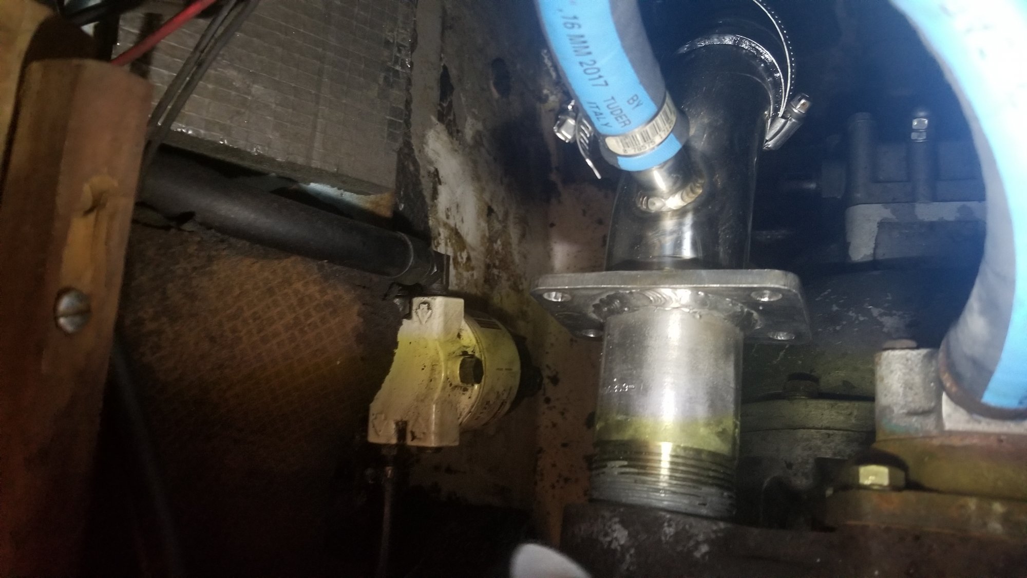

So I was able to procure a water mixing tube off off ebay. A guy is making them to fit the yanmar sb8. I was very satisfied with fit and cost.
