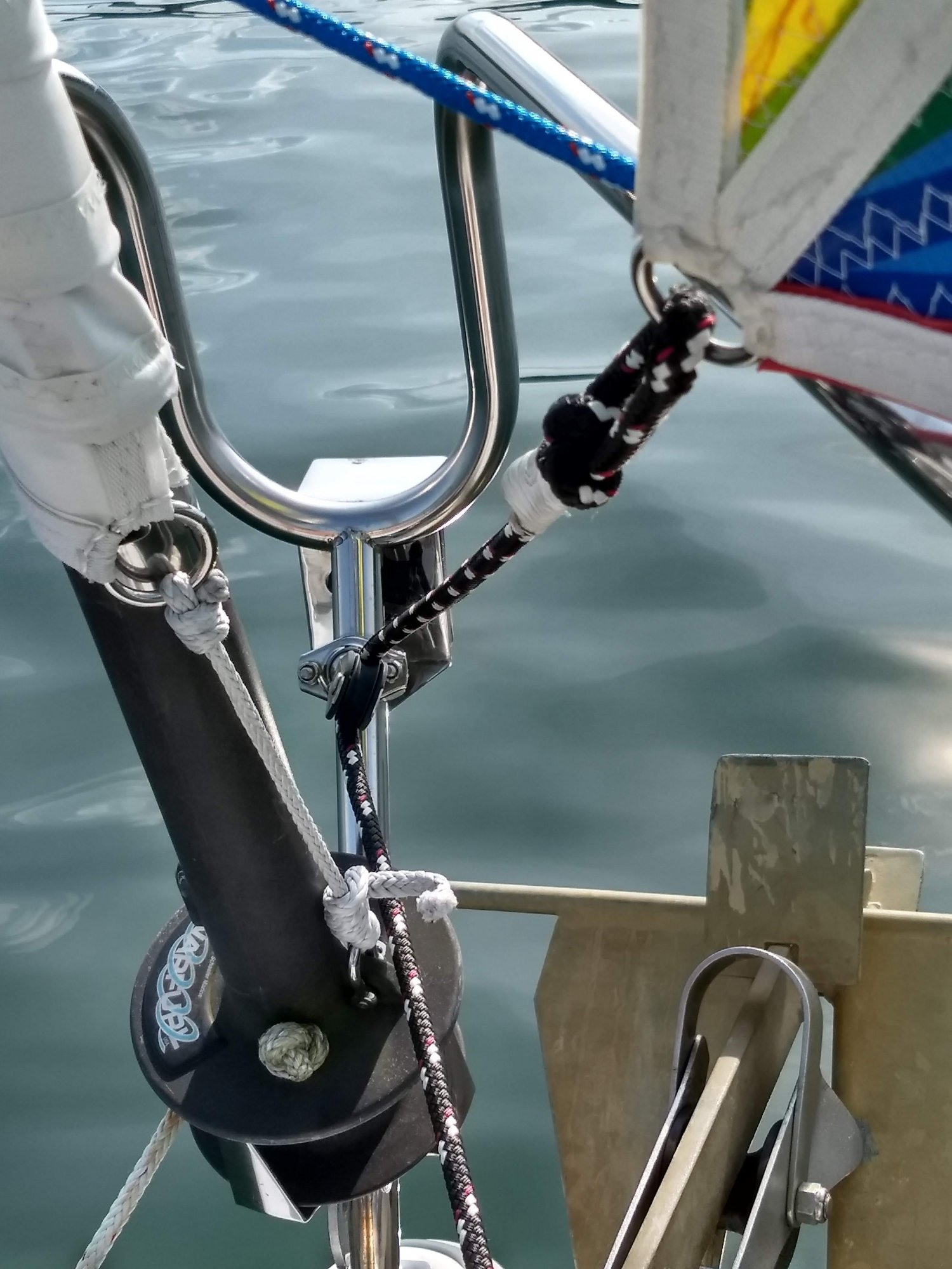

If you mean the tack (not clew), here's a picture of the asymmetric tack on my H240. Harken block on the bow rail, just below the running light, leads the tackline back to a cleat on the cabin top for adjustment.
I’m NOT an expert on anything sailing but... I’m surprised that works for you. I always set up everything spinnaker-related on the out side of everything. Your tack is inside of the bow pulpit and I see a blue line outside of your spinnaker. My system is not “dog-tested, dog approved” but it seems to work. I have a shortish line with a block that runs on it in the mast crutch. The tack goes down through the block and back to the cockpit. Maybe @BradH23 can take a picture of it the next time he’s at the club and post it here.

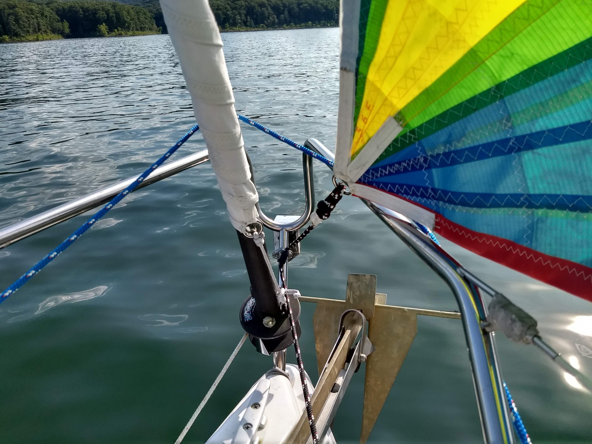

Here's a better picture- that blue line is the port spinnaker sheet. The spinnaker flies above the bow pulpit, and everything is outside the jib furler. Had it up yesterday, you can see the typical summer wind conditions here in Ky!
I realized both of those things after hitting reply. I like it!!

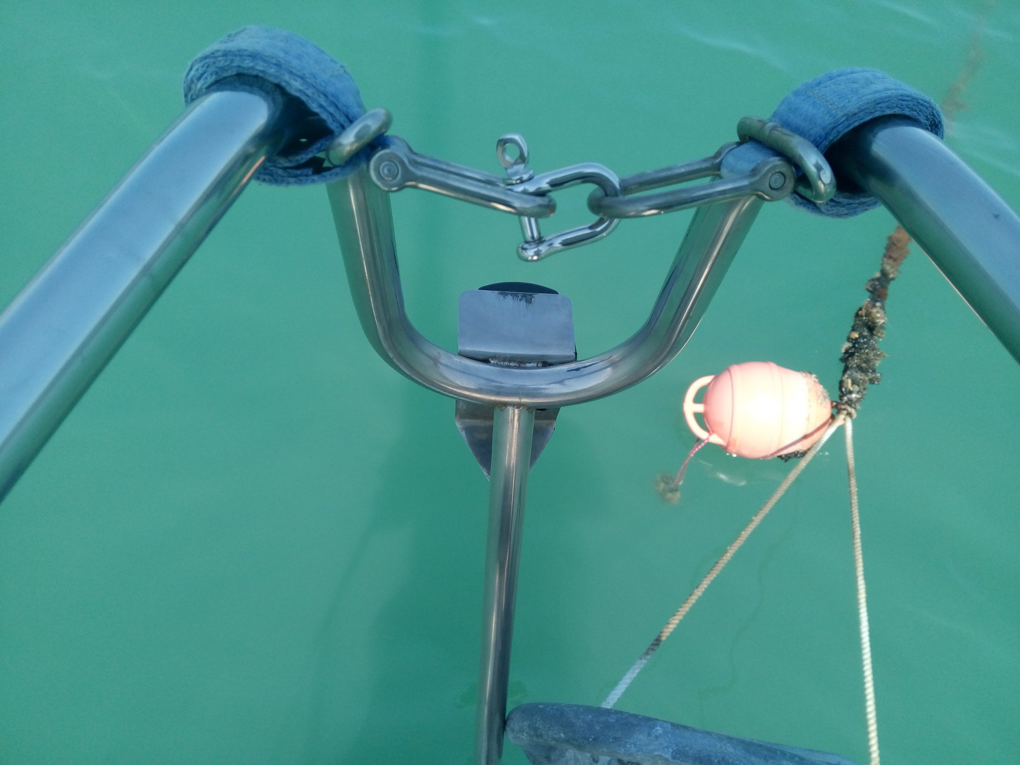

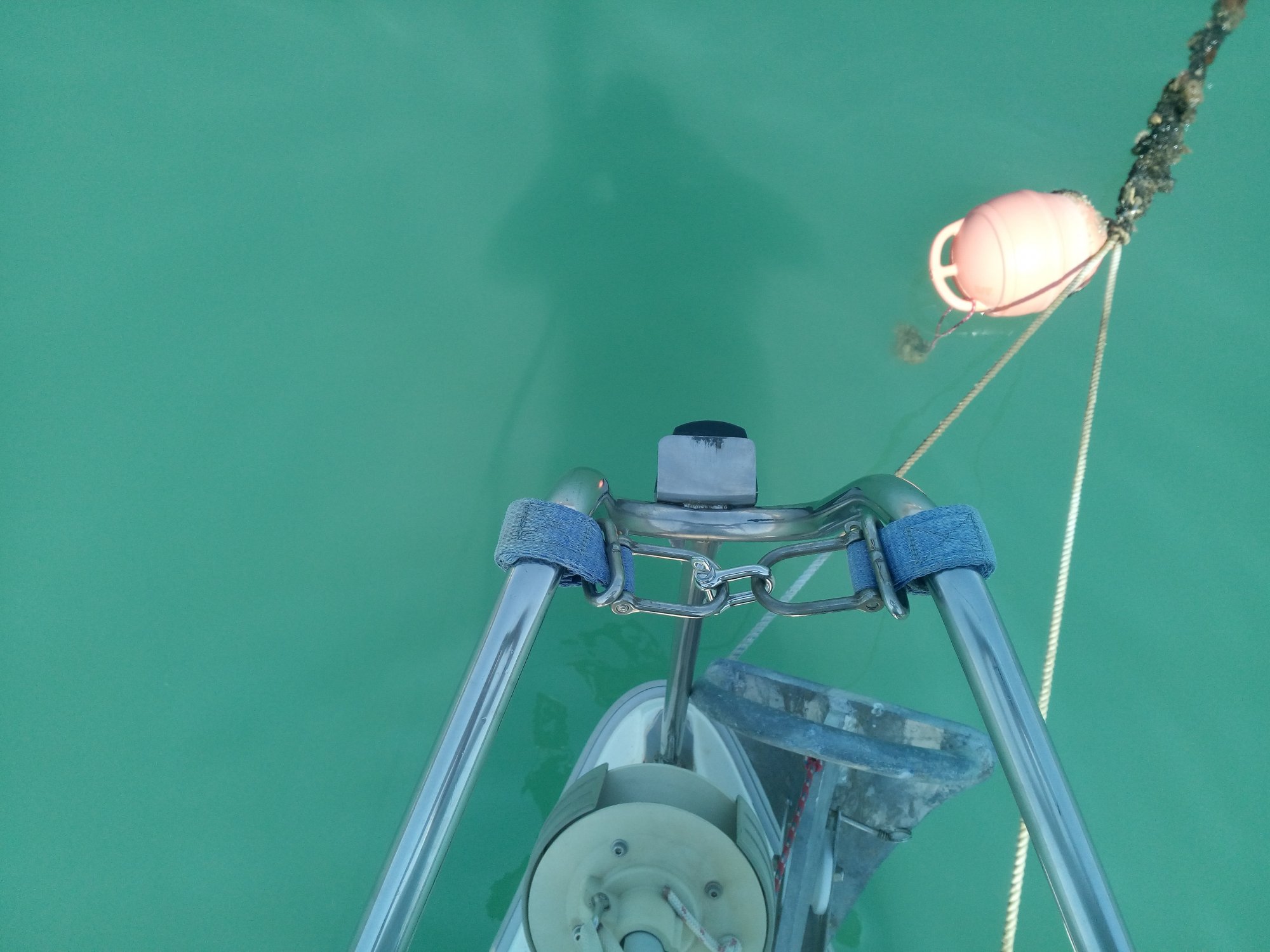

This is what I have at the pulpit. These were fitted with the previous owner, I presuming that they are for Jack Stays or harness attachment but I will appreciate any other thought. The connecting shackle is mine for the sake of the picture.
I was hoping to attach a pulley block to point shown, run the control line through this and back to a block at the mast foot on the port side, add a cheek block to the top of the already two gang deck organiser, and finish in the cockpit.
#jssailem say he doubts the pulpit isn't strong enough but I really can't see any other clear place to fly from other than fitting bowsprit etc, which at this point I don't want to go down this road.
The sail isn't massive , luff 22 feet and the foot is 19 feet and #caverun attaches his on his Hunter 240 pulpit which looks the same as mine.

I'd be surprised if those blue straps were for jacklines as they look like they'd slide backwards. If the chute came with the boat I'd guess they were used as a tack attachment. If you think the pulpit isn't strong enough, you could run a line from what I assume is an unused chain plate attachment just aft of where the forestay is attached. That line would attach to the shackle holding the loops together (maybe you need a slightly larger shackle there) so the load from the asymm would be supported by the chainplate not the pulpit.

Not very far with the angles on the pulpit.
I suppose, if they were down near where the mast rests in the crutch. However, if I wanted jacklines I'd run them along the deck and near the center, to keep me as far from the water as possible given the tether length. But who knows what the PO did.

I agree, boats that I've sailed that had jack stays run unobstructed and flat to the deck. There also another pair attached to the port and stb side rails of the pushpit. Nothing else was on the boat, no webbings or anything else that would resemble attaching to these points. Jack stays was my nearest assumption.
