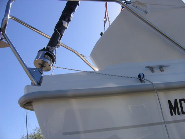

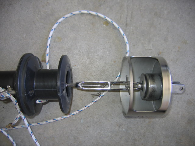

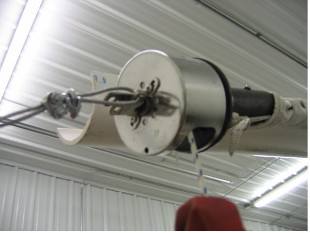

I am getting ready to reinstall my Jib and I noticed that there is nothing holding the bottom of it to the base of the Furler.Anyone know what is used here ??
I have a 2000 270 with a CDI Flexible Furler 2. The manual is @ www.sailcdi.com ,check flex furlers. Mine has 1/4" line with about 3 loops through sail tack to Tack tension pin. (page 2&3 in the manual) good luck
