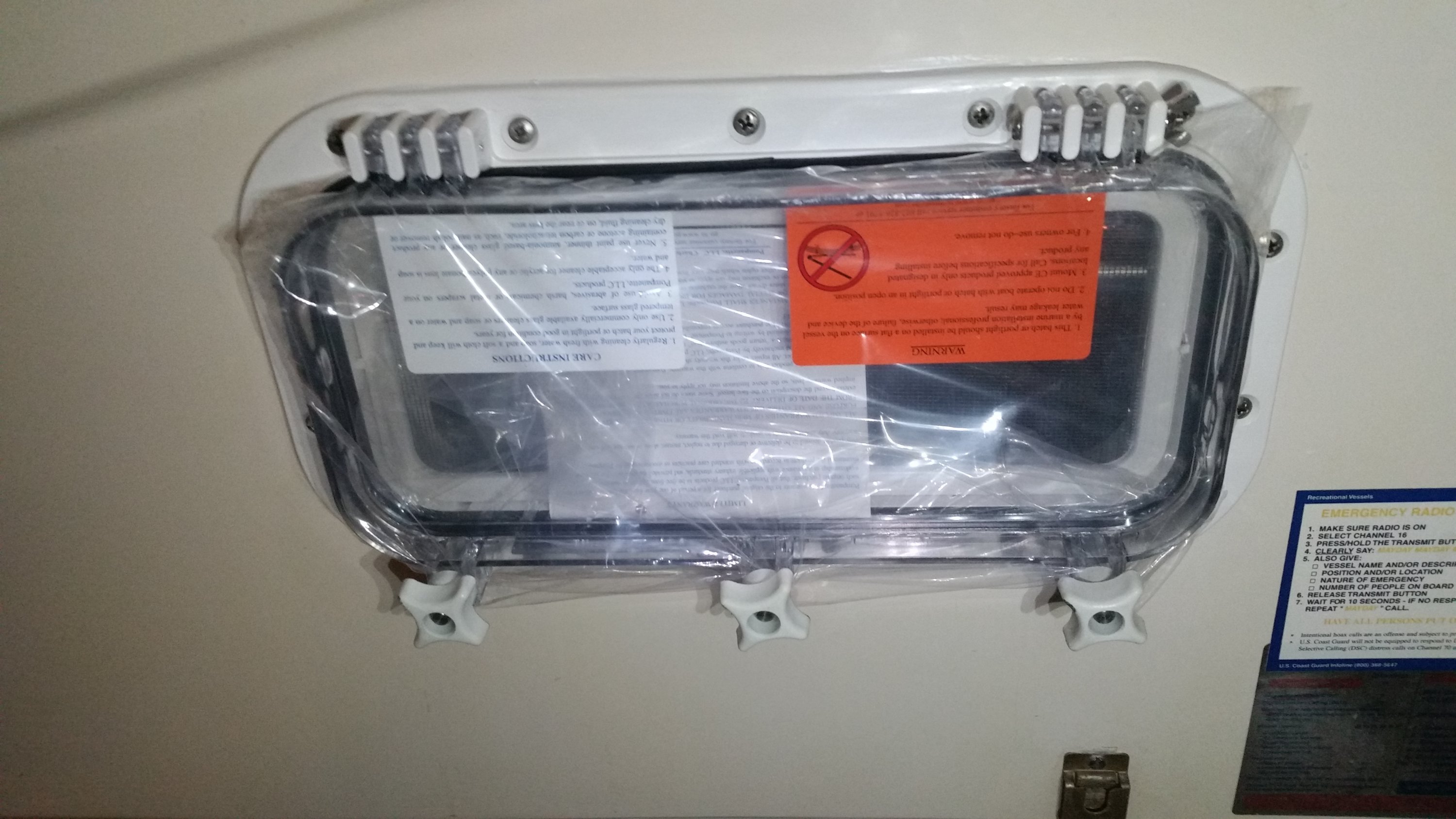

These look like the Hunter standard Bomar Gray Series port-lights now made by Pompanette Mine are the same, but in white.

What do yours look like on the inside? Mine mount from the inside, and the bezel on the outside is strictly decorative to cover the gap in the cabin opening.
Old one being removed.
New one installed from the inside.
10,085
The lens will crack if tightened too much .. Usually, the gasket gets compressed and a tab on the lens bottoms on part of the frame instead of tightening more onto the gasket.. More tightening after bottoming will crack the lens.. The newer Gray ports with the "T" shaped gasket are much better in this regard..
Note that the gap between the port spigot and the cabin should be completely filled/sealed and covered by the bezel so that no water can get into the core and rot it.. No need for sealant on the inside.. a little thin butyl is OK, but not necessary on the inside.
