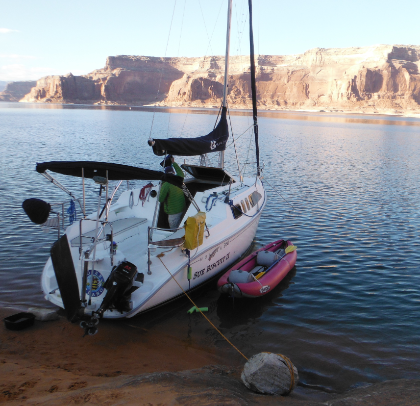

We have a '02 H260 w/a tiller. The feature I really did not consider and now love was the sugar scoop stern. Excellent access to swim off and stern tie (to step onto a beach):

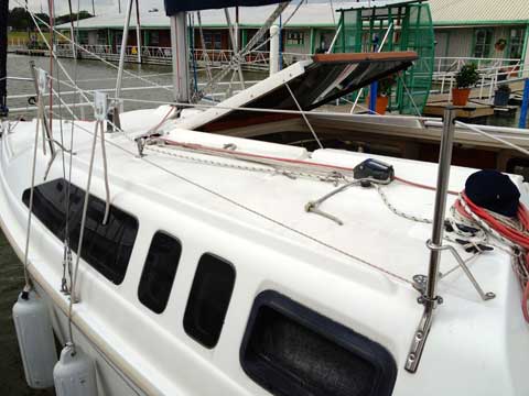

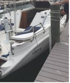

Here's a picture of the newer stanchion- my '98 does not have the bracket that wraps around the base.
Feb 18, 2011
290
Hunter 260 Cave Run Lake, KY

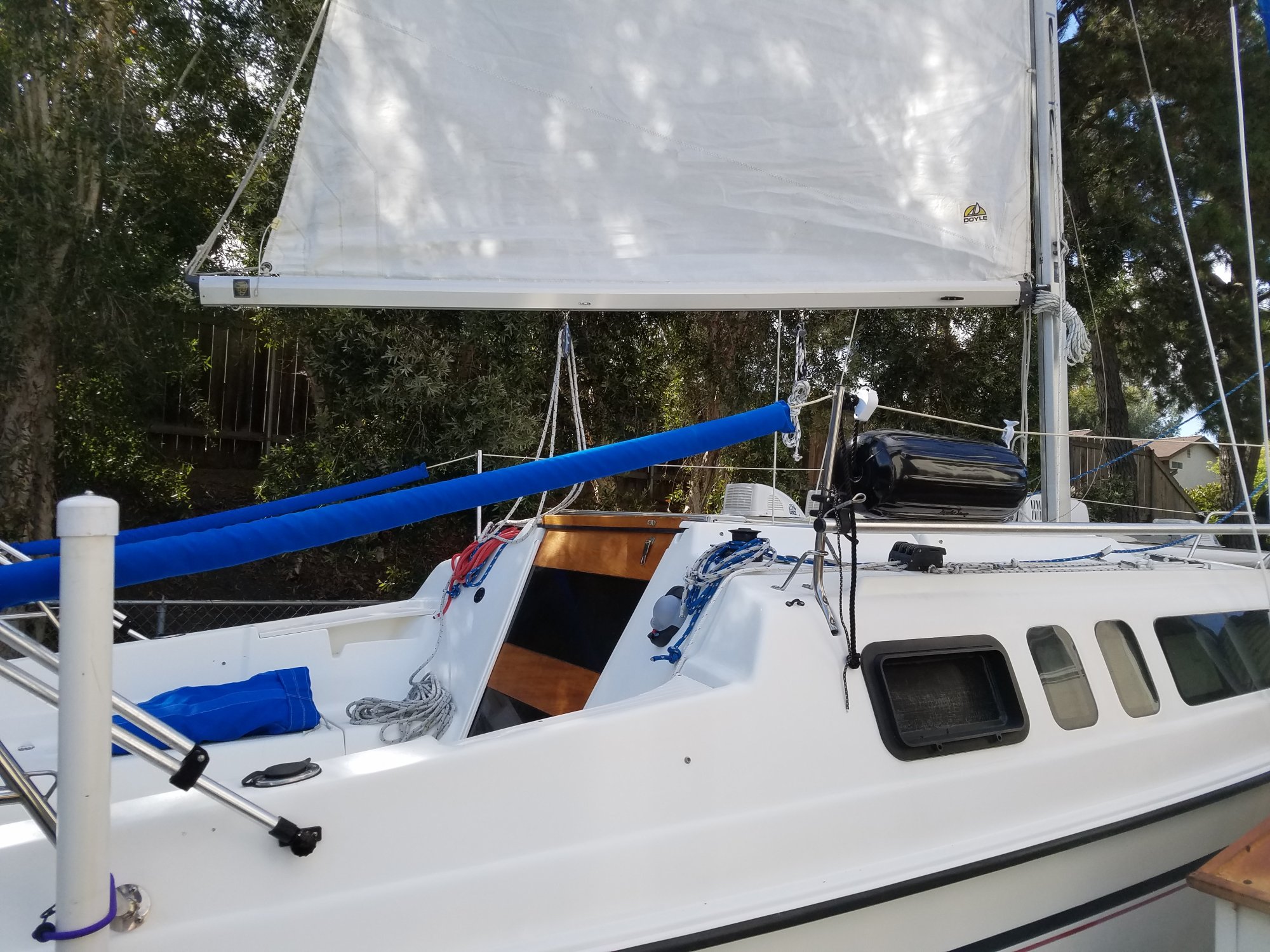

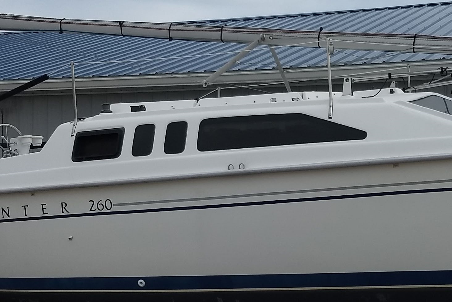

One other thing I noticed when I was looking- they changed the stern rail attachment on the 2 forward supports. The older ones have the supports mounted on the lip of the deck/hull joint. The newer ones have the posts attached on the vertical face of the coaming:
newer:
older, like my '98
Not sure which is preferred, or why the change was made.

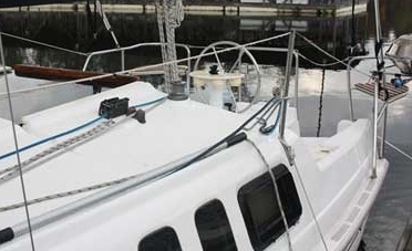

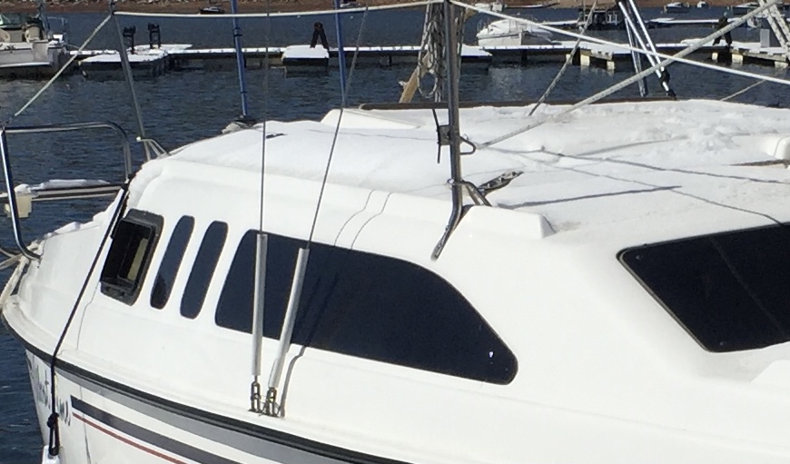

I keep looking at this picture trying to figure out what's different than my 94'.
My 94'
Guess they ran out of the reinforced style stanchions the week they built my boat:biggrin: Maybe it was not a model year change- but varied depending on supplier. Here's my '98 260 without the brackets:
Doug J
May 2, 2005
1,192
Hunter 26 Oceanside, CA
Oh wow! I can't say I've ever seen one like that. But you got wheel steering :dancing:

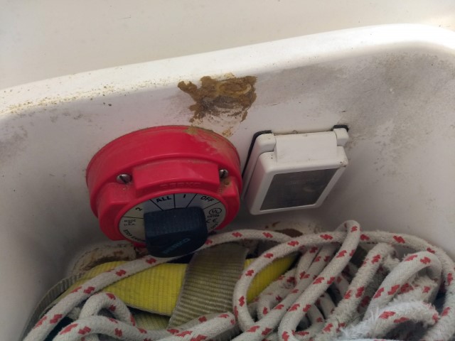

Can you confirm if your boat is one I sold.
Yes, I think it was. Battery selector switch and shore power outlet are on the aft wall of the port cockpit locker- that's how you did it right? And according to the 1998 title I got, the boat was originally sold to someone in Cary, NC.
