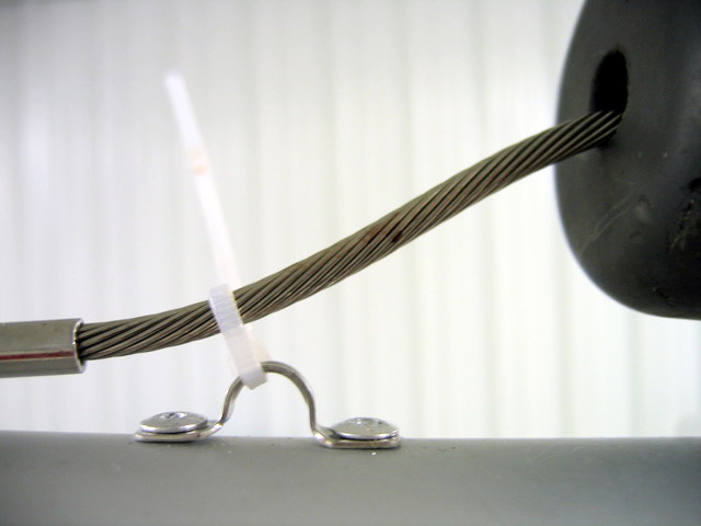

Note: it is tough getting them in and some minor trimming may be required but once you get them in they's stay. However I don't think the plugs are really the best solution. I've had the best luck by installing an eye/cable tie at each hole. In addition, I recently installed a mast hound for the furler and I'll add pictures to the H260 website soon.
More at: http://h260.com/headstay/headstay.html
